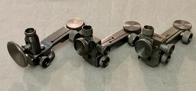

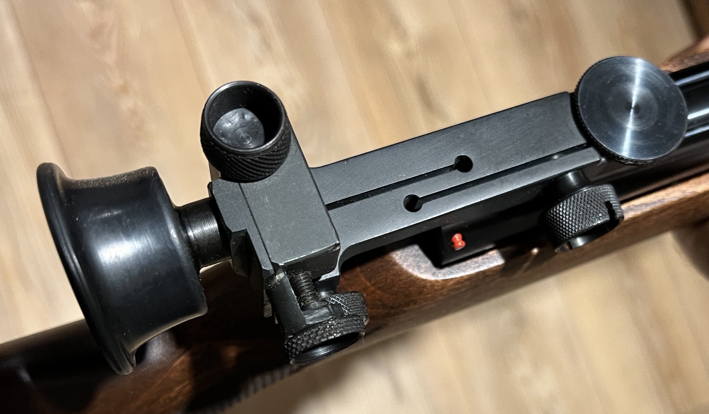

BELOW IS STOLEN FROM A POST I RECENTLY DID ON ANOTHER SITE. YOUR OLD ONE IS THE SAME AS THE ONE IN THE MIDDLE OF THE PHOTO, BUT AS NOTED IS MISSING THE WINDAGE LOCK. PROBABLY MADE 1956-ISH, GIVE OR TAKE.
THESE OLDEST HW UNITS HAVE A DOVETAIL OF ABOUT 12.5MM. THEY DO NOT FIT EITHER THE "13MM" GUNS FROM THE 60'S AND 70'S, OR THE "11MM" ONES MADE SINCE.
These three diopters are from HW 55's. The two on the left are older, and solid milled steel. This "turret" style must have been manufactured in small batches, as there seem to be endless variations in them. The third one on the right is a newer generation introduced about 1959. Points of interest:
1. Huge eye disk with textured anti-glare rear face on this early turret sub-variant.
2. The disk's front flange mates with the turret's flat rear face, to lock the elevation adjustment into place.
3. The only function of the huge thumbwheel underneath is to lock the windage setting (do Germans obsess over wandering settings?)
4. This later turret model has the top thumbwheel, which mates with the positioning holes in the rifle's receiver, recessed to fit flush with the base. The whole rear section is also dropped down a bit.
5. The revised design has changed to a more elaborate cast-metal adjuster module.
6. But the base is still solid steel. As far as I can tell, the small tapered radius down the top edges is purely for aesthetic purposes.
This variant has no windage markings and no elevation indicator window. There must be a lot of different variants.

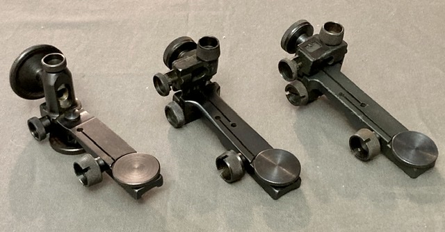

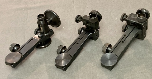

HW match sights do indeed have a lot of variations! They fall into three basic generations:
The oldest ones (left in the photos below) are all steel. The elevation adjustment is in a narrow rounded "turret," and the windage is built into the base. These were used up until about 1959.
The next ones (middle in photos) used a compact casting to house both adjusters. The base is still nicely detailed forged steel. Those were used for just a few years.
The most common and familiar ones (right in photos) are similar in appearance to the second generation, but are made entirely of castings, and look a bit bigger and more "squared up." They were made from the mid 60's until recent years.
Sights are typically made in small batches by subcontractors. Within each of these generations are many minor sub-variants (especially those oldest ones). I could bore you for hours, LOL...

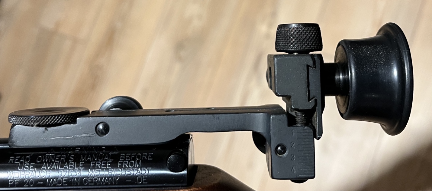

Went back to 20 yards to see how it was. Wonderful being able to shoot with my glasses on and see both the sight and the target. First 4 shots were high right. Sight hadn't moved but discovered that the windage, elevation, and gib screw were all loose. Assuming I just need to tighten a little more than I did the first time? I don’t want to use Loctite because those screws have to be loosened to adjust the sight.
You might try some of the Loctite 222MS™, purple, ie low strength which is listed for eyeglasses, small electronics, laptops, ect, and hand tool removeable. I use it on pins in wristwatch bracelets, and have always have had loctited pins easy to remove. It might help remove any slop in threads on the sight if an is present. I would still use sparingly only on a portion of threads.
