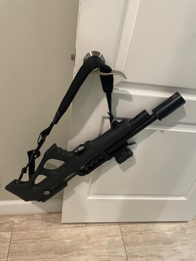

Nice rig...how's the donny work? I bet the tatsu would save you even more weight
probably would save a little weight but I like the cool factor too lol, and it might be an inch or so shorter. Another thing about the fat boy it comes with 4 adaptors/inserts for .177, .22, .25, and .30 so you can swap it to other guns if you like/need too.
