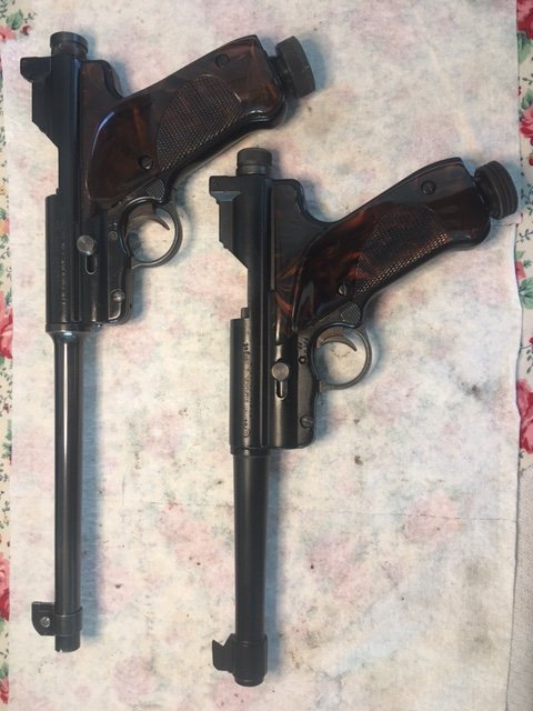

I've fiddled with these a bit.
Here are two Mark 1's.
One is stock, the other has a steel barrel shroud and an extended barrel.
Powdercoat would be super tough.
However, I will just use epoxy paint if I ever re-do these ... tough enough and easy to touch up (my guns always seem to pick up little nicks over time).
Any small parts you can replace with steel is money well spent (bolt, bolt handle, trigger, etc.).
I have powdercoated a few of my Mk1 and it worked out very well. I use a satin black or a gloss black, depending on my mood at the time, they are both good. I thought about painting them other colours, but decided the guns are too nice to tart them up. Us paint stripper to clean the original coating off, then steel wool, wipe well with alcohol, wear gloves so you don't get skin oil on the casting. It takes me a couple of hours start to finish.
