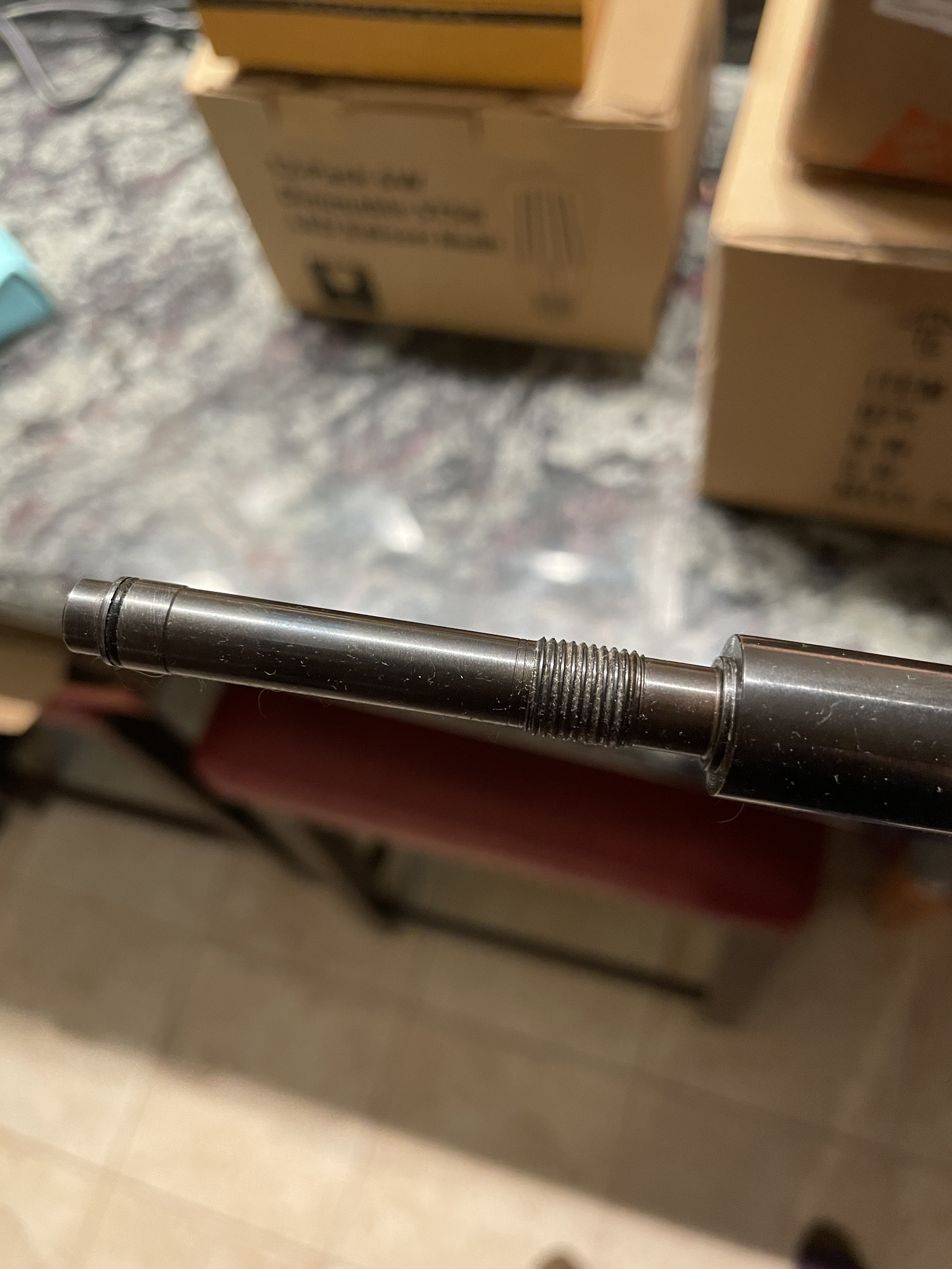

I was able to remove the barrel using a vice. Good news is that it came off without too much trouble. Bad news is that there is no breach seal in the barrel. The breach end of the barrel slides into another housing inside the receiver. I suspect the breach seal is in that housing. I haven't been able to figure out how to access this housing. I also noticed that my transfer port seal is bad. The o-ring is torn. Who knows, I may have caused it when removing the air cylinder. 🤷‍♂️ The cutout for the transfer port o-ring is square but the o-ring I pulled out is round. The replacement o-ring I found online somewhere does show a round o-ring so IDK. I can tell my 44's been worked on cuz the seal around the pressure gauge is broken so maybe someone replaced the xfer port seal at some point too and just used what they had.
So, I'm wondering if Weihrauch uses "standard" o-rings or if some of them are custom.
Received my seal kit from ebay, thanks for the link @kendive !! The transfer port has a square-ish cutout for the o-ring. The replacement o-ring in the kit is indeed round but by using the silicon lube that's included in the kit it wasn't too much trouble getting the o-ring to conform to the cutout.
I still haven't figured out how to access the breach seal o-ring.

I re-assembled the pistol and did some chrony testing. Per a previous post I misquoted by saying I was getting 720fps with an 8.4gn pellet. It was actually a 7.33gn pellet.
After replacing the xfer port o-ring I'm now getting 840fps with the 7.33gn pellet. An increase of 120fps!!
This might be more inline with what to expect from the HW44. Anyone have some chrony #'s they can share with their .177 to compare??
I did the tissue test and I don't detect any air escaping. If my chrony #'s are normal then I guess my breach seal must be OK.
