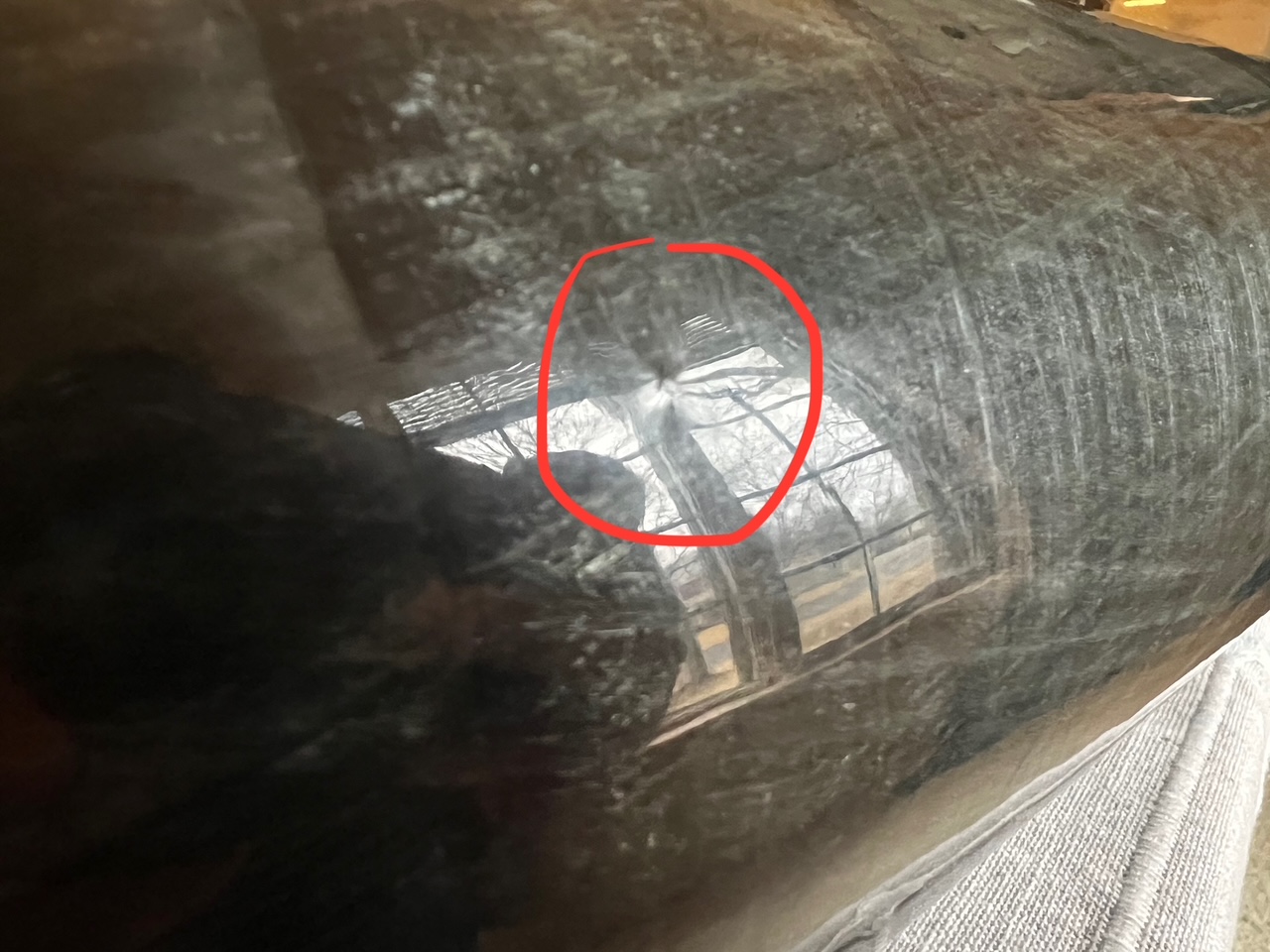

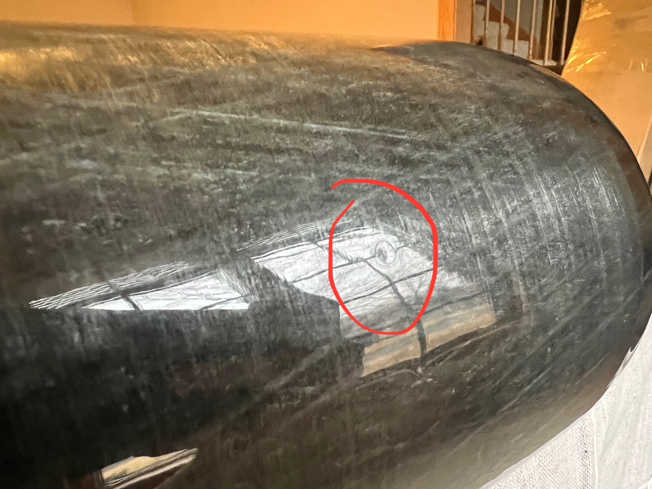

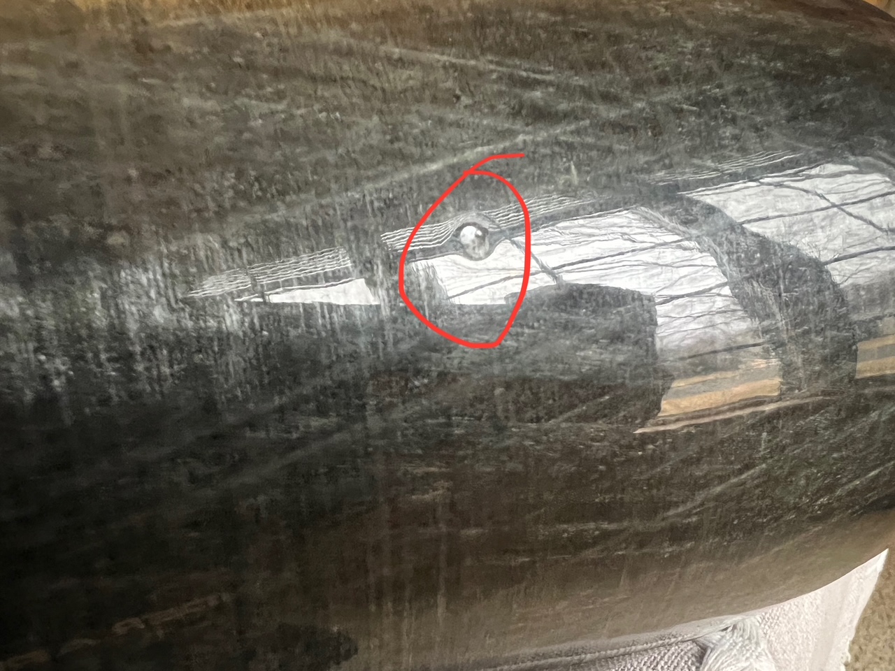

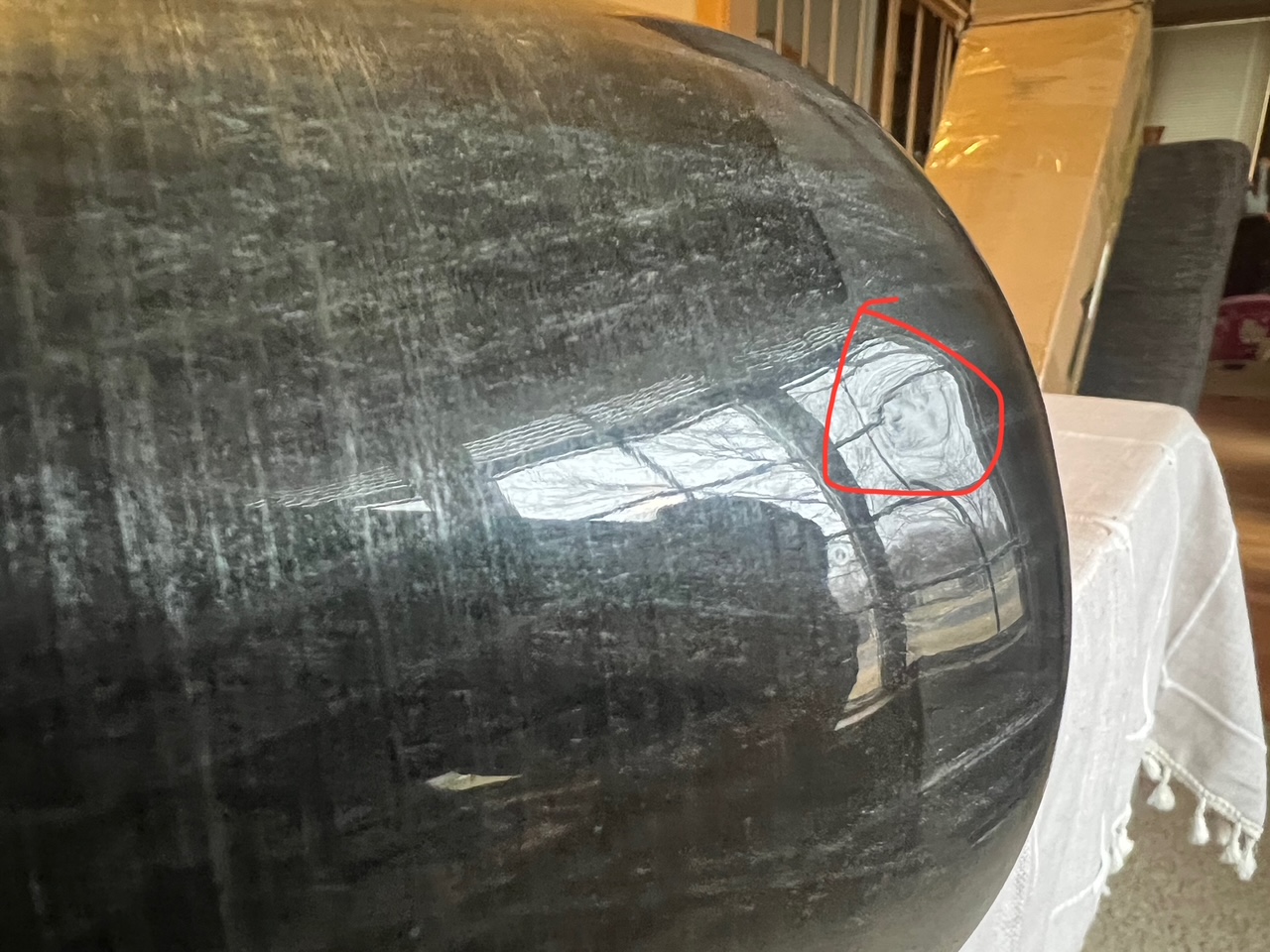

So I just received a new Tuxing 6.8L carbon fiber tank. Packaging was poor. Literally was in a bag to protect it from dust and was packaged in a box. Would you still use this? So far no actual cracking on the clear coat or carbon fiber. The dents are hard to spot and you'll only see them when reflecting a light on them. Seems ok but would like to know your opinion.
Looks to me too it's the way the resin set rather than damage dents but hard to really tell from pics. Damage from bangs to the tanks usually look different. Are any cracks in the resin radiating from what you're calling dents? If not, I wouldn't be too concerned.
i'm just seeing it on a large screen, it definitely looks like contact points where they rested it during curing. Not damage.
No cracks or anything. I agree, looks like epoxy/resin bubbles. Again, they're very hard to see unless you're really looking for them under a light.
Thanks. That's what I was thinking. I'll fill her up and inspect it every 5-10 minutes.
pay close attention WHILE filling. sound is usually your first sign to abort and bleed or GTFO of dodge.
