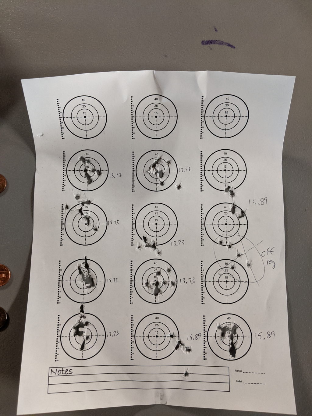

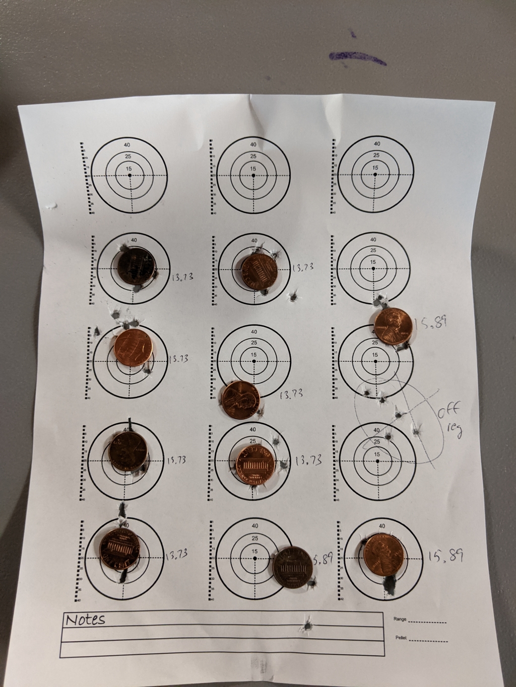

Your results are showing the same behaviors a mine where you have a most of the group in one place with one or two more groups around the main one. I have just shot pellets thorugh mine for the idea of breaking the gun for the first 250-300 pellets, so I didin't pay much attention either I didnt have the place to shoot from a bench. Then I started to do more shooting and I got better groups until I removed the moderator and the Stripper came with it. I have just reinstalled everything and havent had time to do any shooting (due to weather) or cleaning. I am hoping on doing that this week. I do like the gun and the feeling. I now have to get it to a clean place and well adjusted. As you said my reg pressure is going to stay at the same place until I get the Externally adjustable reg.

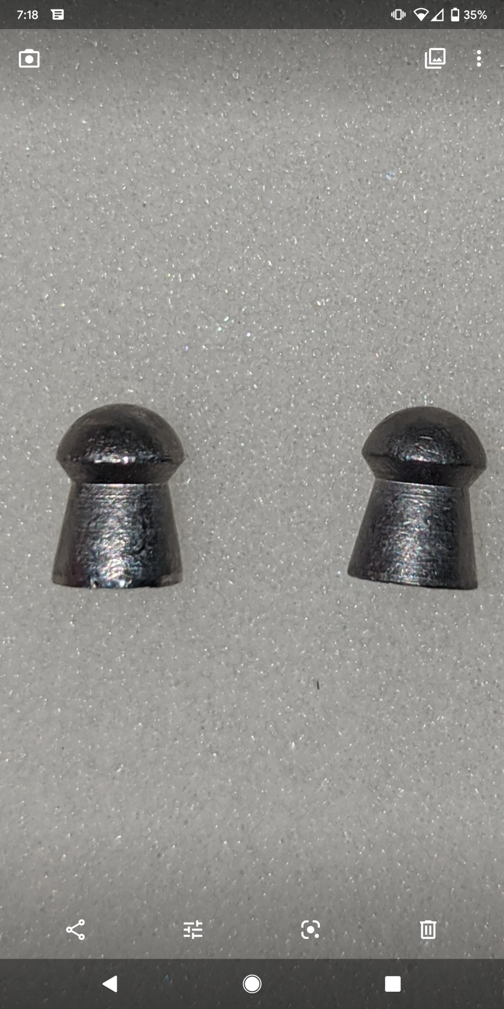

Oh, put five over the chrono first and they were all within just a few fps of 870, still haven't messed with hammer spring. So it's shooting just a little faster today than it was the other day-might be cuz its not so bitter cold tonight (reg sensitive to temps?). Only shot the 15.89gr this session.
