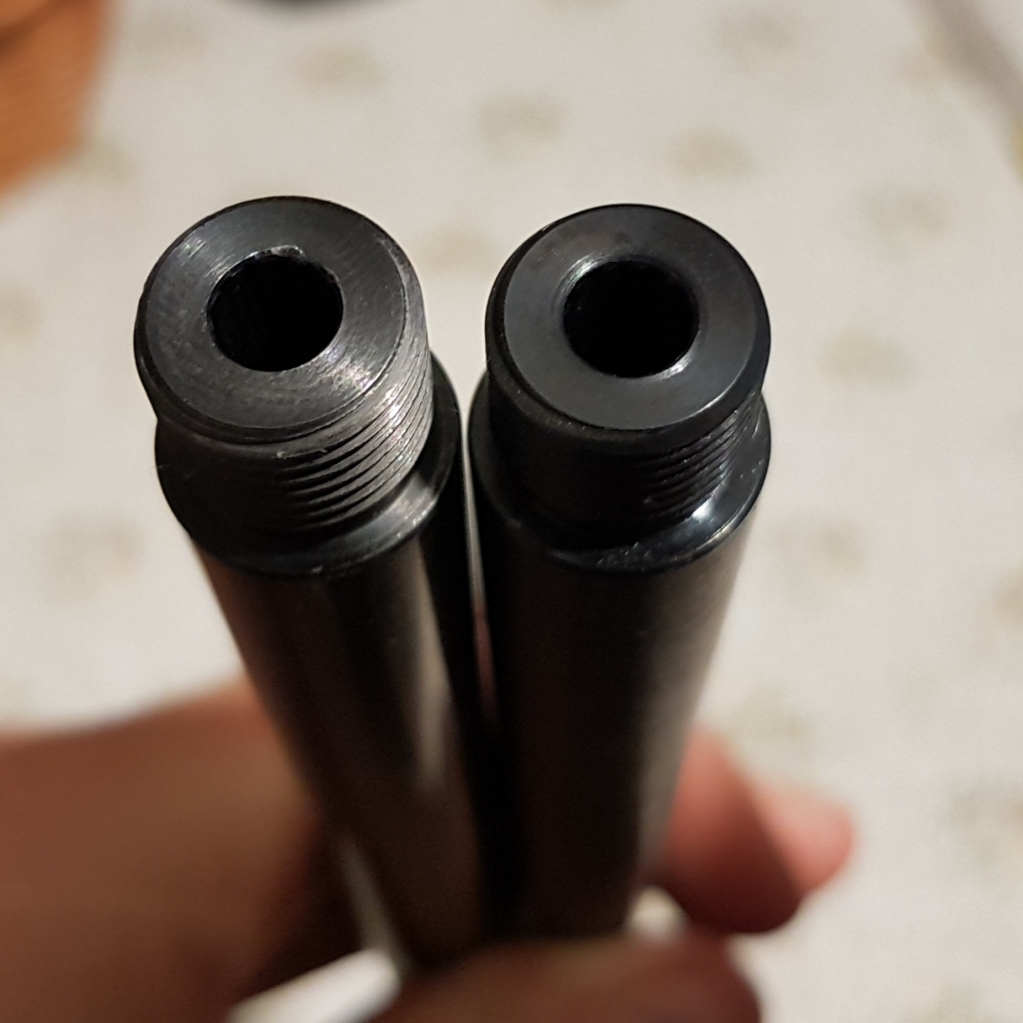

They sent me a new piece of the barrel but one of the barrels I have to return! I made a couple of pictures for comparison.

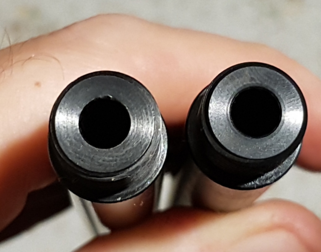

Here are both barrels on the left is slightly damaged crown on right side is "new"
Which one do you prefer???

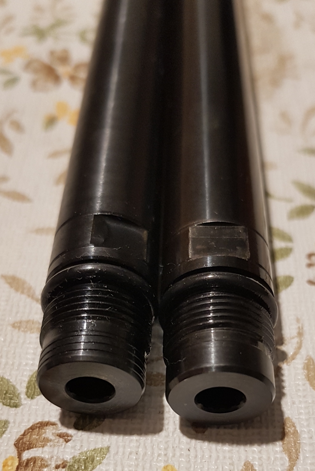

Here is the picture of back threading and pellets side - There is also small difference. Also barrel finish-surface is different. Old one on right side has smoother glossy surface. New one has different surface not so glossy - reason why?

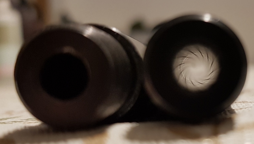

Here are pictures of inside twist of barrels. On the left side is old one and on right is "new" barrel.
Just question what does mean the circle inside the "new" barrel? Something in choke of barrel? Why is it not on old barrel too? :)

I believe the dimples ( 3 of them) were present on the top of old Taipan Mutant CZ barrels, but are not on the Taipan Veteran CZ barrels. They looked like places where a grub screw would secure the barrel. I don't remember the source, but heard it said that the twist ratio of the CZ is 1:16 and LW is 1:17. I don't know for sure and you can't believe everything you read on the internet anyway so take that with a grain of salt.
