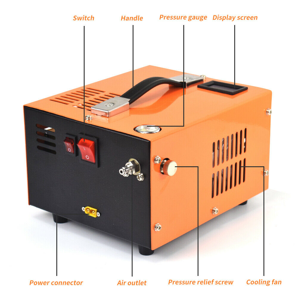

Recognize this unbranded PCP compressor sold under a brand name? Reliability?
Found this Chinese unbranded PCP air compressor sold online at several places. Are these sold under any brand name? What is the reliability, etc?

pretty sure it originates as a ' Tuxing ' and similar designs or clones are marketed all the way up to major manufacturers .. i wouldnt pay more than 300 or so for one, and from what ive seen reliability is on a par with a yong heng .. that type of compressor is geared more towards filling a gun directly and its portable for in-field use off a battery, vs a yong heng type which is geared more towards actually filling a bottle and isnt very portable ... so choose your type bsed on your use .. im sure it will work pretty good for quite awhile with casual use ...

Those are rebranded under just about everyone's name. They are the wonderful waterless, oilless disposable compressors that need a rebuild in about 20 hours or so. They are good for those who need only to fill their guns occasionally or really need the 12V option. They don't have a good track record of even making it to the twenty hour mark from what I have read. I would expect the main reason for that would be because people push them to hard.
They are nothing like the Yong Heng that is both water cooled, has a crankcase full of oil and with a little tinkering will last for years of use and abuse.

Looking at this orange version theres no provision for lubrication and not sure it has the second internal moisture filter like the Nomad/Tuxing have.
I would stay away from it for that reason,they need the lubrication and flushing routine at 20 fills that i dont think this one provides.

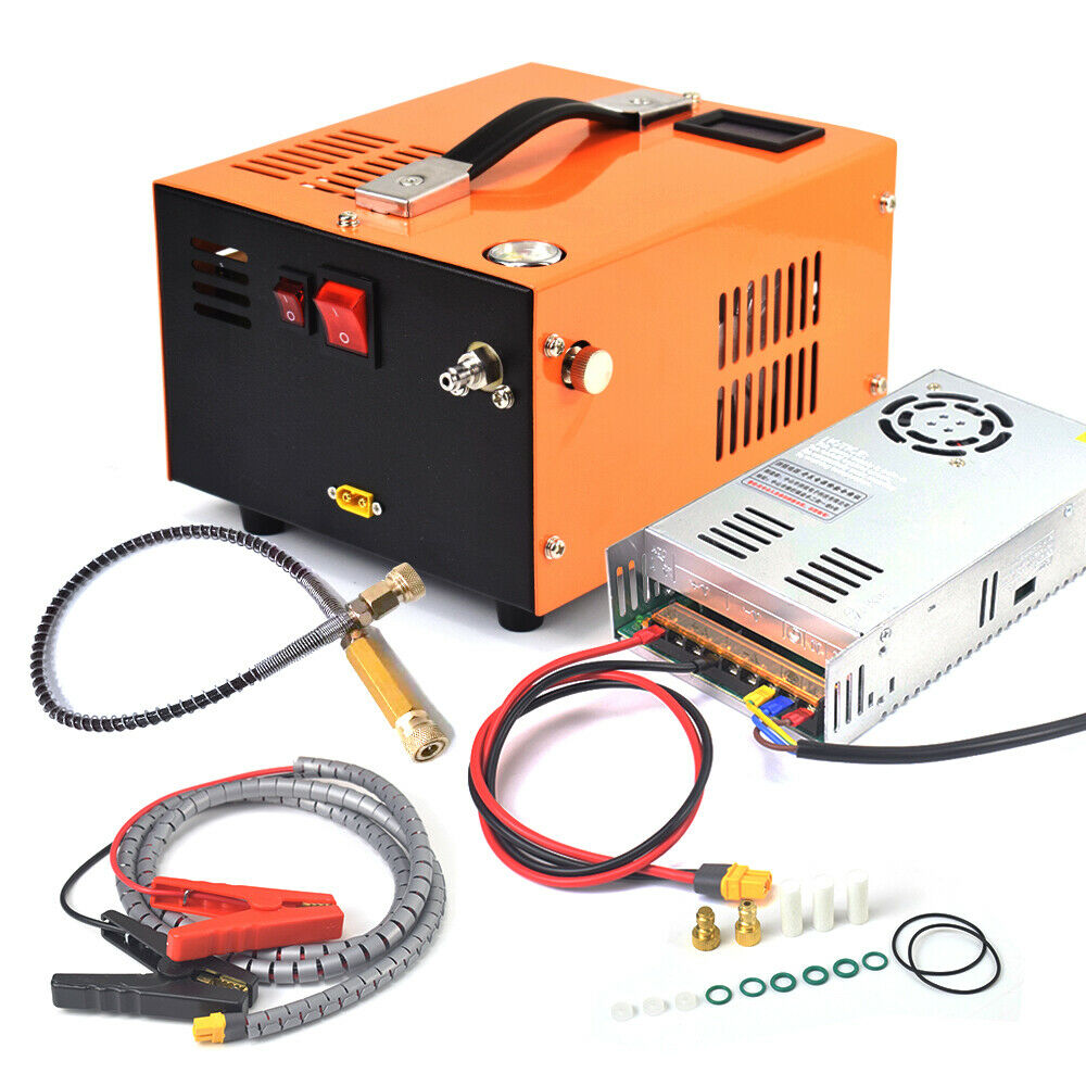

Good info on the lubrication. Already bought it, but will investigate if there is a way to lubricate it. Was just reading up on this about Nomad you mentioned and the manual talks about a numerical LOAD display to monitor that alerts if you need to add more oil. It talks about -what I assume- increased friction that is causing an increase in load amperage (below 28 => OK above 29 : => shut-off).
Mine is on the way, but wondering where I can get enough power without tripping my circuit-breaker in my home? Looking at my electric breaker panel, all my 110V breakers are 15Amp and 20Amp. Only the 2-phase 220V breakers for the larger appliances have more than the 25-30 Amp that the compressors supposed to be pulling. What am I missing?
Should I run the included 220/110V to 12V transformer at 220V? Or, the 25 Amp current usage is at 12V only, and at 110V it would be between 2 to 3 Amps?
EDIT: looks like the 25-30 Amps usage is with the 12V AC to DC inverter. So with an 80% efficiency from AC to DC it will use around 2.3 Amps at 120V
