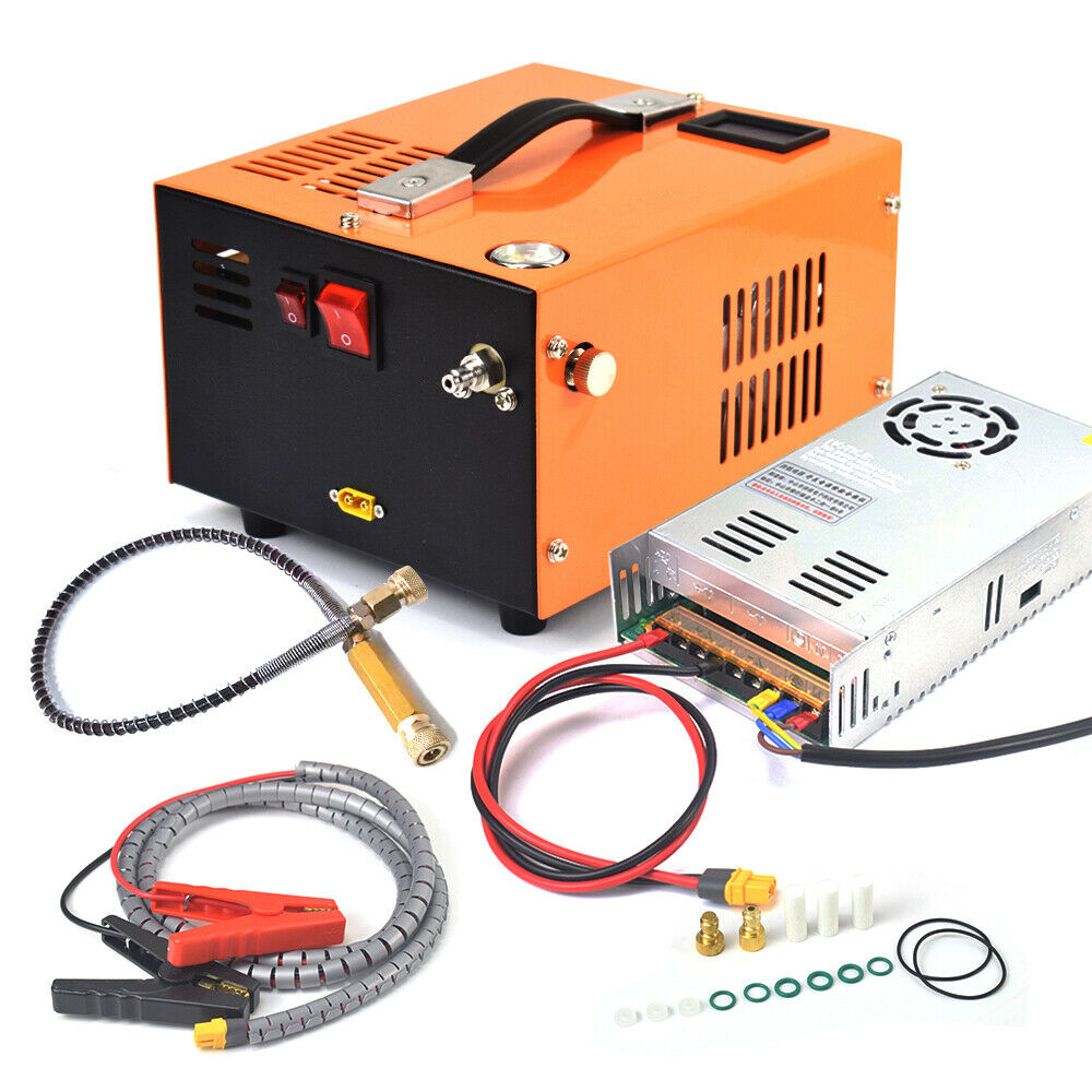

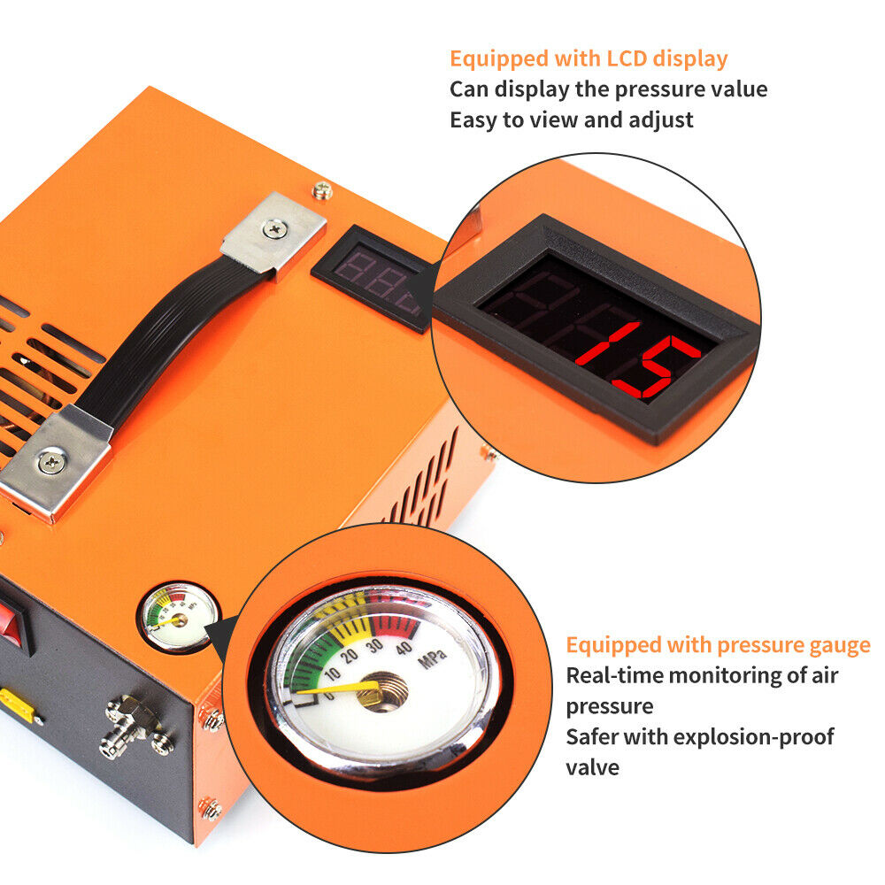

Recognize this unbranded PCP compressor sold under a brand name? Reliability?
My $215 compressor, just like the RL-mini and similar to the Nomad !!, is being shipped. Was mentioned earlier about adding a few drops of silicone oil (about 30 weight) after every few runs and then do a silicone oil flush of sort every 10-15 runs. If this no-name compressor does not have that special port where you can drop the silicone oil inside while running, what about a few drops silicone oil inside the air intake? From my HVAC days I remember adding refrigerant oil along with the freon from a vacuum.
Found this Chinese unbranded PCP air compressor sold online at several places. Are these sold under any brand name? What is the reliability, etc?
-air-cooled, no oil
-0.6L or less
- 30 mins max. run time

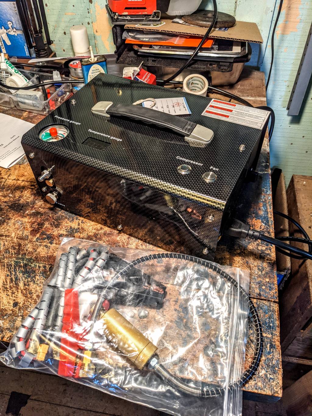

Well the compressor from Vevor arrived, and I used it for the first time to fill my Avenger. While I didn't think to time it, it only took a few minutes to go from 1000psi to 3800 psi, which is where I set it. When it turned off, the temperature read 27c. This device has one hell of a fan. After I was done, and opened the relief valve, I started the compressor again for about 20 seconds to purge any moisture.
It came well packed and had the useless instructions, but overall it looks and operates great. They charged me $279.95 including shipping, and no tax. The listed price on the Vevor website is about $100.00 less than on ebay. If it lasts, this is a hell of a value.
Mine came in pho carbon fiber, looks classy.

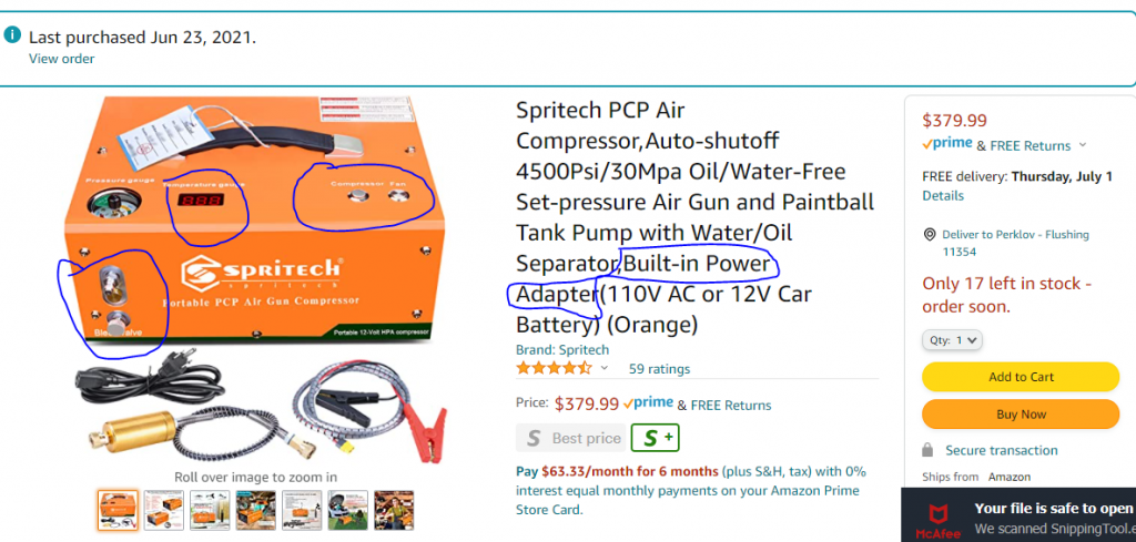

Look at this one I bought on Amazon yesterday for $379. It is more expensive then the one you're showing here due to the features I've circled in blue. It seems to be a great compressor for the price/reviews. and they are sold fast. Talon Tunes sells this exact compressor for $429 btw and he has a YouTube review video too. Check it out.

The one I purchased for $279.95 has all the same features. It's identical except for the color.
They are all the the same, the only difference are the names and colors. In the automobile industry this is referred to as "badge engineering," where they sell the same car under different names while only changing the trim. There may be one difference, warranty. You may pay more to have Ebay or Amazon behind the product. In this case the difference is a minimum of $100.00.

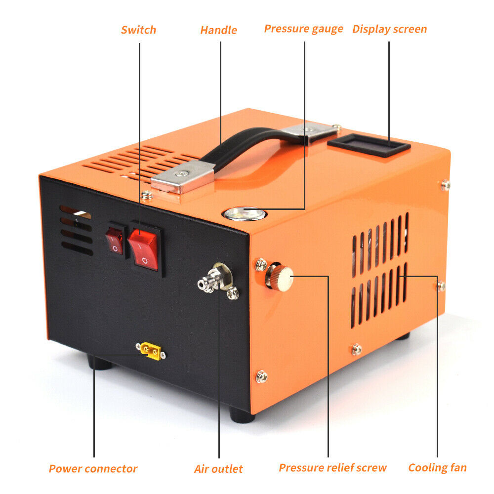

There are 2 differences between these and some of the higher priced models like the Nomad ll, a water trap with a drain under the cabinet, and possibly more important a port to inject silicon oil at the compressor inlet. I think the oil port could be added later, but not having opened it up, I can't say for sure.
If it makes it through the 1 year warranty period, I will add the oil port, and an hour meter.
All these compressors come with a minimal external dryer. If I upgraded to a larger dryer, that should eliminate any advantage of the Nomad ll drain port.
