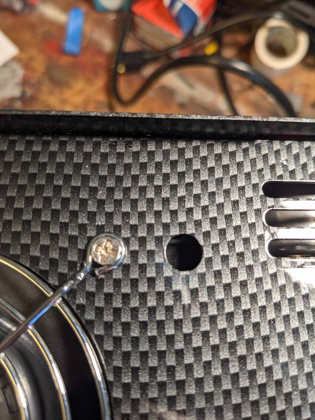

It appears that there is already a hole for the fitting next to the fan cover on my compressor.
You are welcome.
I think this will be tomorrow's project to measure the inlet port to the compressor, and hopefully be able to find some tubing at my local Ace Hardware. This simple mod could be the difference between an early failure and a compressor that keeps on running. The fact that the hole is already there proves that the manufacture is setup to install whatever options.the importers want.
This mod should cost about $1.00 for a ft of tubing.
Ok this is easier than I thought.

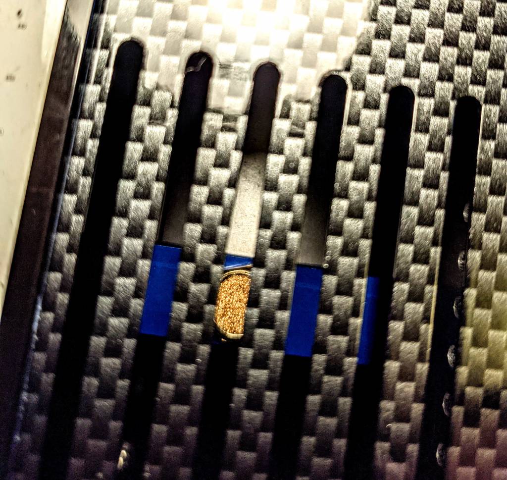

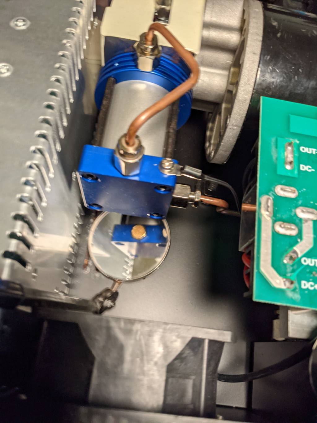

I took the cover off and found that the inlet to the compressor is a copper mesh screw in filter. See the photo where I used an inspection mirror. With the compressor completely assembled, the filter mesh is 1.4 inches below the vent slots underneath the cabinet.
To occasionally inject oil, all you need is a precision bottle oiler, which can be purchased from Amazon for $6.00 a pair. The needle is 1.5 inches long. Perfect!
I cannot see why you couldn't run the compressor upside down with the vent open, while dribbling a few drops of silicon oil on top of the filter mesh. The oil will go directly into the compressor. I suppose you could occasionally remove the filter, and wash it in solvent to keep it from clogging.
https://www.amazon.com/bottles-stainless-needle-your-Oils/dp/B076YZY5ZK/ref=sr_1_4?crid=2GEQN8JZ3WFCH&dchild=1&keywords=oiler+bottle&qid=1624654928&sprefix=Oiler+%2Caps%2C217&sr=8-4
What about running a tube to the filter and let the few drops of oil being sucked in through the filter? Pump temperature should not be that high (60-80C max) to melt the tube. Or if there is no way to secure the tube around the filter to the pump, then remove the filter and run the tube into the hole with a sleeve outside the opening holding it flush, and place a similar material filter inline/inside the tube.
I considered that, but while it's still under warranty, I decided to leave it the way it is. After the 1-year expires, I may consider moving the filter to the bottom of the cabinet, screwing in a metric barb fitting into the compressor head, and connecting them with a short hose. On the other hand, it's so easy to get to the inlet through the slots in the cabinet, I may just leave it alone until I need to remove the compressor for repairs.
Having found its just so easy to get to the mesh filter, it's hard to justify making any changes.

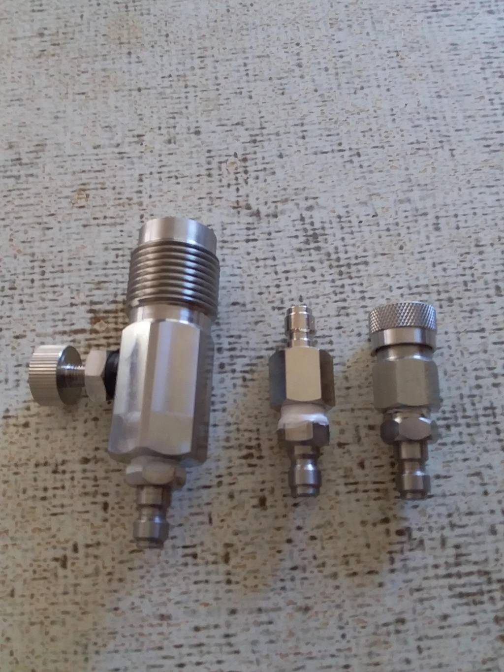

Open the bleed and close the tank valve at the same time or add a check valve between the fill hose and tank valve. For example.
Thank you Eaglebeak. I don't trust the Aliexpress or Ebay check valves but I see that Pyramid Air is selling them for $15. I need to make sure the check valve blocks the flow from the direction of the air tank so the pump can overcome it.
Mine are from AliExpress. They are stainless steel of good quality and are only a couple of bucks each. The flow direction for this type of fitting is always from the male foster side to the thread side. The Male to male fitting can be flipped to flow in what direction you desire. I use the DIn 300 type to attach to my 6.8 L bottles and the M-M at the pump outlet. With this setup, I can interrupt the filling process at any time without losing pressure in the filter and line. I've found these cheap fittings to be very effective and reliable.
Thanks for the tips. I will relook at the AliExpress option. I had a bad experience about 10 years ago when I was new in PCP. A filling hose I bought on Ebay blew up on me at about 1500 psi. Sounded like a shot. I promised myself not to skimp on HPA fittings and hoses again.
