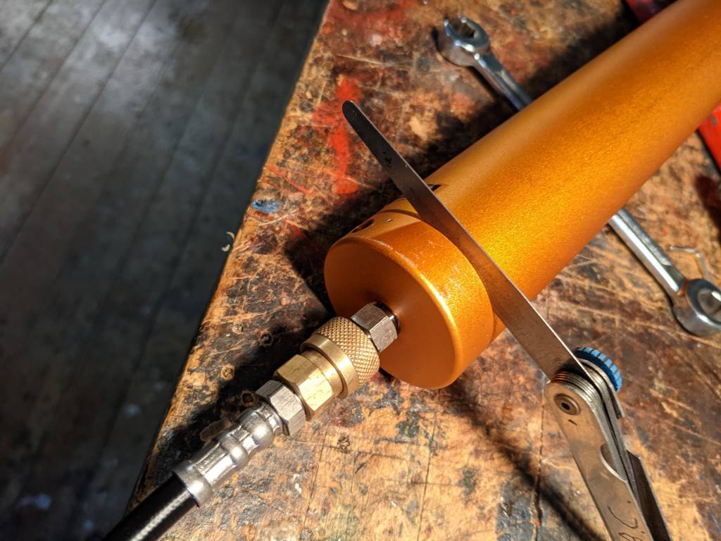

I just last week had a chinese hose explode at 3500psi while hand pumping my Avenger. Sounded like a hand grenade and put 14 stitches in my thigh. My hearing is still slightly muffled from the blast. I don't know for sure what failed first, but I suspect the female brass QD fitting. Do most of you use brass foster fittings? Should I try to find a hose with a steel foster fitting instead?

Yes I was lucky. I was in the middle of the downstroke when instantly the pump was no longer in my hands, I couldn't hear and knew something had hit the inside back of my thigh. I couldn't tell how badly I was injured, but slapped a sterile bandage on it and wrapped it in a bath towel I picked up off the floor. Sorry for the graphics.
Holy Moses! this s***t is no joke. I'm sorry that this had happened to you dholder, thanks for sharing. This looks like the exact same generic hose that came with my Spritech orange compressor. Funny thing is, I actually started a thread here a couple of weeks ago asking for an extra long hose recommendation as I just did not trust this one. Now I'm definitely placing an order for the "No Kink Flexible Hose - 5000psi" for $60 from AOA. As others here already mentioned, sometimes the extra buck is worth the piece of mind. Be well.
