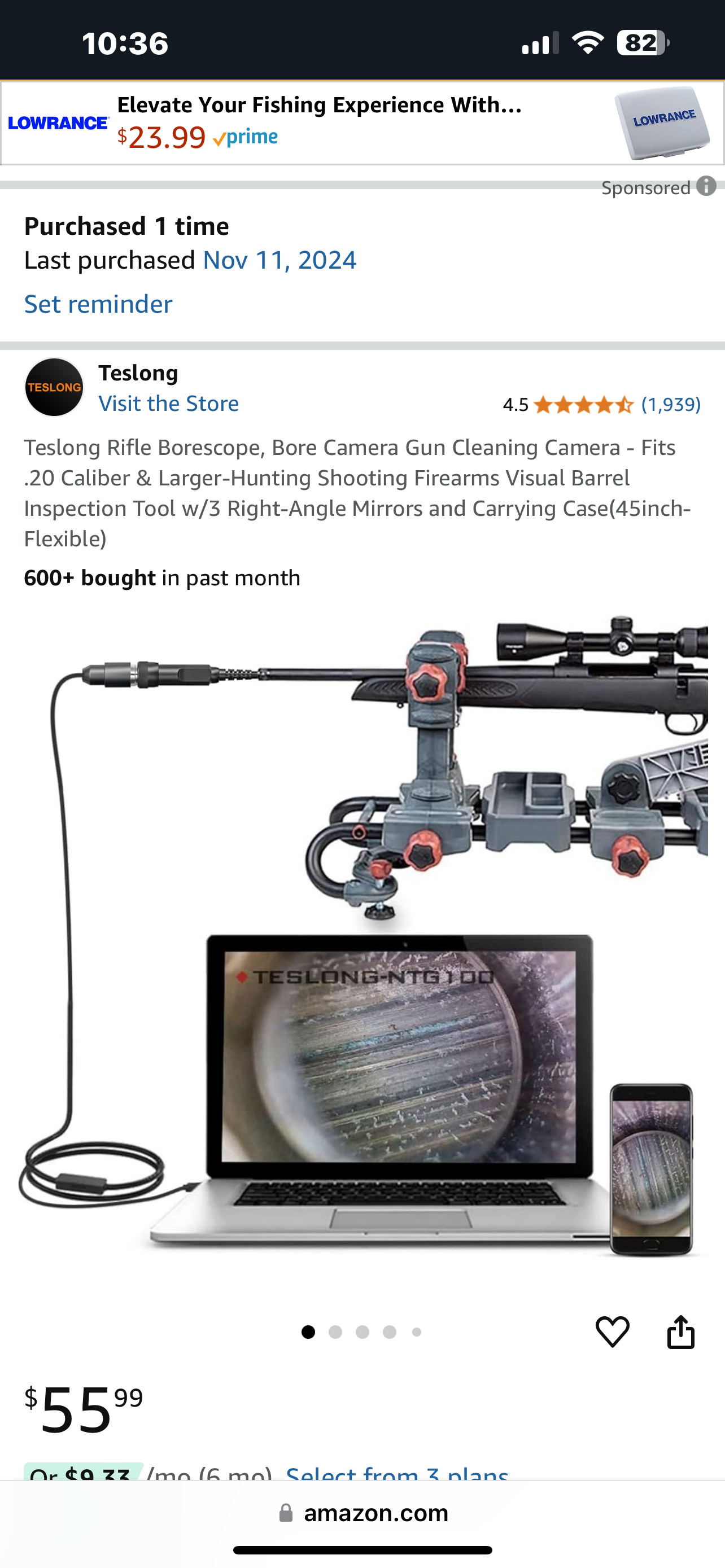

I hope I don't sound too dumb here. Like the others mentioned, when accuracy changes and I haven't changed anything about or within the gun or ammo it makes me want to examine my bore or clean my barrel. A bore scope would make excessive leading very recognizable. When I see what appears to be caked up lead streaks with heavy flaking layers, my bore is leaded enough for me. Somewhat even, but heavy distribution of leading prompts me to clean. If leading looks heavier in a spot or two then I need to clean and investigate the area(s) for burs or tight spots in the barrel that may need some attention. I mostly use this approach in big bores where I shoot a lot of slugs.

Can you recommend one?
I have this one.
