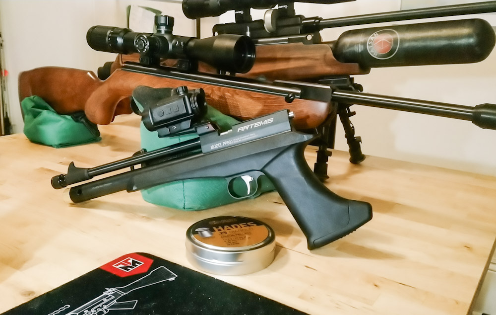

I'd recommend the pp800. I can get parts for them. Kral seems to not supply spares, or they're very hard to get.

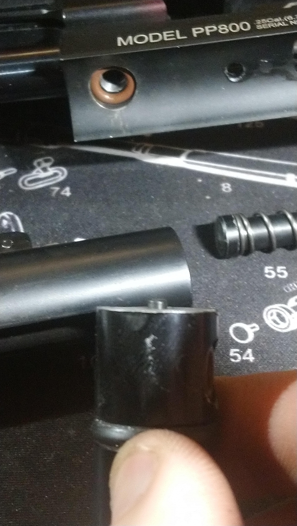

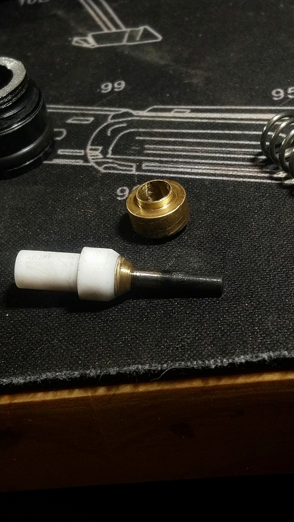

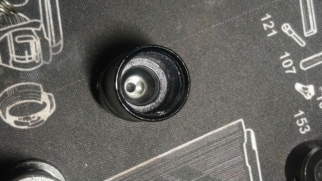

I have a 25 caliber pp800 that was doing 30fpe. It is a single shot, and there is no magazine available. Nor is the receiver machined for one. I detuned it to 27-28ish fpe where it is very happy. The barrel has no choke that I can tell, and the result is that it is not picky about what velocity it shoots pellets at. 25gr jsbs it likes the best and shoots them extremely well.
Mine uses a pr700w hammer spring. And has a full port job of 5.1mm. Up from 3.5. I also ported behind the valve exhaust to 5.4mm to account for valve stem volume.
I also cut back the poppet to extend valve actuation. As well as reduced the back side of the vlave housing. Valve travel was severely reduced to keep it under 500fps for Canada regulations. Gets 8 shots 620-680fps. But I will plink with 15 or more shots. Here is 5 @25 with 1 that I pulled. Trigger was 1 lb 8 oz (after adjusting) It was much, much stiffer than that. I now have it at 14oz.
I'd recommend the 22 caliber unless you just want the 25. The 22 does have a magazine. I got the 25 because I had a 177 Bandit and fooled with it some. It was easy to work on, so I was curious what I could get the 25 to do. I was also confident it would shoot/perform well due to experience with the bandit.
1581923556_13309604315e4a3ce49e3191.17858621_75619089_10157548398559034_7824696205832617984_o.jpg
1581924372_10313159045e4a4014862885.63008488_75362220_10157548392979034_1919482530247999488_o.jpg

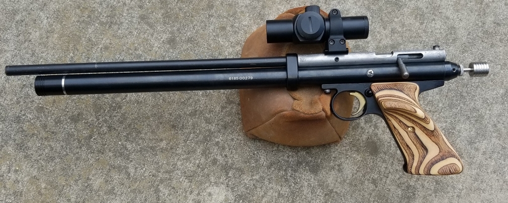

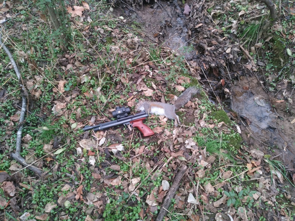

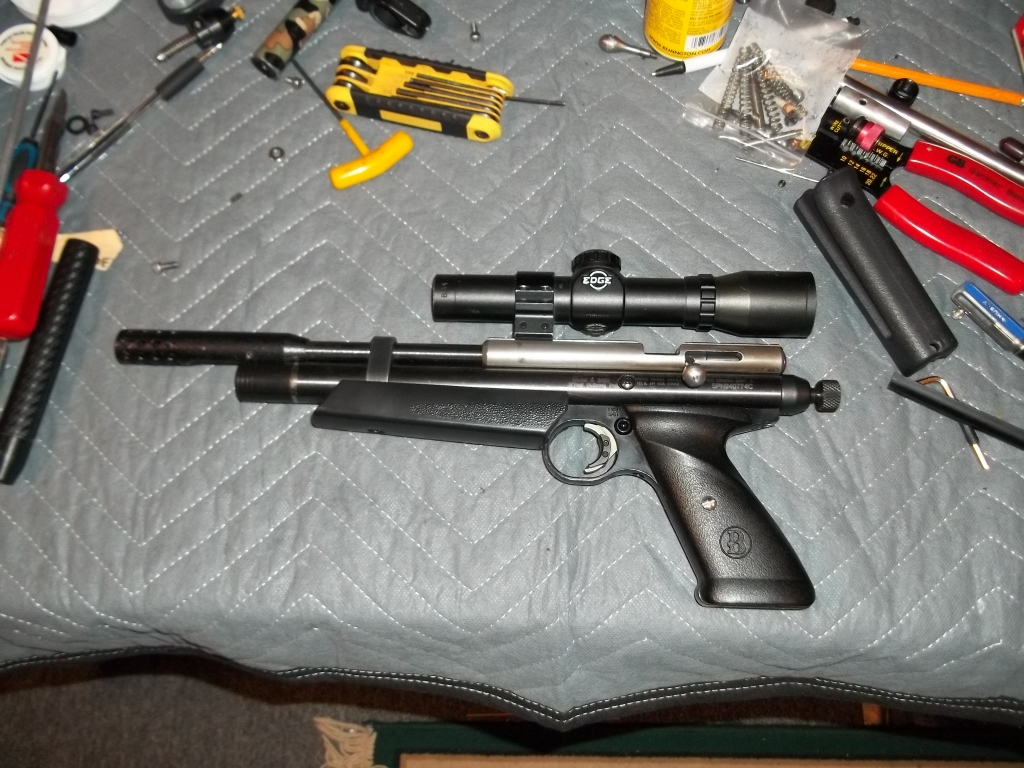

I would have to second Rob in NC's suggestion -
Some sort of Crosman 22XX hpa conversion is how I accomplish your goal -
Star with a Crosman Custom Shop purchas, as in a 2400 with a 10" 22 caliber barrel, a Discovery type valve and fill adapter, a little time on the drill press -
VOILA -
Would probably need a Cothran valve to hit 20 fpe, but it will kill a squirrel or rabbit with far less -

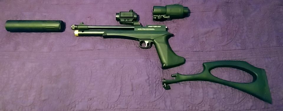

As far as modding a pp700 or 800 for 17fpe in .177, you are going to struggle. That's asking a lot from a pistol. Reason being simple. *Barrel volume* you're choosing the least efficient caliber to work with, and as a result the gun will struggle to make that kind of power. In that small caliber.
The pp800 can, I have no doubt, but your power curve is going to be unsightly. You'll only have a tiny handful of shots at that power. And the air reservoir is so small there is not room for a large enough regulator plenum to make that kind of power. My 177 Bandit has a regulator, and no plenum. I have it tuned to shoot a 50 shot string at 650fps with 8gr pellets. It has a 50cc reserviour. Even less with the regulator. That's pretty tiny in my opinion. The bandit did shoot 16fpe max without any tuning, and no regulator. Which is a lot for a small .177 pistol. And even then the power curve was atrocious. Very few shots at peak power, most falling off steeply on either side. With the regulator and large plenum (remember I deleted the plenum because it cut my air supply down to 30cc or so) at max charge, and regulator turned up to the same pressure the power previously peaked at... I lost a good 120fps with the same projectiles. The reason being, the actual air charge is deminished due to the restricted size of the plenum. Given the air tube dimensions, the small plenum was already too large.
22 is far more efficient due to larger barrel volume. More space for air to expand and act on the projectile. The 25 is more efficient than 22, but the projectiles are quite large, and do take considerable air to fire them.
The pp700 is regulated. And you will struggle to make the power you talk of without removing the regulator I would think? If you can? Again coming back to restricted plenum volume. My 25 caliber has no regulator. I put mine in it to see how it would do, and it lost a huge amount of power, as I expected. I think I lost 9fpe
I should also note the moderator on my bandit worked quite well, but only after flipping the last 3 baffles around backwards 🤔 doesn't make sense, but I tried every other arrangement. There is no moderator for the 25 caliber. And I'm not even sure of the pp800s come with them either. I kmow the cp2 and bandit does. All the barrels are threaded m10x1.0
I have the p700w. If you open the adjustable regulater up and tighten the hammer tension screw or possibly purchase a stronger spring and if you use the 22 cal option you can make 17 fpe without drilling or complicated work very easily. Also the higher mass and larger bullet deliver more energy down range than the 177. However if you are stuck on the 177 just do the same thing but drill out the transfer port area on the block. There are many threads out there on this. I belive you could probably get at least 15 fpe without too much sacrifice on shot count. Here's the thing though I don't think it's worth it. I did it and it went from 30 shots to 15 shots for just like 90 fps. I would rock the 22 and just tune it for power from the factory settings. Listen man this keeps your warranty valid. You can always go back after shooting it and learning it for a year and then you will really understand its capabilities and strengths as well as its weakness. or just get the marauder pistol and adjust the preload to get a couple extra fpe. Then you get a multishot that's accurate. I don't think fpe really becomes important until your shooting foxes and bigger. Squirrels and rabbits die just by looking at them the wrong way. Jk but seriously accuracy and shot placement is more important. The stock marauder or pp700w can do that fine. If you good luck
