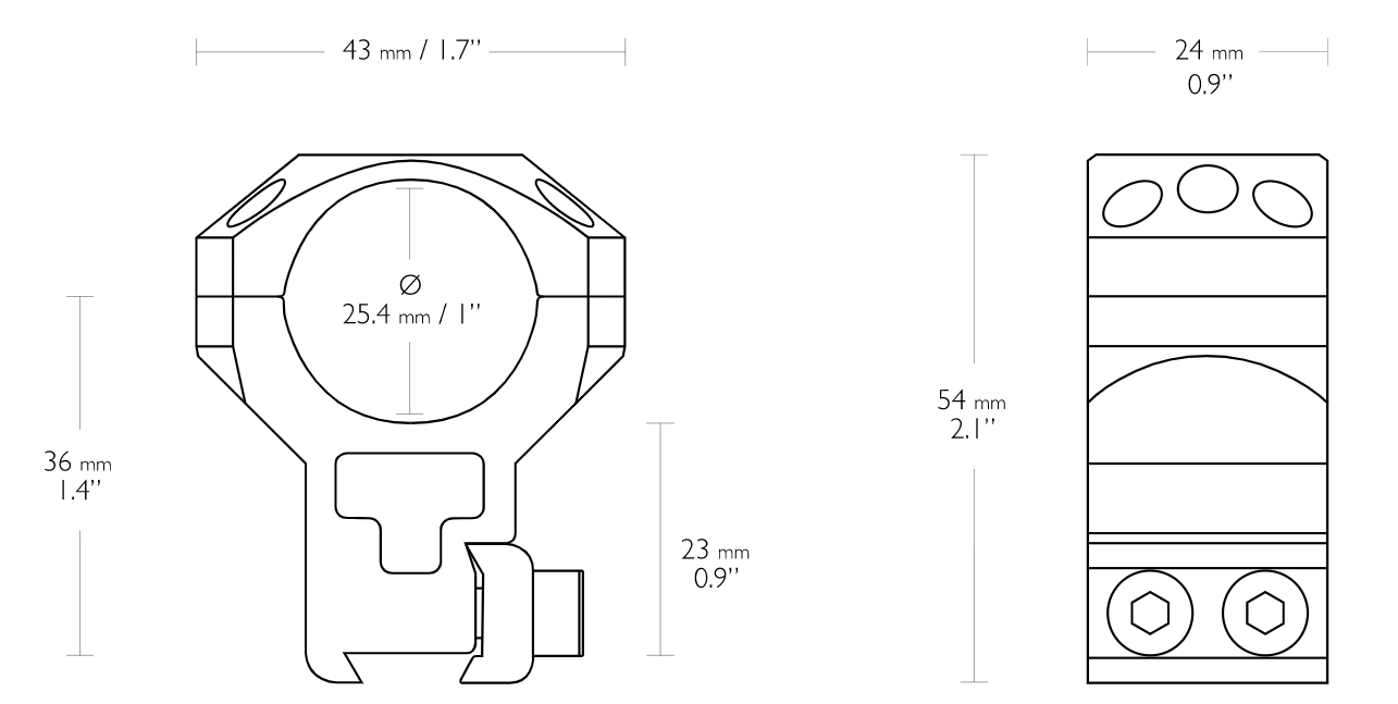

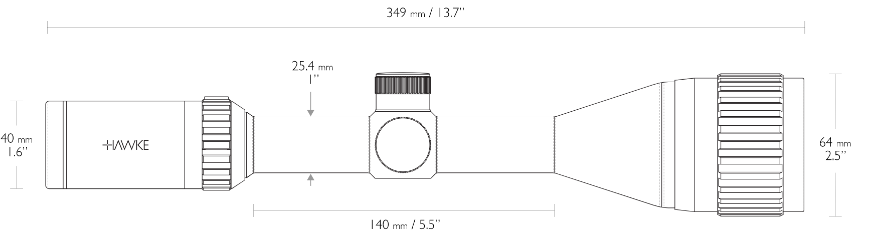

Your scope's objective lens is 2.5" diameter which is 1.25"+ for the rings. Hawke tactical extra high rings will give you 1.4" height for your scope.
Your scope.
