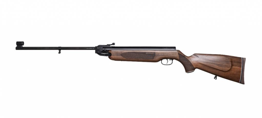

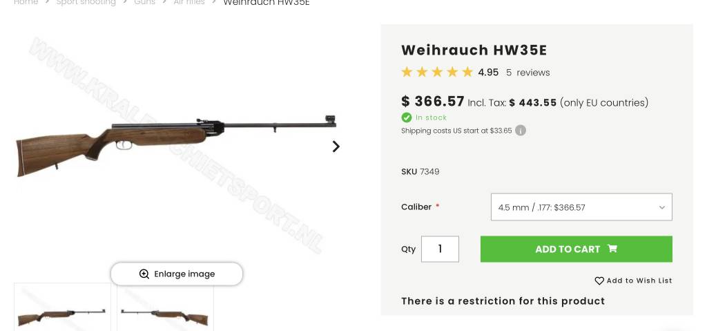

Your first choice is the FWB. They’re not that heavy or powerful. Then you get into much heavier and more powerful choices. I would suggest something in the middle. The HW35E. Beautiful 70 year old classic, with a gorgeous checked Walnut stock. Weihrauch’s best build quality. Locking barrel makes it as rigid as the fixed. Much lighter. Would be fun to tune and has great potential for enough power. It’s got the “heirloom “ look. $366 and in stock in .177 at Krale. $55 shipping and no tax. About 3 days shipping door to door.

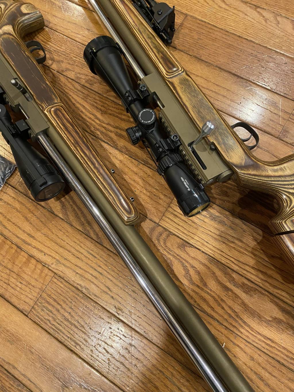

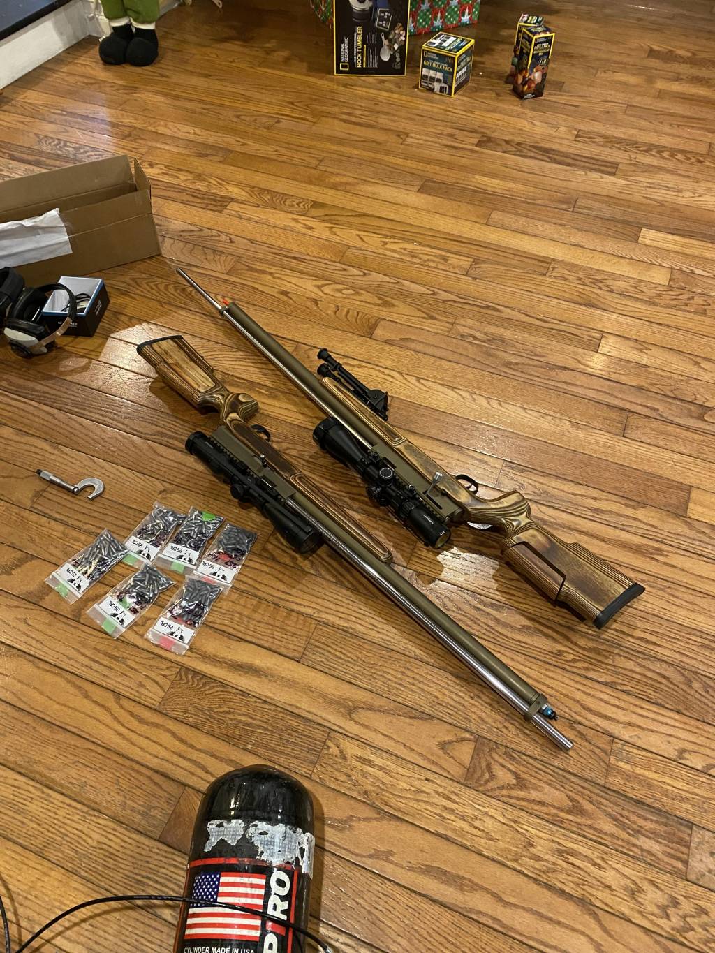

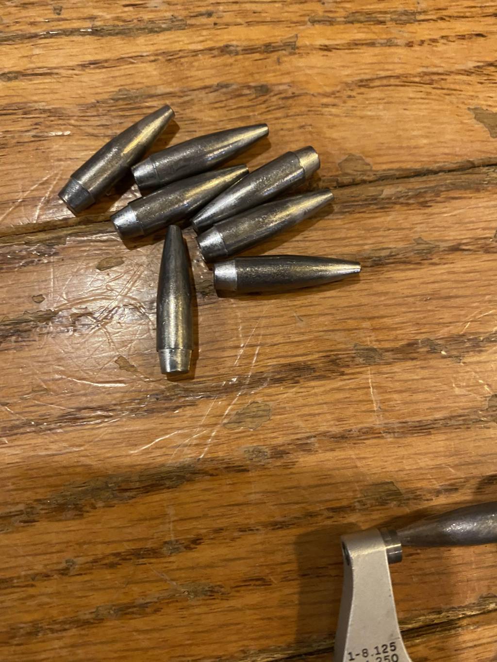

I'm in the middle of moving & the only time I shoot as of now is for 300yrd sub 1" groups on weekends with my (2) .2573" Scandalous rifles.
Why is it called Scandalous? Oh man. Here's the article
https://www.pyramydair.com/blog/2012/03/lasso-2012/
And please don't flag this as irrelevant as I know the OP Raden. Buddy I know you loved that .25 Condor. Now imagine that on Yotes & pigs at 300!!!!
YOU SURE YOU WANT A SPRINGER? Lol.
Bowman sent 20 out of 19 through a 1" Ram silhouette that day in winds. 257420 cast 72's. Not swaged. I'm trying swaged for now.
. It went up against at least 10 .308's that day and kicked the ever loving snot out of 30+ contenders. John Bowman built these especially for me. 2 Lilja barrels but I like the 26" 1:14 Bull Lilja more than the 32" 1:10 skinny.
Prices are $2200 with 2 Lilja's right now. TJ liners drop the price significantly.
Anyone who wants Bowman's # for custom orders just PM me.

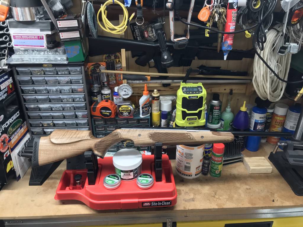

Really all guns mentioned are great guns, you’d be happy with any of them. I love my HW97’s, got one in .177 & in .22, both are accurate and well made. I don’t have a Tx200, but I do have a AA Pro Sport, to compare to the HW rifles, & it is finished nicer (Blueing and Stock) than the HW’s I own. Unless your getting a custom stock made, the Air Arms will have a nicer Stock from the Factory. Here’s picture of My AA Pro Sport LH - this is one of mine I’ll be passing down one day.
Nice. Pre fish scale, which I do like; but the older tiger stripped stocks use to be pretty common. That one has some nice figure.
Yeah newbies wouldn't know but Theoben, Daystate, Air Arms all use to use amazing Walnut for "stock" stocks. Ones would be near show piece's today.
