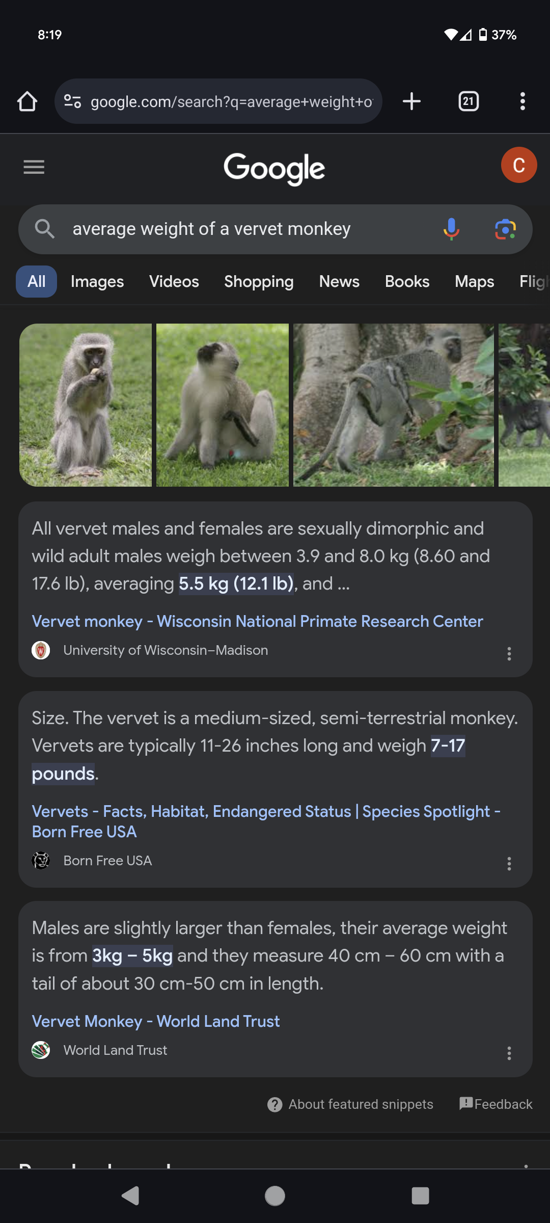

I don't have any experience with any type of monkeys, but given the size and weight of the vervet, anything good for raccoons should be more than enough. The FPE requirements would depend on if you are going to limit yourself to head shots, or open it up to shots to the lungs. I presume with lung shots they will walk off some distance before expiring. With air guns use a dome pellet and forget about those expanding pellets for this size quarry.
Physical description[edit]​
The vervet monkey very much resembles a gray langur, having a black face with a white fringe of hair, while its overall hair color is mostly grizzled-grey.[15][16] The species exhibits sexual dimorphism; the males are larger in weight and body length and may be recognized by a turquoise-blue scrotum. Adult males weigh between 3.9 and 8.0 kg (8.6 and 17.6 lb), averaging 5.5 kg (12 lb), and have a body length between 420 and 600 mm (17 and 24 in), averaging 490 mm (19 in) from the top of the head to the base of the tail. Adult females weigh between 3.4 and 5.3 kg (7.5 and 11.7 lb) and average 4.1 kg (9.0 lb), and measure between 300 and 495 mm (11.8 and 19.5 in), averaging 426 mm (16.8 in).[9][17]
Absolutely zero personal experience with Vervet monkeys.....
But this was my first thought of necessary info.....
So something like 12-15lbs on average...
Makes me think racoonish in size.....I'd say 40-50fpe on the light end, if it's an official government gig like your saying. Sure you can kill a raccoon sized animal with less fpe, but I'm thinking you better err on the side of more humane in this situation.
