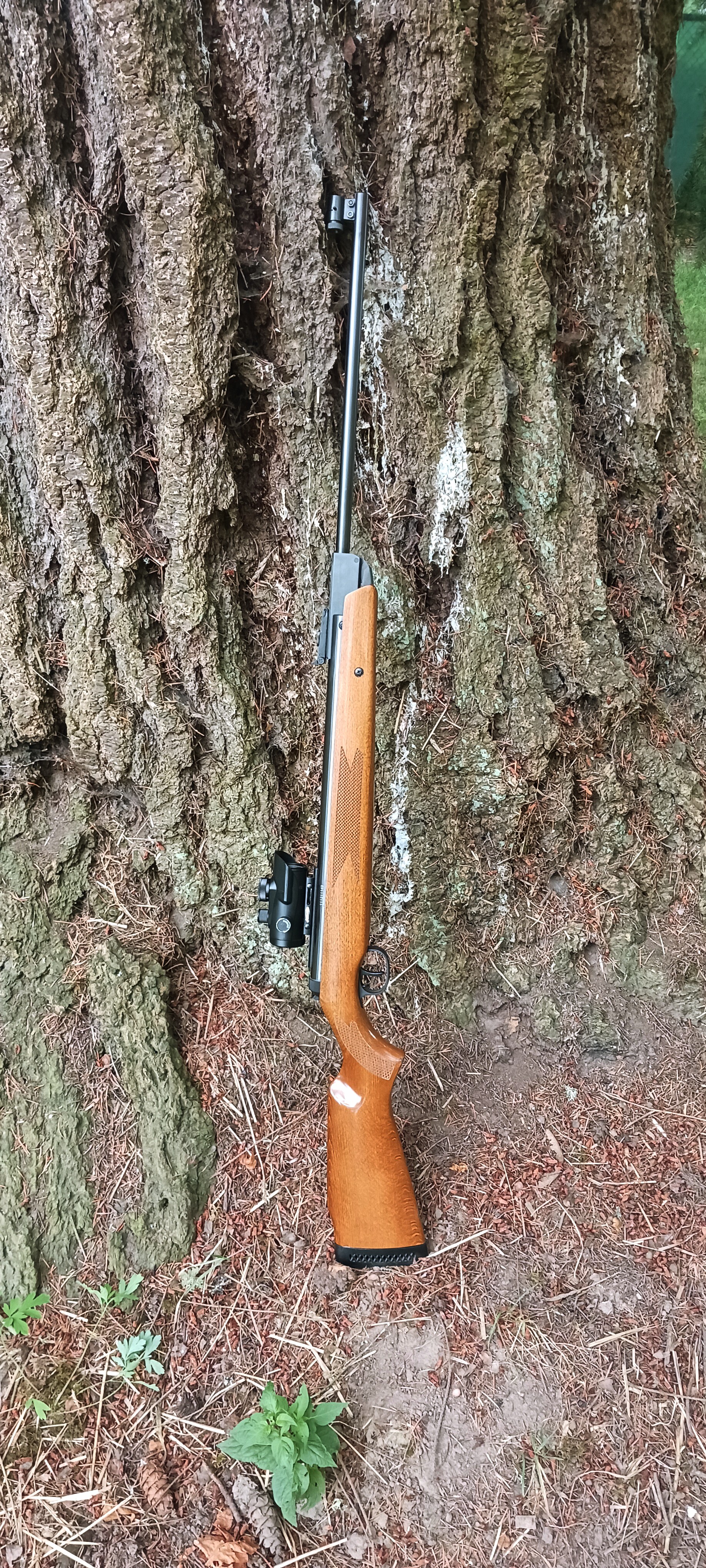

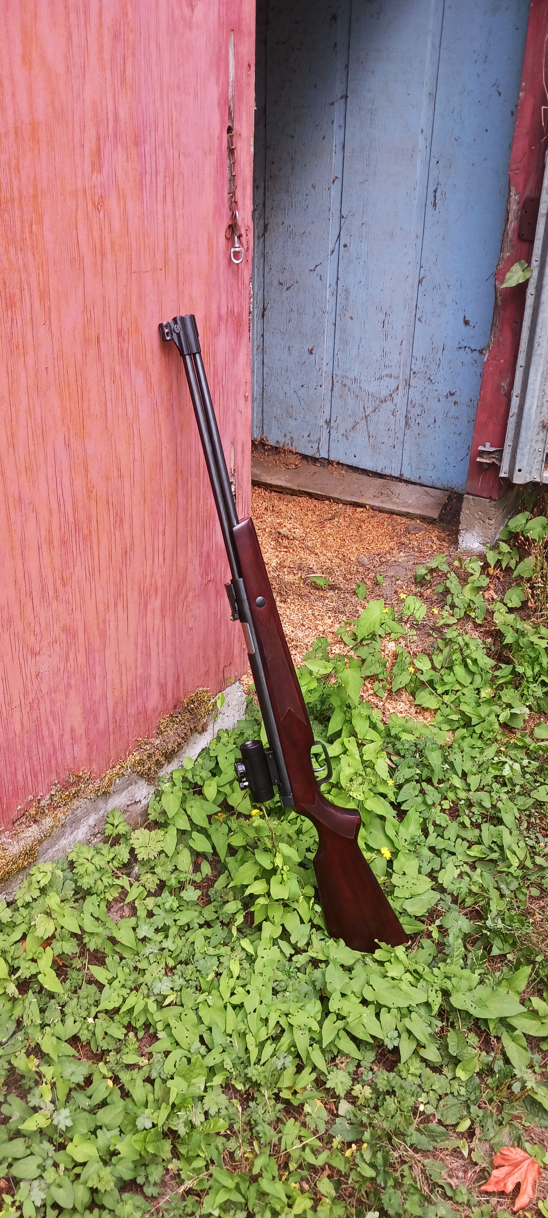

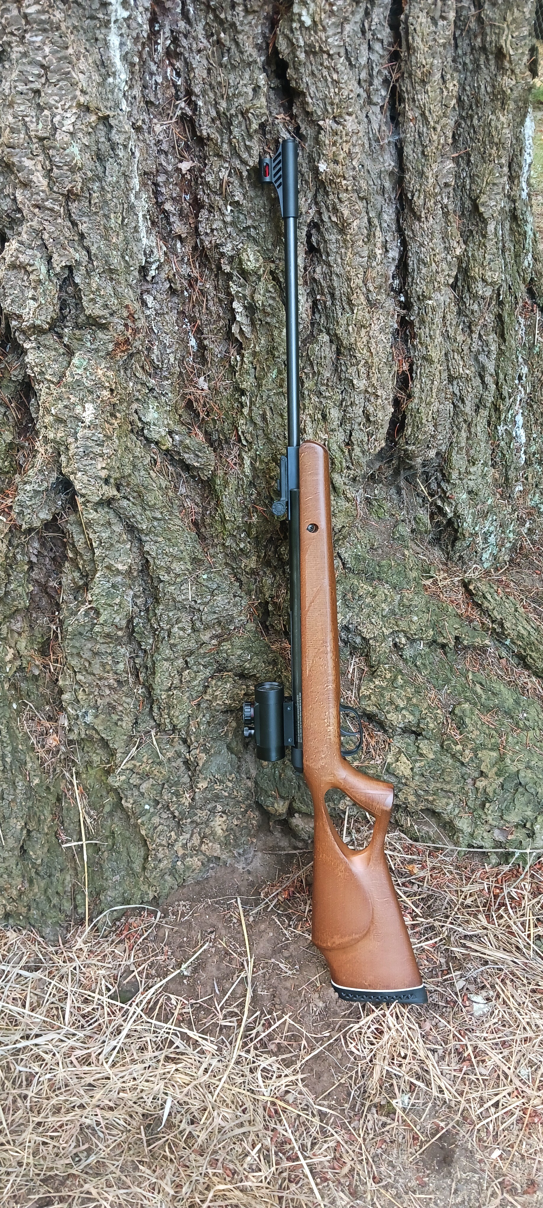

I have used them for years on many of my springers. They hold up well. My preferred optics. Here is just a few.
