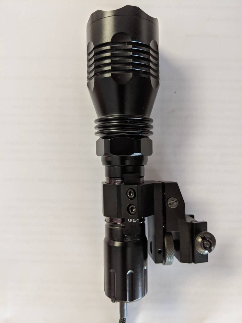

Okay, now that I have your attention, let me tell you how I used my new mini-lathe to solve an airgun problem. I hunt at night on occasion, and sometimes I don't want to use my ATN X-Sight II equipped rifle. I had picked up a couple of those scope-mounted LED lights. One in green and one in red. The green one came with a nice picatinny mount that was adjustable in elevation and windage to properly line the light up with the view in the scope. The red one came with a cheap clamp mount that was hit or miss, with no adjustment whatsoever. I quickly discovered that the red LED works much better at reflecting eye shine, and has a longer range due to being brighter. I just couldn't get it to line up with the scope. No problem, I told myself, I'll just order another of those adjustable mounts. When it arrived, I discovered that the outside diameter of the red LED was too large to fit into the one-inch mounting clamp. So, I stuck to using the green light for shooting, and the red light for scanning by hand.
Well, recently I decided to get a mini-lathe and start learning how to turn large pieces of metal into smaller pieces of scrap metal. Today, I completed my very first project with the lathe. I measured the red LED body and found there was plenty of metal to allow turning it down to a one-inch diameter in the middle. Now, it fits perfectly in the adjustable mount. Here is the finished product:
It was a simple project, perfect for my first job on the lathe, and I think it turned out great. I'm looking forward to more airgun-related projects with it. Ya'll be safe out there! Shoot straight, tell the truth, and be kind to one another!

Here are the light and adjustable mount I picked up from Amazon:
https://www.amazon.com/gp/product/B07B9X53N5/ref=ppx_yo_dt_b_asin_title_o00_s00?ie=UTF8&psc=1
https://www.amazon.com/gp/product/B00VV0BIRW/ref=ppx_yo_dt_b_asin_title_o00_s00?ie=UTF8&psc=1
It was frustrating that I could not find a red LED light made for the adjustable mount. That was back in 2019, when a calendar year knew how to behave itself. Maybe if you look again, you can find one that fits without alteration. If not, let us know how yours turns out!
