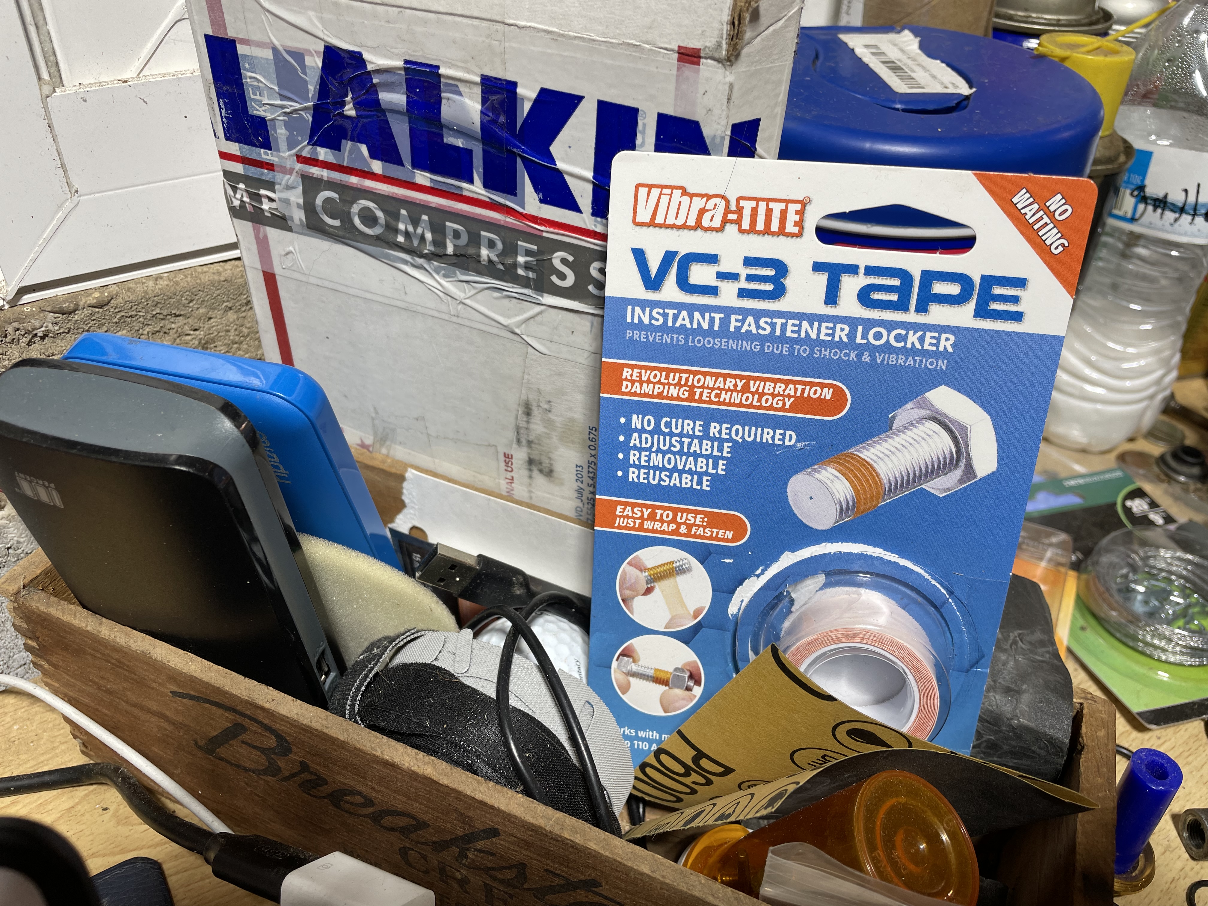

I’ve been using the purple loctite, if loctite is needed, it is low strength. Also vibra-tite is good. I just got some vibra-tite thread tape to try. I ran into the FX shroud end cap problem…not sure what they were thinking with that one.

I haven’t tried it yet, I’ve no idea where I’ll use it, but like the idea.
