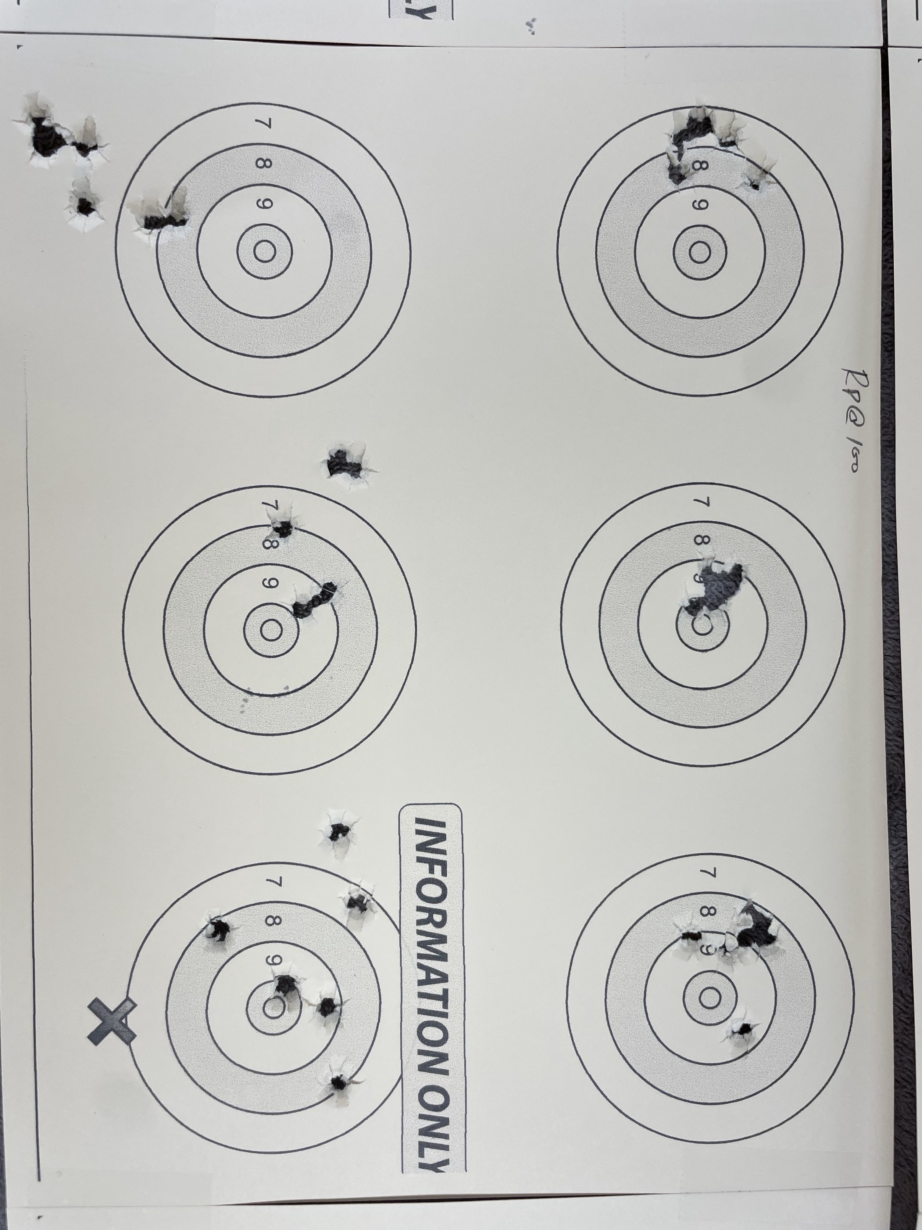

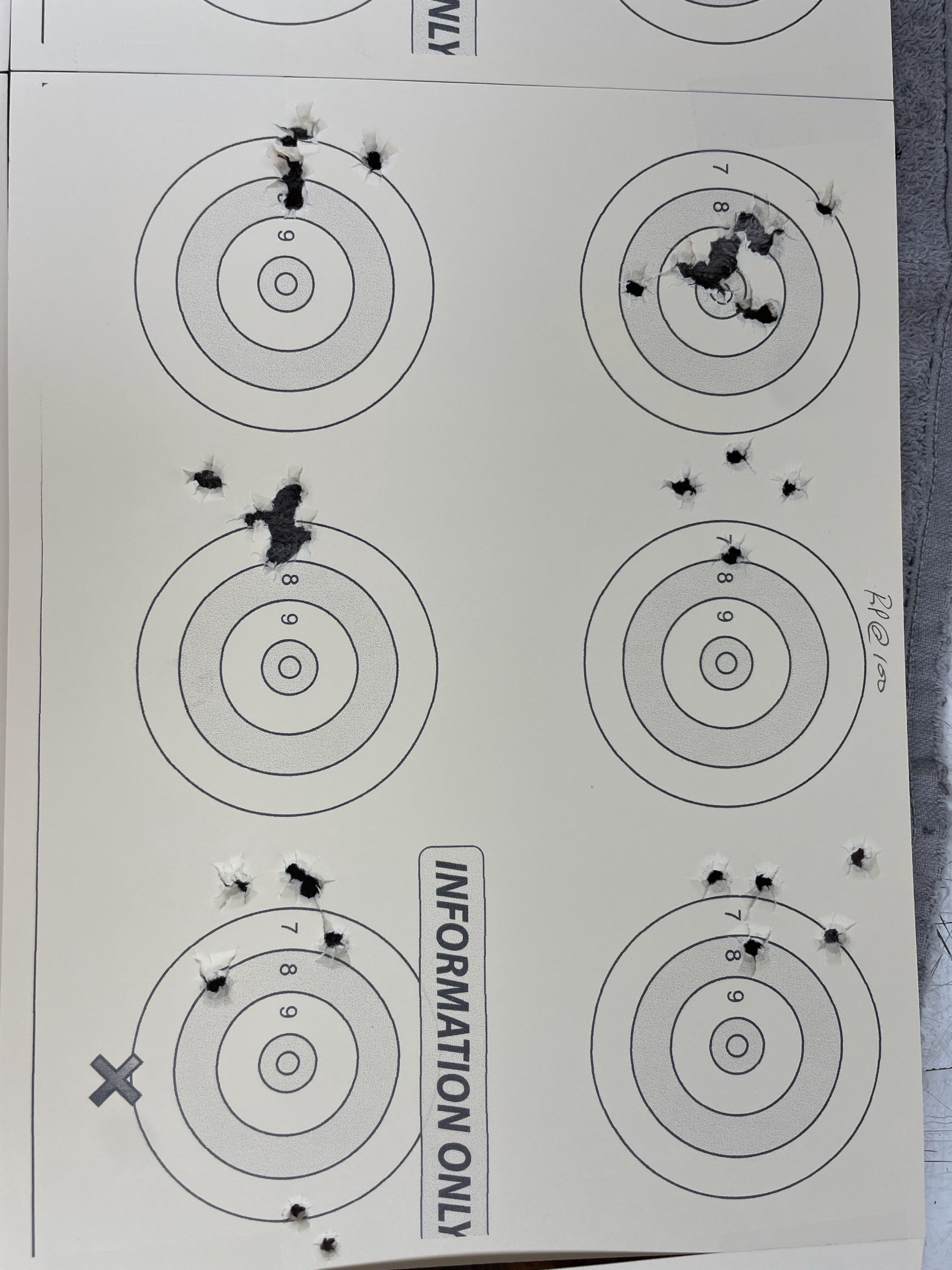

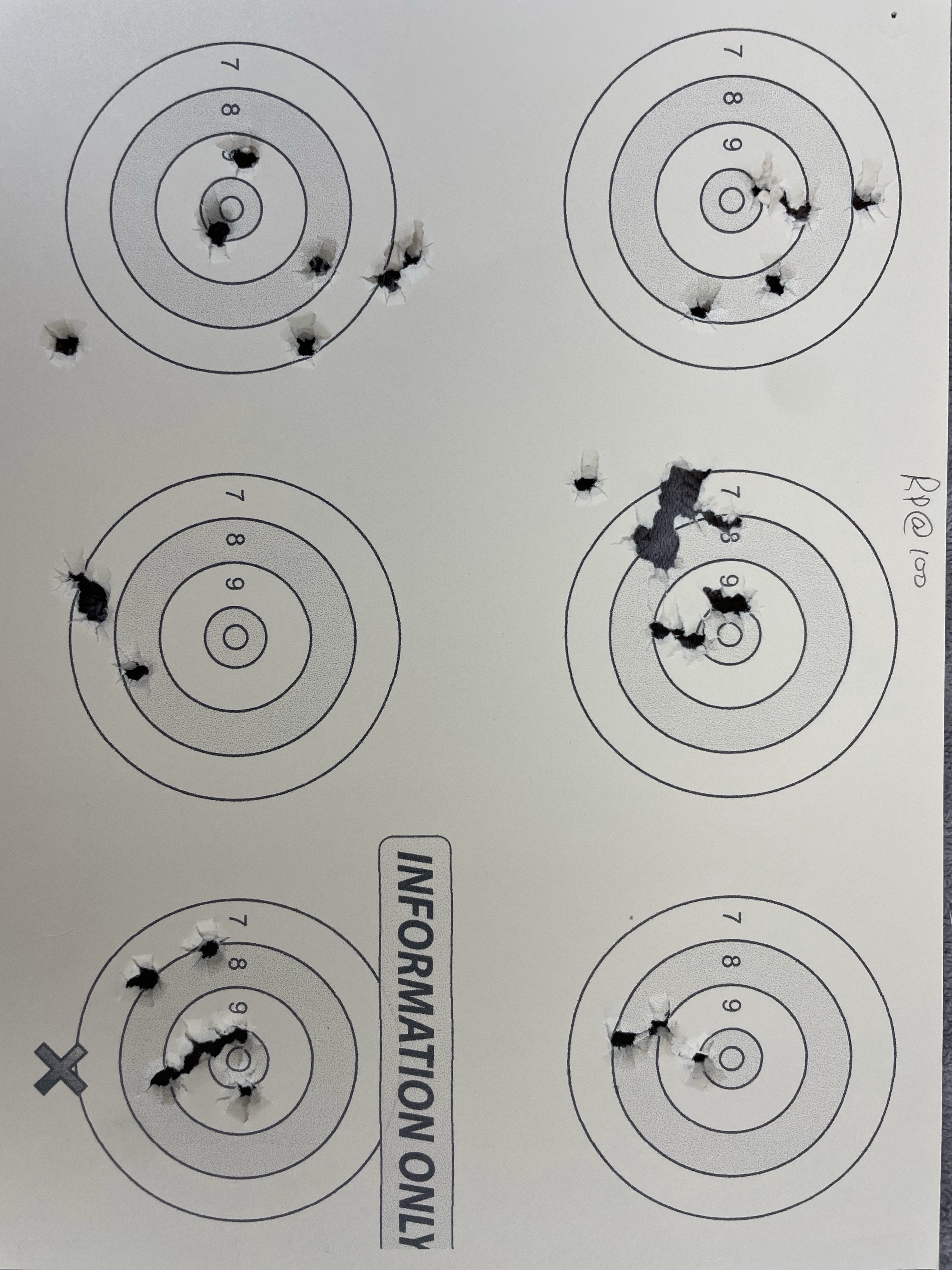

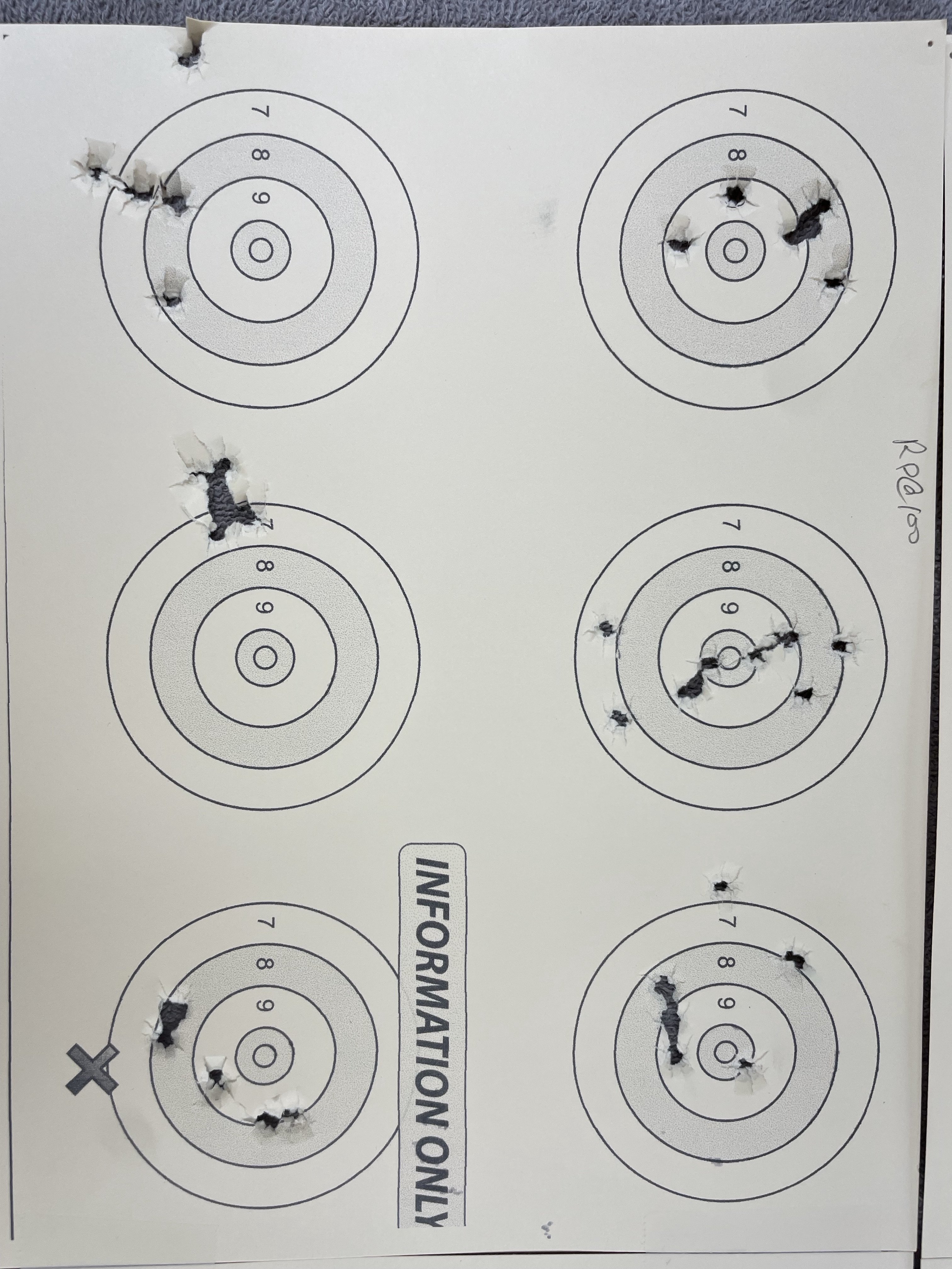

I believe the rifle has a LOT of potential so don’t read too much negativity into my initial review. After I got home I made a call to Donny FL and they suggested adding a TINY drop of BLUE LocTite to the threads of the locking nut. I removed the nut, well actually it is a male threaded stud with a thumb head cap, cleaned the threads and added a SMALL drop of BLUE LocTite and it’s back in the safe to set up. It’s going to be a week before I can get back to testing again so I will report back next week. In the interim here are targets I shot today at 100Y. When the speed was up and holding, that is when I was able to shoot a single under dime sized ragged hole. BUT, when the transfer port adjustment slipped and the velocity dropped off the groups quickly opened up. I’m not posting cherry picked groups, just as the targets were shot by a Joe Average shooter.
