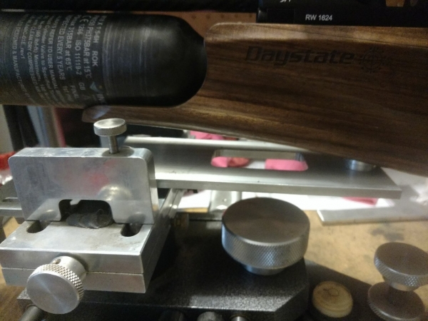

I traded in a few air rifles to offset the cost of my new .22 Red Wolf (RW) High Power. Trade in price unfortunately, was reduced by a lot because of stock modifications I made. Modifications that added cheek rest to two guns and an accessory rail to a third.
Who would have thought that my "improvements" would negatively impact trade in value................I write rhetorically. Lesson learned. On to the point.
After shooting my new RW, I determined that I needed something to hold the airgun upright in my mechanical rest. I decided however, that adding a rail might hurt future RW trade in value. Likewise, I was not enamored with the thought of spending $500 to $1000 on a custom bench rest stock. After hours of thought, countless sketches, and many feeler gage and steel rule measurements I came up with an idea.
My idea was to mill a pocket on the inside of the stock below the air cylinder to hold a 1/8 X 1 inch x .125 piece of steel. A steel piece that I could a fit a 3X5 shoe to. The shoe would sit in my mechanical rest for use during 50 to 100 yard bench rest competitions. I was pretty impressed with myself (which should have been my first warning) for coming up with such a great idea. So impressed in fact, that I mentioned the idea to another shooter. A shooter who is actually mechanically inclined.
His alternative idea (offered within seconds of my idea share) was a cantilevered piece of metal attached to the gun, via the screw that holds the stock to the action. Duh!!
Armed with rational guidance and a napkin based sketch I a.) turned an 11 mm long stand off out of a 25.4 mm piece of round aluminum stock, b.) center drilled the standoff for the stock bolt, c.) milled a .250 x 3.0 X 6" piece of flat aluminium stock (to include a bolt hole and a rectangular opening to access the air refill port), and d.) purchased a longer stock bolt.
The assembly seems to hold the rifle steady in my mechanical rest. I'll take the gun to the range Friday for a field test.
Note by the way that .250 aluminum flat stock in excess of five or six inches in length flexes. Hence I need to fabricate another bench rest widget out of steel flat stock to see how that may - or may not - flex. I may also look into .375 aluminum flat stock or aluminum U channel for something that might flex less.
Hmmm. Perhaps if I now spend more time shooting than I'm spending on puttering, I'll see what the RW can do in my hands. No. That can't be it. How could actual practice help my score? What a crazy thought.

Pictures were asked for so.................
I'll know tomorrow whether or not my engineering master piece is a keeper. I greatly expanded upon the design concept shared with me and so I'll take credit accordingly - IF it works. Alternatively, I'll claim that I just did what I was told if the device fails the test, or perhaps I'll claim I just "made it to print".
Best wishes to all, and a tip of my hat to real machinists.
