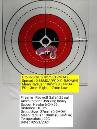

I have a Red Wolf HP .25 and I'm after some tuning advice.
On high power its shooting:
JSB Exact King .25 Diablo 25.39 gr pellets at 919 fps .
JSB Exact King Heavy Diablo MK II 33.95 gr pellets at 805 fps.
It seems a little more accurate with the 33.95 gr pellets which surprised me. I thought the 25.39 would be more accurate?
What fps should I be aiming for with the 25.39 and 25.39 pellets?
Would the 25.39 be more accurate on medium power at a lower fps?
