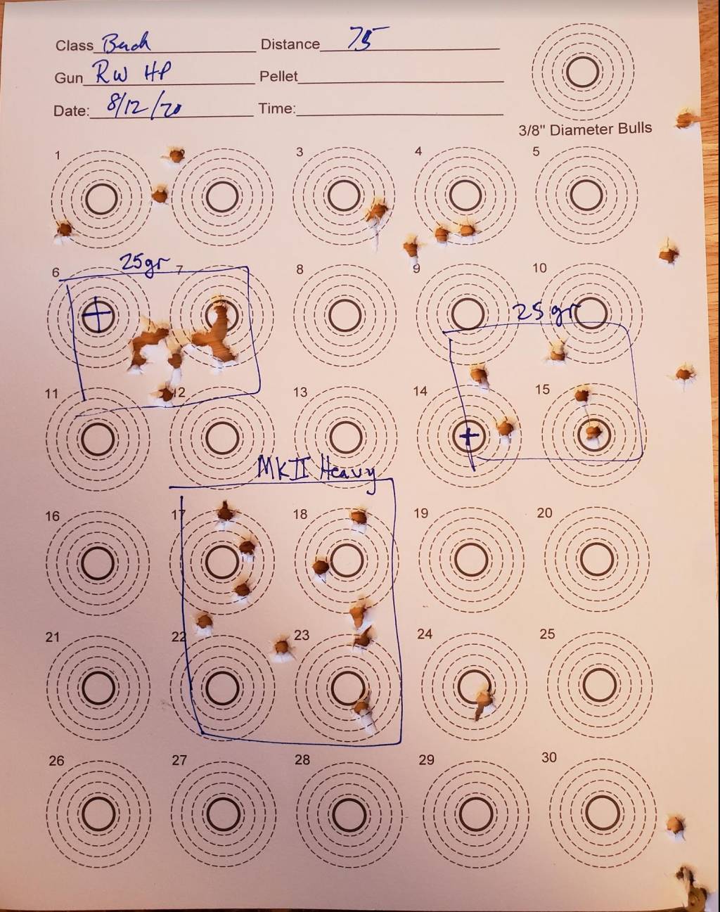

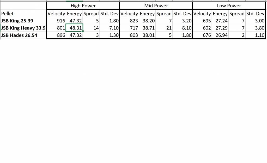

This is a small test I did with 3 of my favorite pellets with the Red Wolf .25 HP right out of the box.
Dan, you've picked up a gen 1 Red Wolf. What you're getting out of it is really about all you can reasonably expect. (7.4 v battery) My suggestion would be to stick to 25.4s and try to keep them around 900. There are a few touchups on the breech that should help with accuracy in those pre ART barrels and they can be VERY good so don't be discouraged in any way. The 34 gn will likely not shoot well, no matter what. It won't really hurt it to push it some if you get the programmer but again, I think you'll see best results around 900 w Kings.
You mention the Heliboard and it's a really nice option for convenience of programming but won't give you much more power as you're limited by the 7.4 v battery. The G2 versions (Safari) use an 11.1 v battery and additional changes were different valve stem, hardened hammer, and the elimination of a flat spring under the safety block that would break if pushed too hard. A rifle CAN be upgraded, but I'm not sure where you could get the parts. I don't think there is a kit. To do the upgrade, you would need a battery harness, battery, valve stem , and GC2 board or Heliboard. The hardened hammer would be a plus.
What I'm really saying here is that if you spend time getting it to shoot Kings well and not dwell on the heavy and high power, you'll be happier. They are nice rifles, regardless.

So, to sum this up, Red Wolf HP Gen1 is limited to 50 ftlbs max., maybe a little bit more with the tuning tool.
Given that constraint, I might be better off getting a .22 barrel kit for about $450 to get higher speeds for heavier pellets for benchrest.

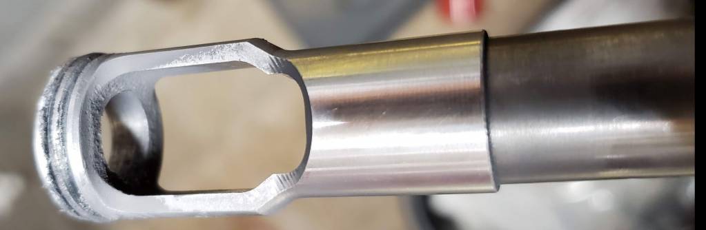

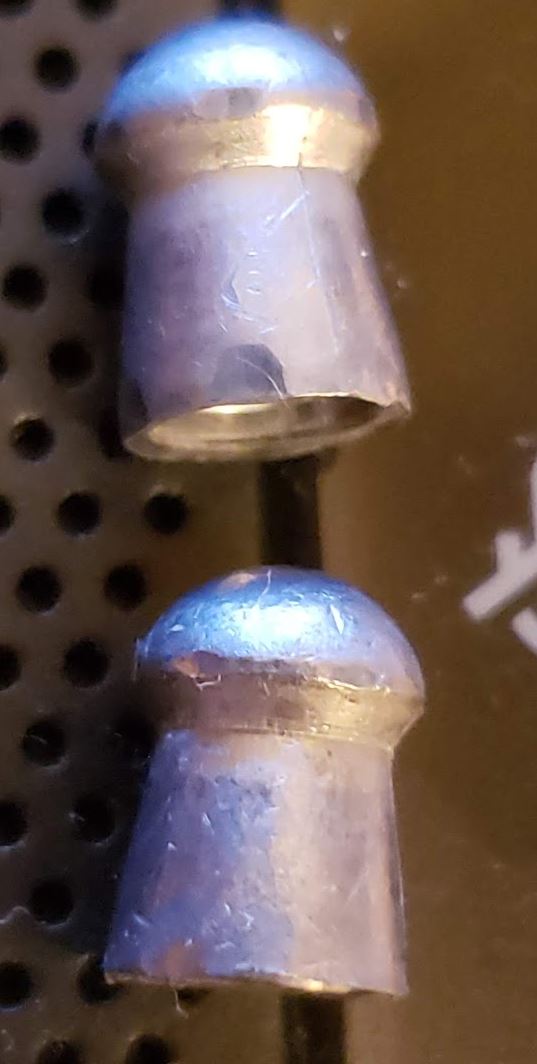

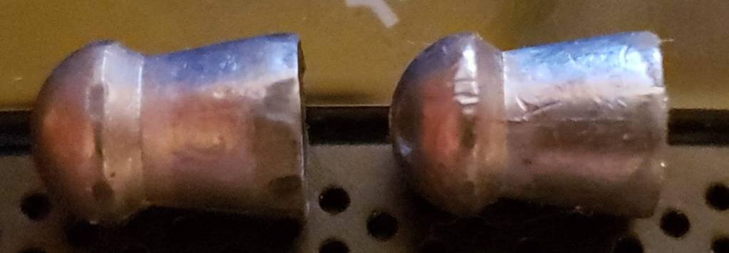

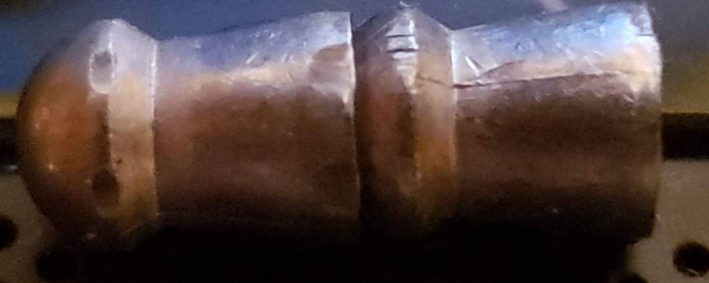

  3. Loaded a pellet, removed the barrel to see the impressions and pushed the pellet out the breech. The JSB MK1 Heavy seemed to start engaging already in the head and skirt area. The throat area had a well defined shoulder and was pretty rough. This got hit again with the polish below.

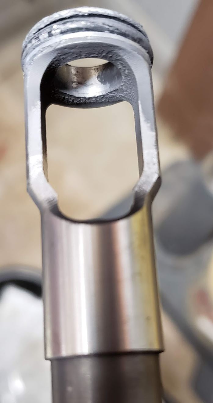

  4. Checked and re-polished the transfer port/throat area. There was a very slight burr that I removed and re-polished the area.

    Re-assembled and shot some more, a lot more - see target below. I got a 1.25" 10-shot group with JSB .25 25gr pellets. The throat issue got me thinking - maybe the MK1's are too long. So I tried MK2's - still no go 3" 10-shot group.
    I suspect that the throat engagement on the shirt in the area where the transfer port starts may be the underlying cause. I am theorizing (without much evidence I might add) that the longer 34 grain pellets get started slightly off kilter. Given that I can't get the speed up on the 34gr pellets, there isn't enough spin stabilization, plus there isn't enough skirt to fully stabilize them. Anyway - that's a very, very rough theory. I don't have a lathe, so really can't do justice to fixing this issue.
    I put the Red Wolf up against my Impact 30 and 25 to see how it fared in bench rest in absolute calm conditions:
    • Impact 25: 233 4x - optimally tuned
    • Impact 30: 236 5x (not tuned yet after the power plenum install) May have had a slight advantage due to the larger pellet size, but there were a few breezes. Impact POI do wander through the shot count.
    • Red Wolf 25 (25 gr): 232 3x (after dark)
    Anyway that was not too bad for the RW, given that the 25gr pellets were an open, old tin that I had lying around. Fresh pellets, it might have fared better. I did try Benjamin and H&N pellets, but they were also very long and did not fare well.
