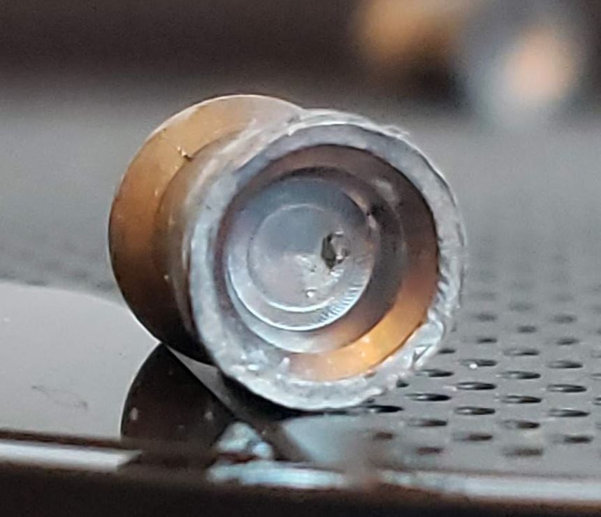

Just prior to getting the offer, I pushed a few more pellets down the bore. There was a visible imprint of the rifling lands, but nothing between them, even after going through the choke. The barrel was highly polished. I suspect that the barrel was a bit too open, allowing the pellets to get slightly cocked during loading or travel down the barrel. If I speed up the pellets to over 950, the groups tightened up on the 25 gr pellets, possibly due to spin stabilization.

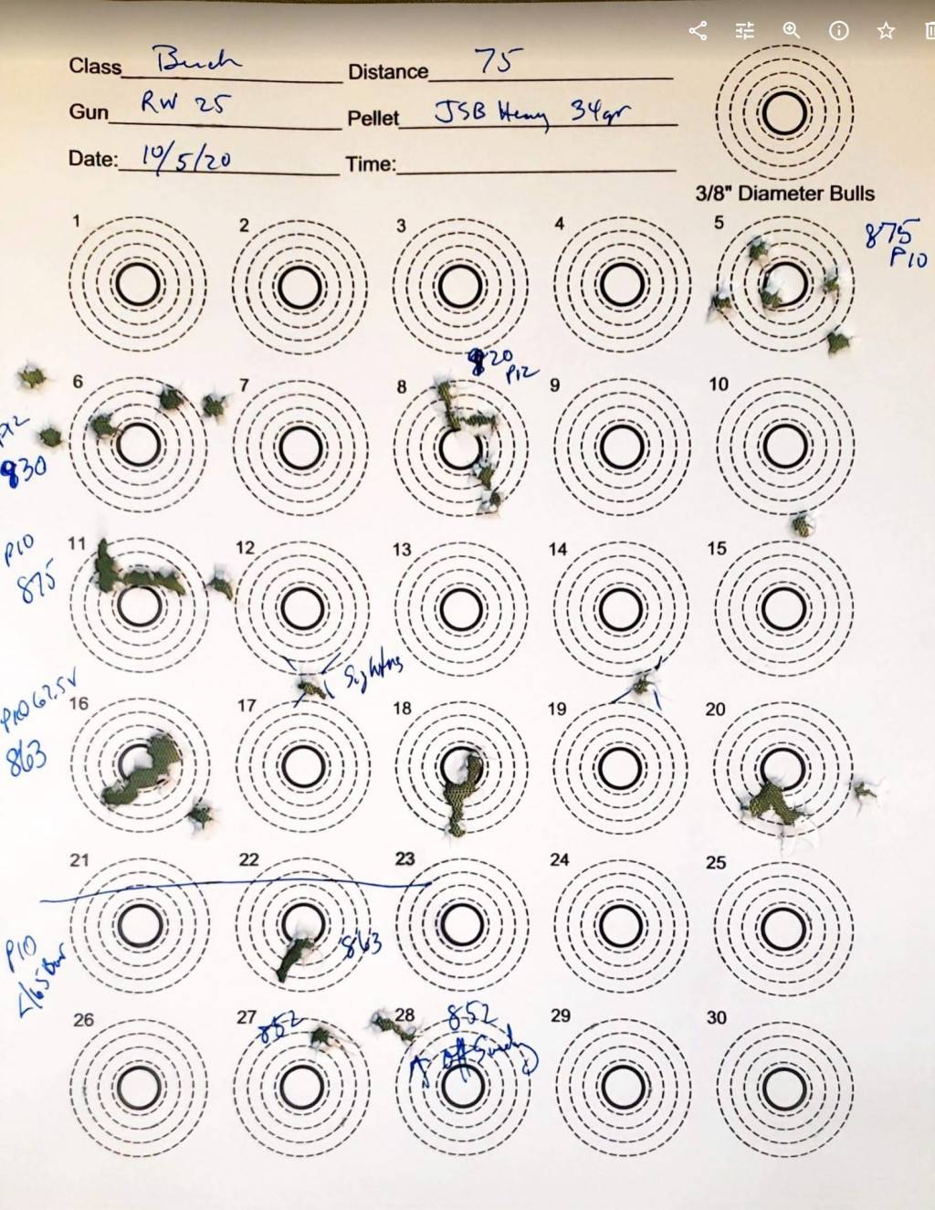

So great news! I received my Red Wolf back from AoA last Thursday. They replaced the barrel, along with tuned the factory stock board up to a maximum 850 fps for the JSB King Heavies (.25 cal 34 gr). Awesome work! They could not test for accuracy without the stock and single shot tray/magazine according to the paperwork, but the new barrel seems to be the key. I ran a couple of manual pellets pushed through to check the rifling and noted much deeper/better engagement on the rifling. I did note that the JSB Kings had a better head engagement than the Heavies - maybe they have a larger head size.
I was able to get out after dark tonight and shoot one fill through it with just the heavies. After settling in, I was getting about 0.75" at 75 yards with a slight breeze with the Heavies at 863fps (5-shot groups at #16, 18, and 20, circles are 1.25" at outer edge). I need to fine tune things a bit more when there is light out and I can shoot more than 1 fill. I fell off the reg after 35 shots due to the cold temps and the initial higher power level.
So, I would say success - problem solved thanks to AOA!
