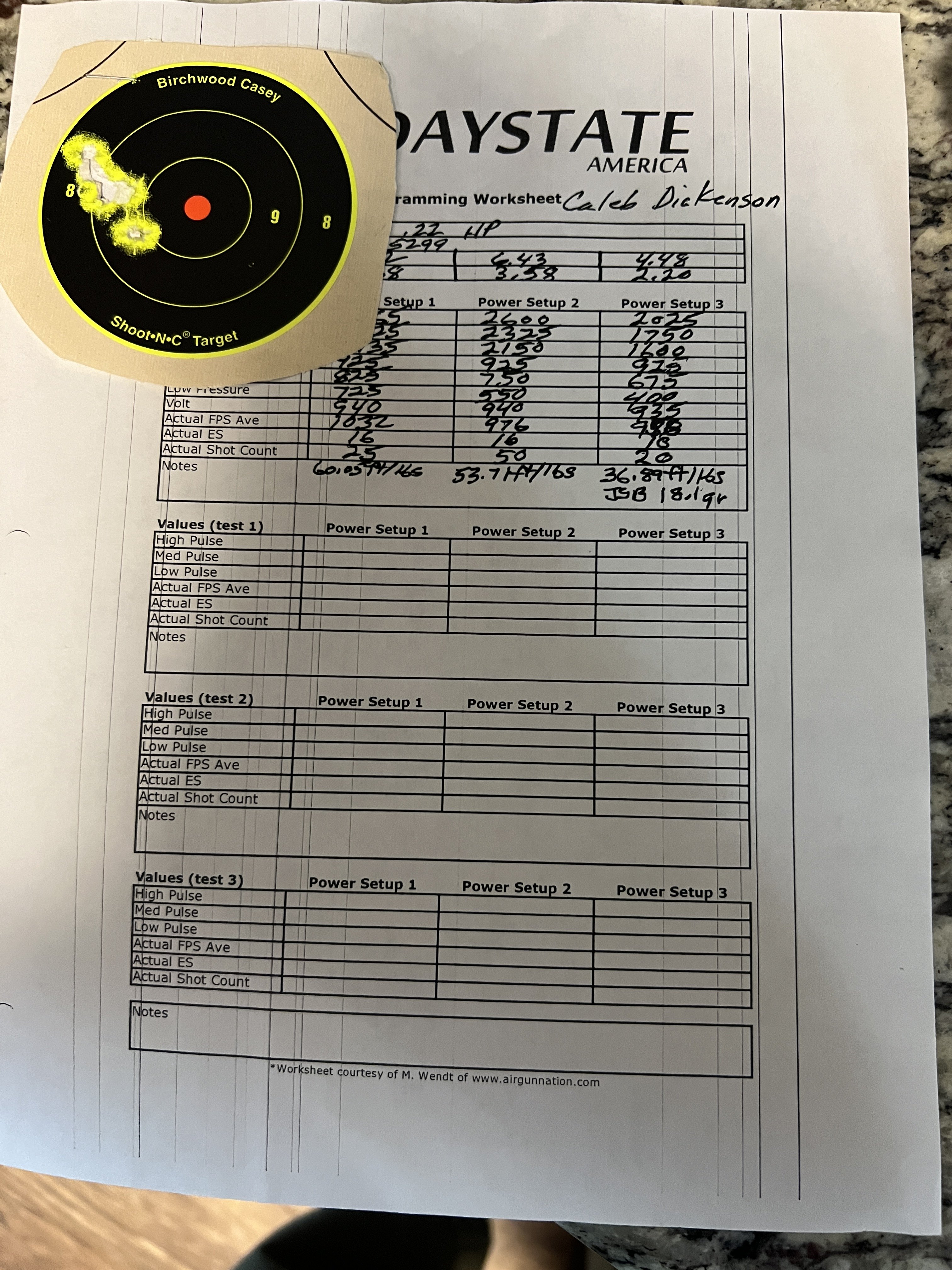

1... 1 in 17.7"

I put a Heliboard in mine for ease of transition between calibers and ammo. It's not necessary, just a nice convenience for me. The 3 powers will likely be pretty hot, depending on who tuned it. Typical is 930 or so w 18.1s on low, 965 w 25.4s on mid, and 1040 or so w 25.4s on high. The 33.4s will likely run about 910 on high if it's a recent rifle. These can be tuned for just about ANYTHING but you have to have a tuner or know someone who does. There is an EXCELLENT thread by Spray1Mark on the Resources channel on this site about the tuning process.
Dear all, after discussions with members on AGN and comments by some recently, I am going to start a thread discussing the programming of the DAYSTATE REDWOLF using the handheld programmer. This will be a fun Q&A hopefully, please post questions on the thread for all to see, not via PM as it...
www.airgunnation.com
