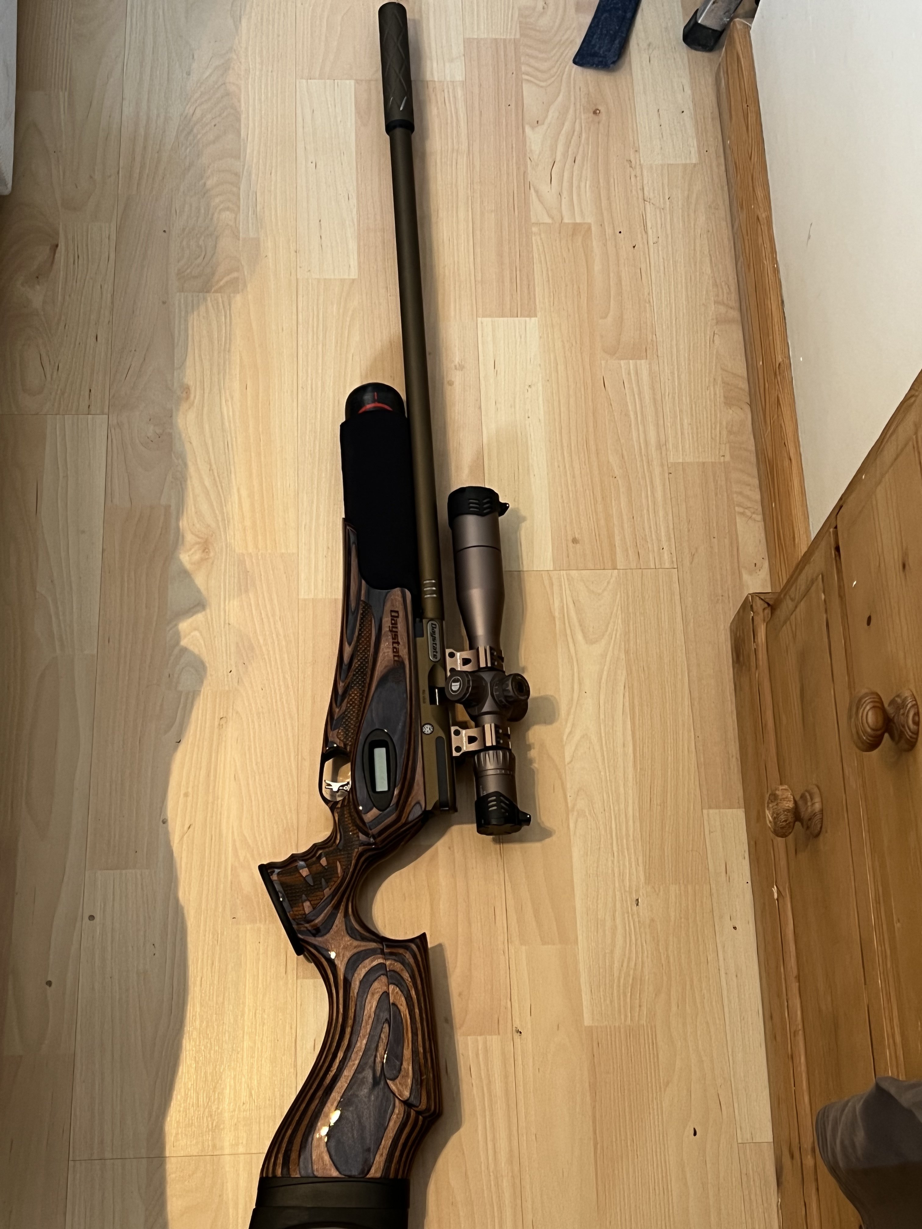

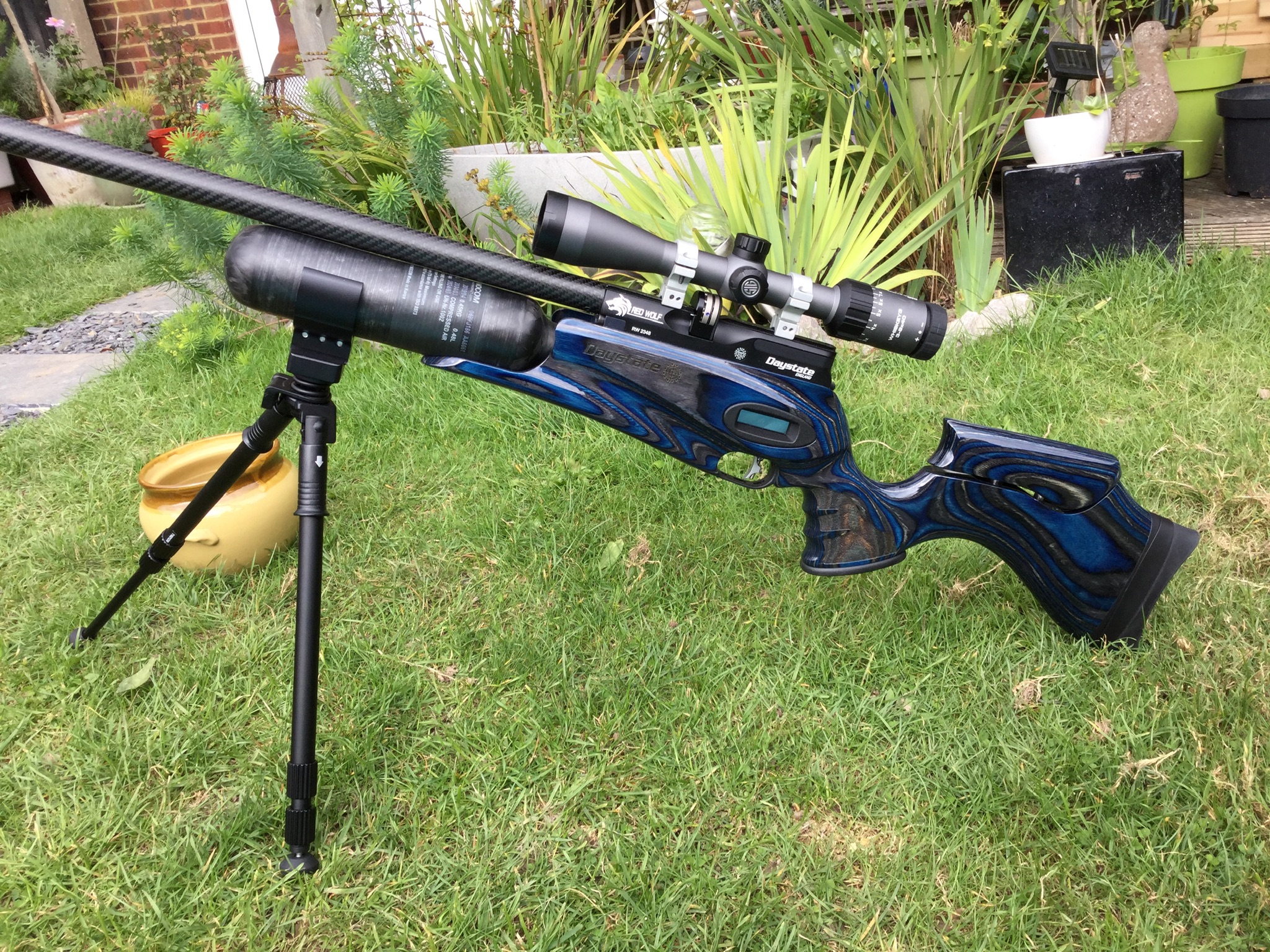

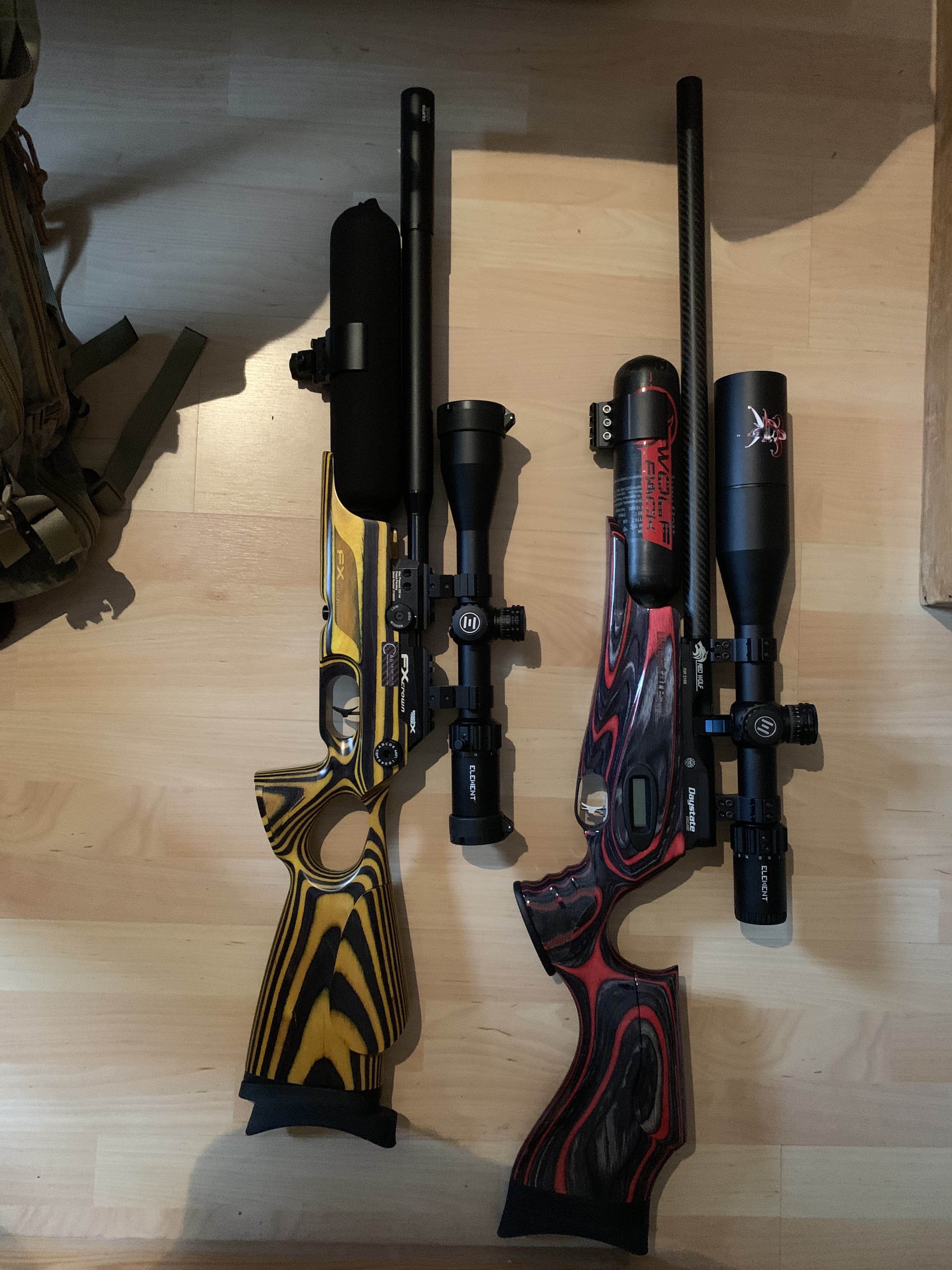

Very interstitial thread and informative. I shoot both the RedWolf standard and HP. I chop and change barrels and calibre’s depending on what shooting I am going to be doing and strangely what mood I am in.
The RedWolf in my eyes is ideal for off hand shooting as it’s a light rifle. At my age a light rifle is ideal. Below are thee of my girls excuse the Crown.
