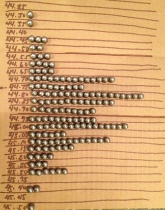

I know it's not feasible but I wish these pellet manufacturers would dump each individual pellet "from it's own specific mold slot" into it's own container, and sell them this way, instead of having the "how ever many pellets the whole mold gives being dumped into one container", that way we'd get close to the same exact pellet each a tin.

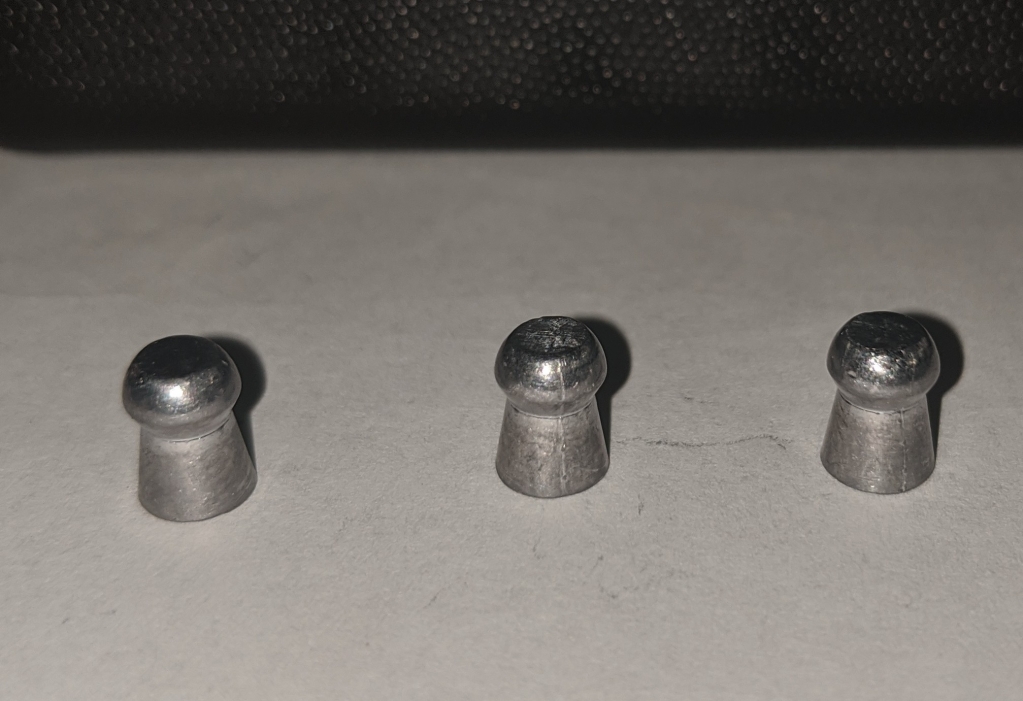

Cast pellets from an NOE mold in the RW?
Somewhere around 2 years ago I came across the NOE company out of Utah. They're a mold manufacturer that seems to have gotten into offering a couple options for airguns in the last couple of years. They make molds for pellets and slugs, in various airgun-barrel appropriate diameters, as well as sizers to get them to different-than-cast sizes, if desired. I believe that Bob Sterne had a lot to do with NOE starting to offer airgun projectile molds, as some of the slug designs are "Bob's Boattails." Bob will also sometimes comment about working with the owner of NOE.
The options in .217-.224 can be seen here: https://noebulletmolds.com/site/product-category/224 There's even a forum about using his cast projectiles in various guns, including airguns, somewhere there on his website. Anyway, I bought the NOE 217-20 mold almost two years ago.
My backyard shooting is done into some of the 5 gallon rubber mulch pellet traps that many of us use. Every couple of months I'll empty them out when they get too heavy. This was the most recent haul about 2 months ago. I'm due again as they're getting heavy.
I've ended up with a pretty good supply of lead, MOST of it high quality JSB lead.
I was already melting them down to be reused as muzzleloader miniball type projectiles, but I simply don't shoot that old muzzleloader enough to nearly make a dent in the lead supply. So, I was intrigued by the idea of being able to return some of that captured lead into pellets for the cycle to be repeated.
With a little care and attention, the NOE mold will make excellent appearing pellets. Here are some of the pellets produced by the mold. These were made a while ago and have a little bit of oxidation. They dimensions are quite similar to a JSB 18.1 with the main difference being a small meplat. The mold comes with pins that can be swapped for different depths of skirt and therefore weight and center of gravity. Reports suggest that the deepest pin usually produces the best accuracy. With melted JSBs and the deepest pin, the pellets produced by my mold weigh about 19.8 grains.
In principle the concept was sound, but in practice, not so much. Accuracy results were pretty bad in all of my .22 guns. Usually a couple of inches at 55 yards. The pellets wouldn't even hit an 8x11 sheet of paper at 55 yards from one gun. I gave a couple samples to friends and they never came back with glowing reports of accuracy, so I assumed they were seeing the same type of results that I was. I kind of gave up on the cast pellets, but occasionally I'll get them out and try them in a new gun, or a new barrel. The idea to eventually test them in the Red Wolf was hatched early in this review.
Here it is.

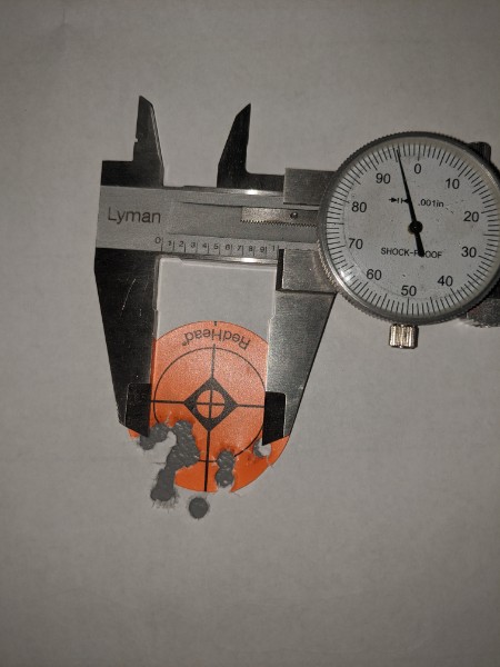

15 shots taken at 53 yards. Benched. I wasn't optimistic so used a big huge orange sticker target. RW set on LOW so probably about 29-30fpe with this weight of pellet.
I was pretty surprised to see the first couple only hit a little low, but to nearly the same point of impact as the JSB 18.1. I was further surprised (SHOCKED, actually) to see a decent group take shape. Ultimately I ended up with a 15 shot group that measures just a couple thousandths less than an inch.
They don't shoot quite as accurately as a JSB 18.1, but that's plenty of quality critter knocking accuracy right there. Pdog and ground squirrel head sized accuracy, easily.
I guess a couple different conclusions can be arrived at here, both about the NOE pellets, and the Red Wolf. First, it just goes to show that you can't ever give up on a pellet/batch/lot/etc, cuz sooner or later, a gun might come along that will shoot it well. Second, the Red Wolf came through as the one gun (thus far tested) that can shoot this pellet well. This particular specimen of RW has shown excellent (sometimes unbelievable) accuracy with just about everything that it's been fed. The only pellets it has really disliked were the JSB RS 13.43grainers. It also didn't shoot a specific batch of JSB 18.1 as well as other batches. In both of those cases, I could barely feel the pellet passing into the barrel as the lever was closed. It also doesn't love slugs in the 23 and up weight range, but that's not the barrels fault, they're just not going fast enough from this 17inch barreled Standard. That all makes me conclude (just further reinforcement really) that this particular Red Wolf can be counted on to give better-than-good accuracy with most pellets, even cast/home-made pellets. As long as they're not undersized, in the head department, the Red Wolf will probably shoot them very well.

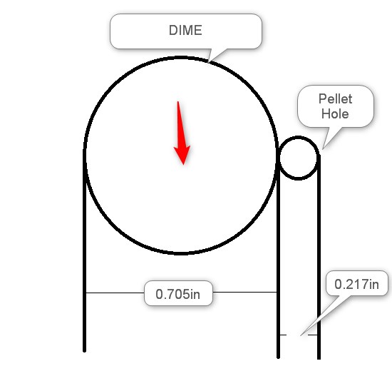

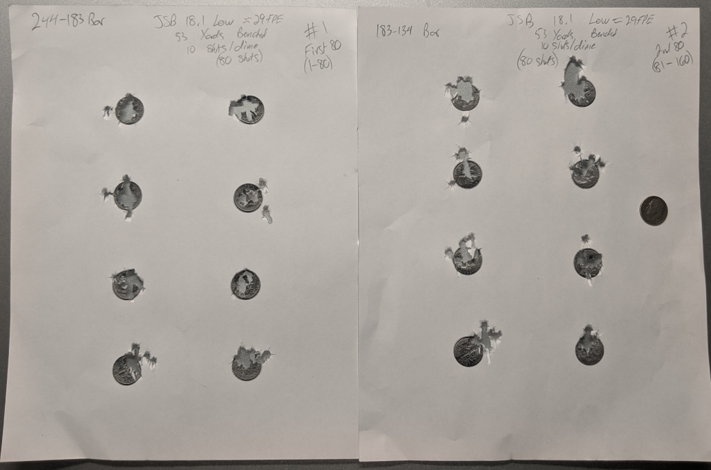

Being as this is a review of the Red Wolf, let's get back to that. Is the Red Wolf that I have been reviewing "accurate"? With this idea of some of the concepts of statistics in mind, I decided to analyze a recent shooting session with the gun. I took a bunch of statistics classes, but that was a decade ago and I’m pretty rusty, especially because the focus wasn't analysis of shooting results at the time. So, due to my lack of statistical analysis practice, I'll be stretching some of the concepts a bit here.
“Accuracy” in this little experiment is viewed as the ability to place the pellet on a dime-sized target. A dime measures 0.705 inches. A .22 pellet is usually somewhere around 0.217inches in diameter and makes a slightly smaller than that hole. For this analysis, I’m going to define accuracy as the ability to place a pellet within 0.461inches of where I want it to go. This visual might help illustrate my thoughts:
0.705 (diameter of dime) + 0.217 (diameter of pellet) = 0.922 / 2 = 0.461inches from center of dime, 360 degrees from the theoretical desired perfect shot/aim point).
I initially was hoping to keep them all WITHIN the confines of the edge of the dime, but I'm just not that good of a shot so had to settle for basically anything within or touching the dime. I believe the big long range benchrest comps like EBR are scored this way, cut the line and get the higher score.
The shots were taken on LOW with JSB 18.13, straight from the tin, about 29fpe. At 53 yards. Benched. The starting pressure was 244 bar and ending was 134. 160 consecutive shots, no sighters were taken at any time during the 160 shots. The shots were divided into 16, ten shot groups. Minimal winds: 5-7mph, right to left.
Aim points were the photocopied dimes target I made a few weeks back.
Here it is.
So much to potentially look at here.

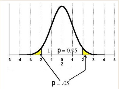

To be able to properly calculate a confidence interval, I would need a measurement of all the impact points, starting at 0 inches (dead center of dime) all the way up to 0.461 inches (outer edge of the point the pellet could hit and still cut the outer edge of the dime). That would allow me to calculate the confidence interval, which is really a measure of the dispersion within a data set. Think of it as a bell curve and envision sorted pellets. This was shared here on AGN (not by me) about 5 years ago and gives a good visual:
What we see there is essentially a bell curve. Whoever weighed those likely chose a window of what they considered "good" or rather, consistent pellets, which is the purpose of weighing, to exclude the outliers. The outliers residing in the outer edges of the curve, like this:
That diagram starts to get into using the confidence intervals to determine a confidence level, but that's another rabbit hole.......
Back to the 160 shots on that target above. I'm seeing somewhere between 15 and 25 shots that did not at least cut the outer edge of the dime. That bottom dime in the 3rd column messed up my data. I had been holding for wind and it got late enough in the evening the wind quit on me, so hold-off was no longer needed. It just took my stubborn self a full 10 shots to realize the wind had let up. Let's assume that group was centered on the dime and I've got 15/160 shots not touching the outer edge of the dime, ie within 0.461 inches from dead center of the dime. Let's call it 16 to make the math easier. 10% of the shots did not fit into my defined parameters of "accuracy." (If I throw that bottom dime in third column out completely, same result, 15 of 150 shots = 10% were outliers). Back to the pellet comparison. 10% of a 500 count tin of pellets would be 50 pellets. So, comparing this data to a sorted tin of pellets, only 50 of the pellets did not make the cut for "consis
tent", 450 did. Considering there was a human pulling that trigger for all of the 160 shots, really incredible show of accuracy from the Red Wolf. The outliers were shooter-induced.
This is not a cluster sample (cherry-picked). I didn't repeat this 160 shot experiment a bunch of times and pick the best one. I took these 160 shots ONE time and this is the result. No cluster sample, best the gun can do, out of 10 tries here. I simply shot 160 shots, one time, and these are the results.
Although I would like to take a closer look at a cluster sample within the data set. This is a close up of the third dime down, second column. Ten shots into that little group. Best 10 shot group of the 16, 10 shot groups right there.
My Nietzsche-like interpretation of all that...............pretty good evidence that the Red Wolf platform is capable of consistent "accuracy," however you like to define it.

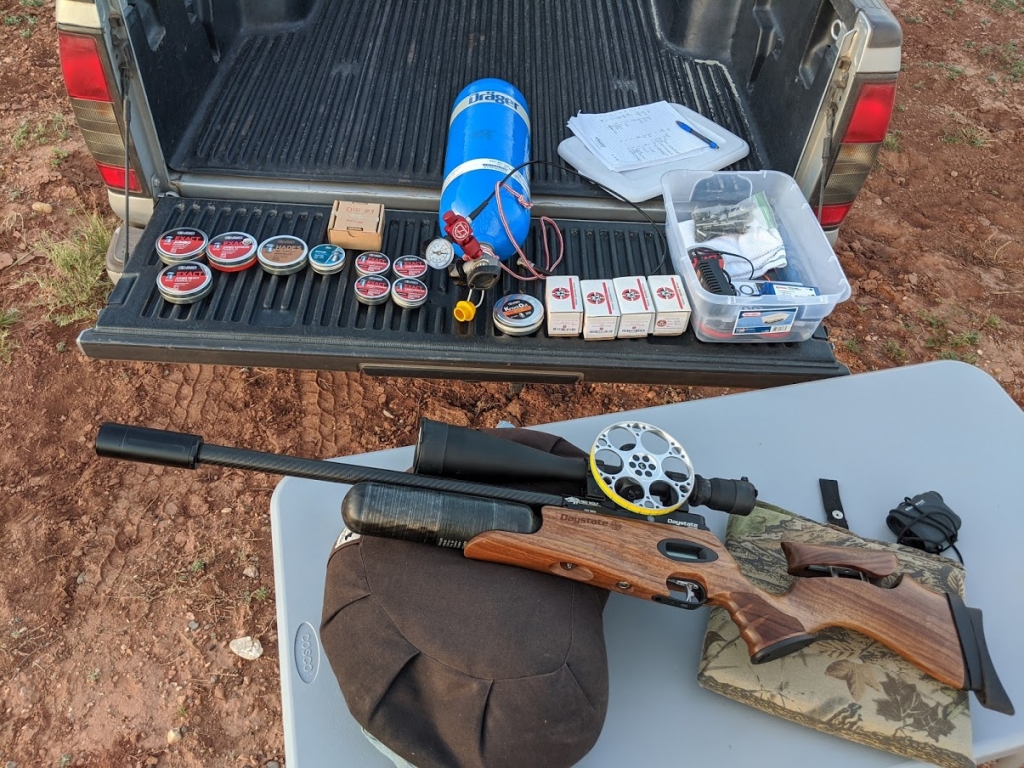

I had the chance to wake up early and go out on the ranch for some long-range fun a few days ago. Decided things worked out pretty well last time so went to the exact same place.
Sunrise
Setup

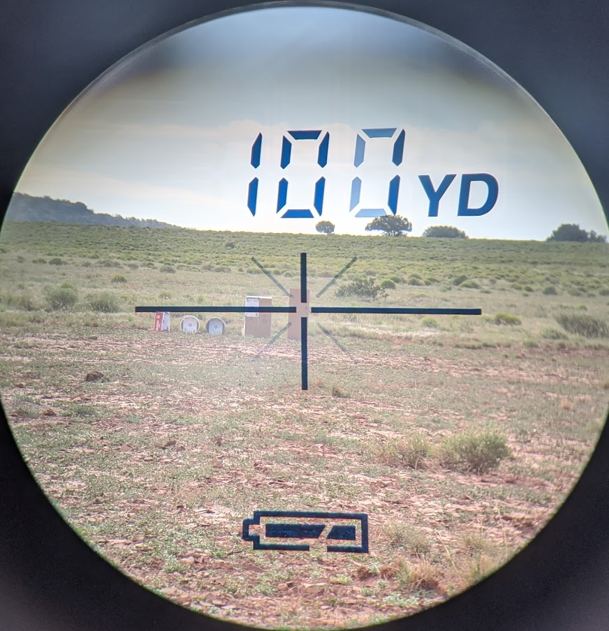

All shots from exactly 100 yards, lasered from shooting chair. Different than last time, I scrounged up an extra box to attach targets to.

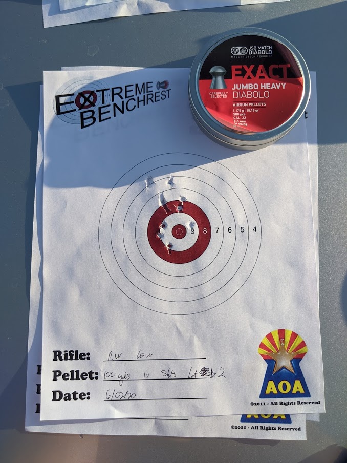

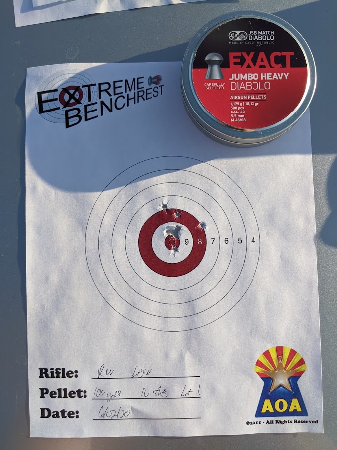

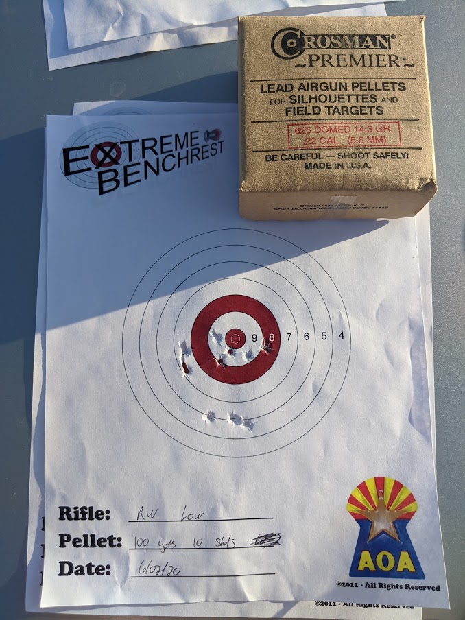

LOW power
I was really curious to see how it would do at 100 yards on LOW power with pellets. Around 29FPE. I also decided to stick to 10 shot groups this time.

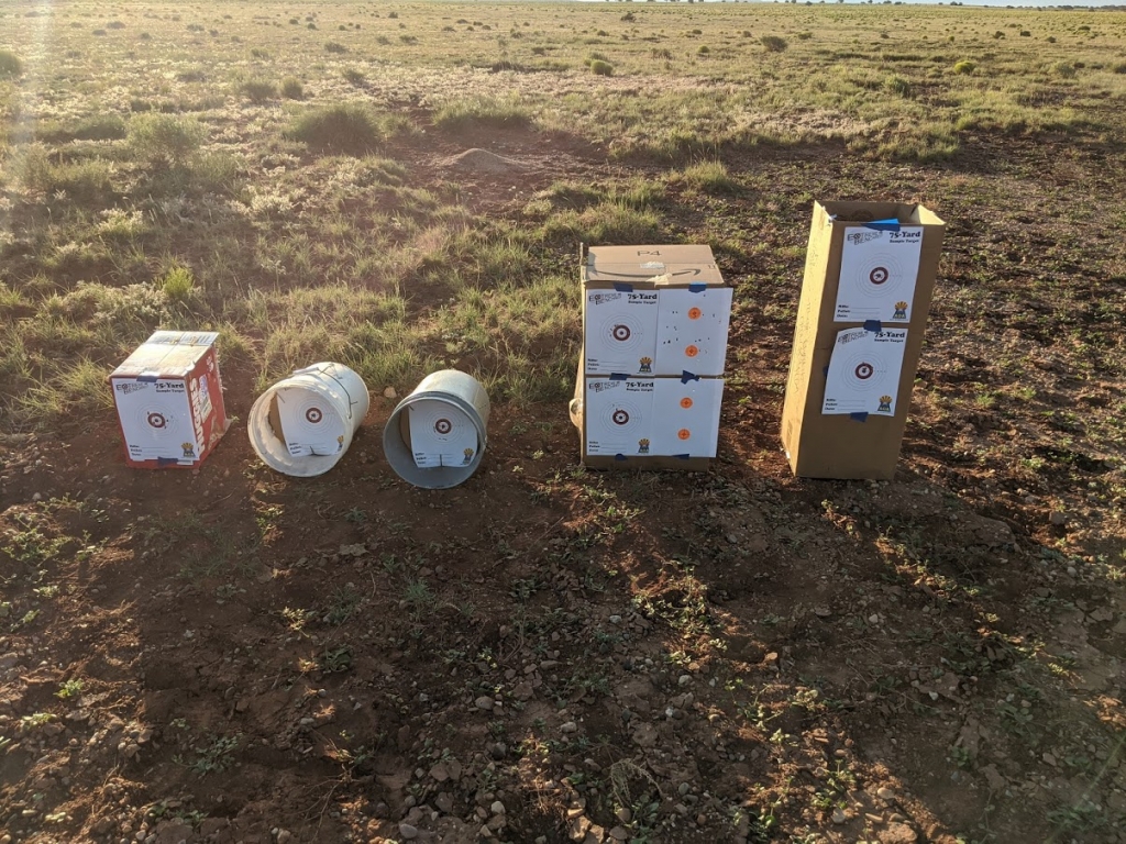

Walking up on all the LOW power shots. If you zoom in you can make out the holes and general shapes of the groups.
Starting on the left: Hades, non-Hades 15.89, CP, 18.13 lot 2/18.13 lot 2, orange dots are sighters, and then 18.13 lot1/18.13 lot1 on the far right

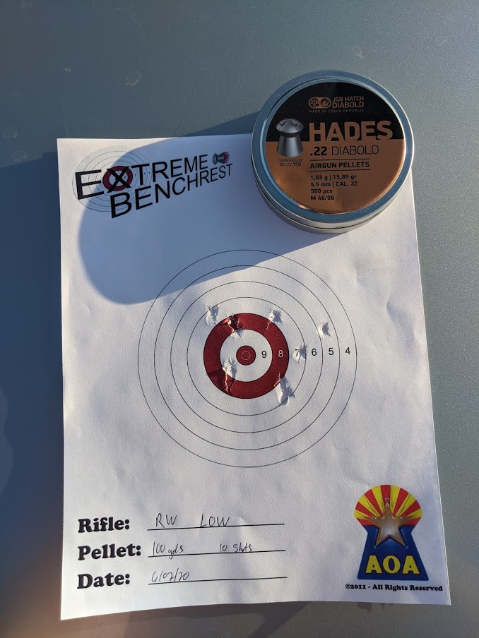

Hades
These really wanted to open up at 100 yards. They just seemed like they were floating away from the point of aim.
Non-Hades 15.89

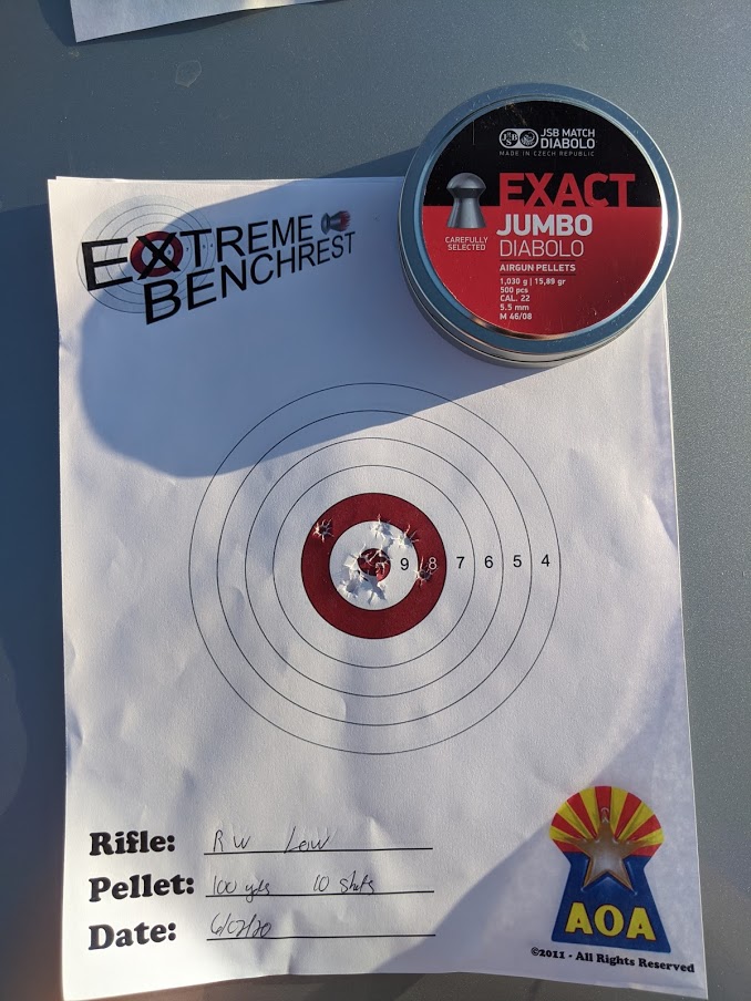

One of the high points of the morning. This group really shocked me. There's one outlier, high and left that increased the group size, but I think I've got 1 eight, 4 nines, and 5 tens. I'll take some more of that ANY TIME. Group size = 1.528.
Crosman Premier classics from 1999
Had a couple hit low

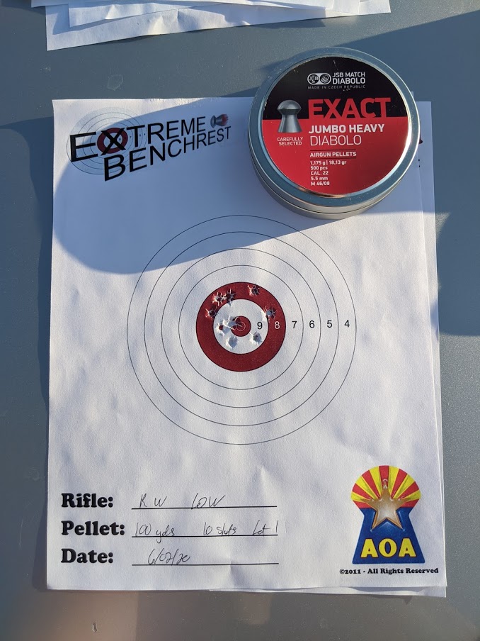

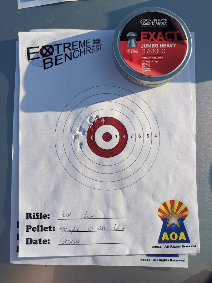

18.13 Lot 2
Two ten shot groups here, not as good as the 18.13 lot 1 groups

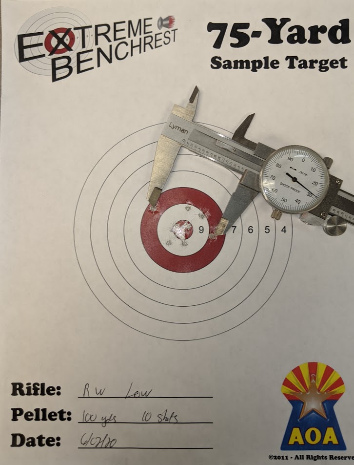

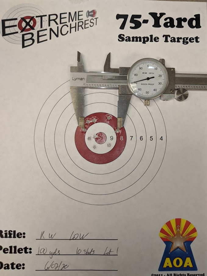

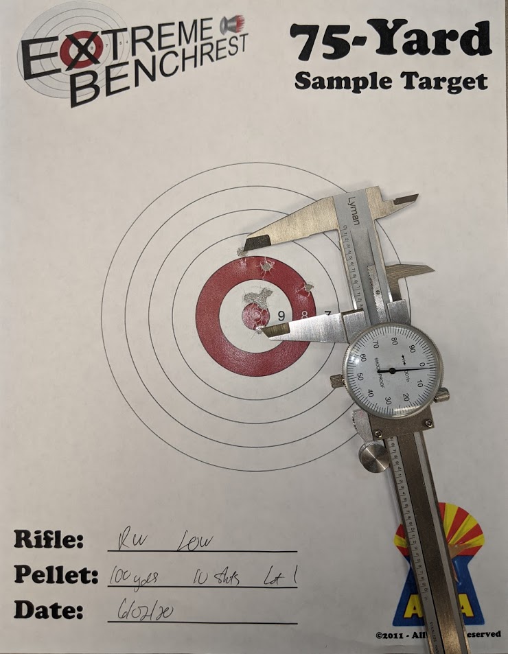

18.13 Lot 1
The better performing lot at this distance, Group = 1.302 inches and 1.271 inches.

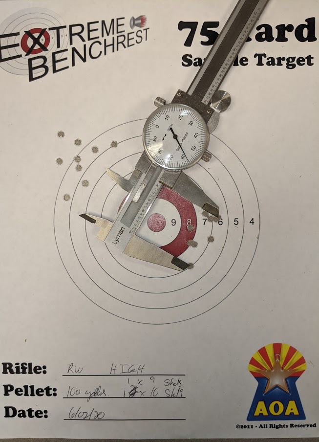

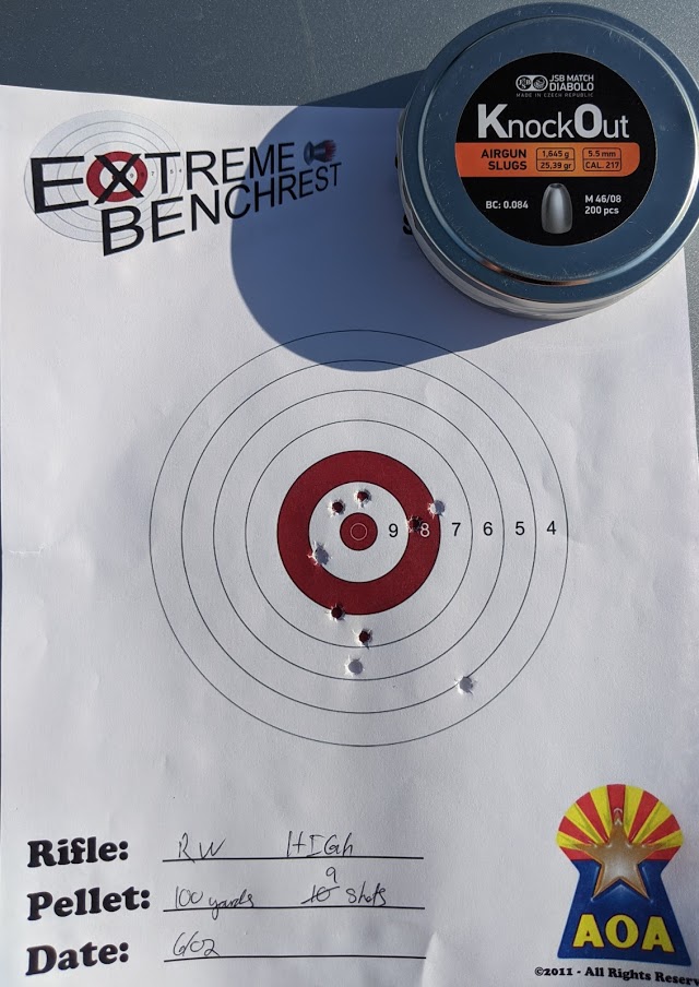

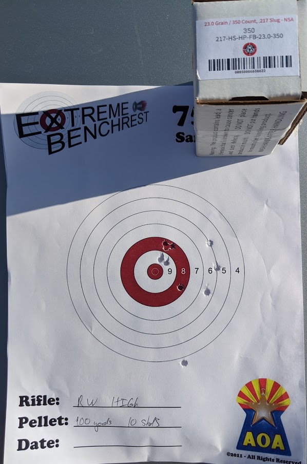

HIGH power
I already feel like I have a pretty good expectation of what it can do at 100 with the JSB 25.39 RDs, so stuck with slugs this morning. Also 10 shot groups.
JSB knock outs
Same problem as before, loose and tight fit = large vertical spread

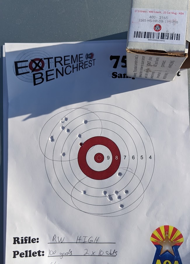

NSA 23grain
NSA 17.5gr
Two, ten shot groups here. (Just gave it a couple clicks different for each group -seeing how it would group rather than trying to place them in the center of the bull).

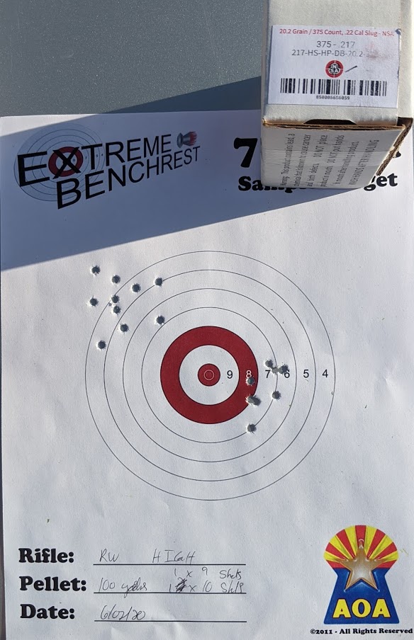

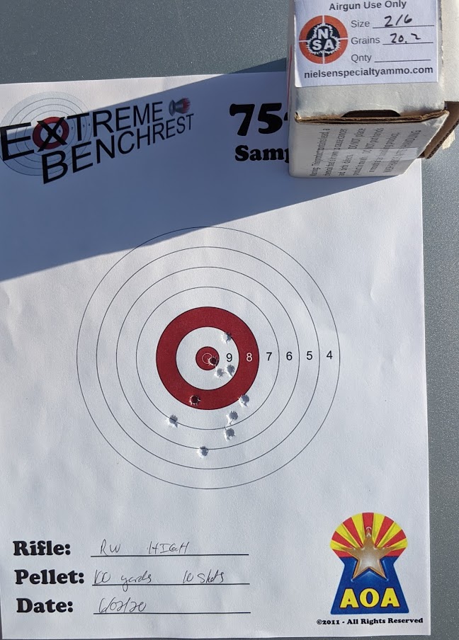

NSA 20.2, 0.217 size
These are the best slug I've tested out of this RW. Same thing as before, shooting for grouping, not placement. Groups measured 1.358 and 1.782 here.

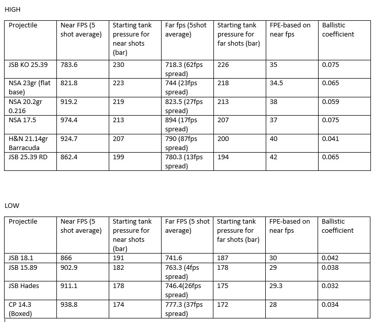

Ballistic coefficient of various projectiles
For a long time in my airgunning journey, I incorrectly thought that a BC was a concrete, set in stone value for each flavor of pellet. I was blissfully unaware of the fact that BC's change with speed, air density, projectile, elevation, and from one brand to the next of the same design and weight of pellets. Even barrel features like chokes and twist rates and rifling profiles can effect the BC. Since that realization, I have been keenly fascinated with the concept of a ballistic coefficient. The overly simplified view of the concept that makes the most sense for my thought process, is that the BC is simply a measure of the slipperiness of the pellet. In other words, a numeric value that specifies how much or how little the pellet is slowed down by the air molecules it passes through on its flight path. For anybody interested in accuracy, even a minimal understanding (like mine) of the concept of BC opens up a whole can of worms. The most obvious is that the rainbow of trajectory is going to be affected, making the projectiles impact higher or lower. The less subtle is that a good BC projectile will get pushed left or right less in a crosswind than one with a poor BC. For myself, who finds the physics of launching projectiles with compressed air one of the coolest aspects of airgunning, the idea represented by the BC is utterly fascinating.
In an earlier post I noted that the JSB 14.35 at 20fpe from the Red Wolf was producing a BC of 0.044. That was at my home elevation of 5600 feet above sea level. This was taken using an average of near fps and far fps and plugged into one of the various BC calculators available online. It was surprisingly (and kinda unbelievably) high, but it also matched up to the 10-55 yard dope I figured the hard way (shooting at actual targets at all those distances). I was hoping to be able to confirm it with Arzrover's LabRadar at some point. Well, he brought it along to the field target match we had north of Phoenix a few weeks ago and we had a chance to shoot those same pellets past the LabRadar's sensor. The location is at about 1700 feet above sea level, so I expected a lower BC just from the thicker air. The fps was about 20fps slower than I measured at home, which made sense for needing to give it a couple extra clicks for the far FT targets during the match. Near fps was 773 and far was 648 (50yards). That makes the BC at 1700ft, as captured by the LabRadar, 0.0347, so 0.035. Again, pretty high compared to values that can be found online for the JSB 14.35.

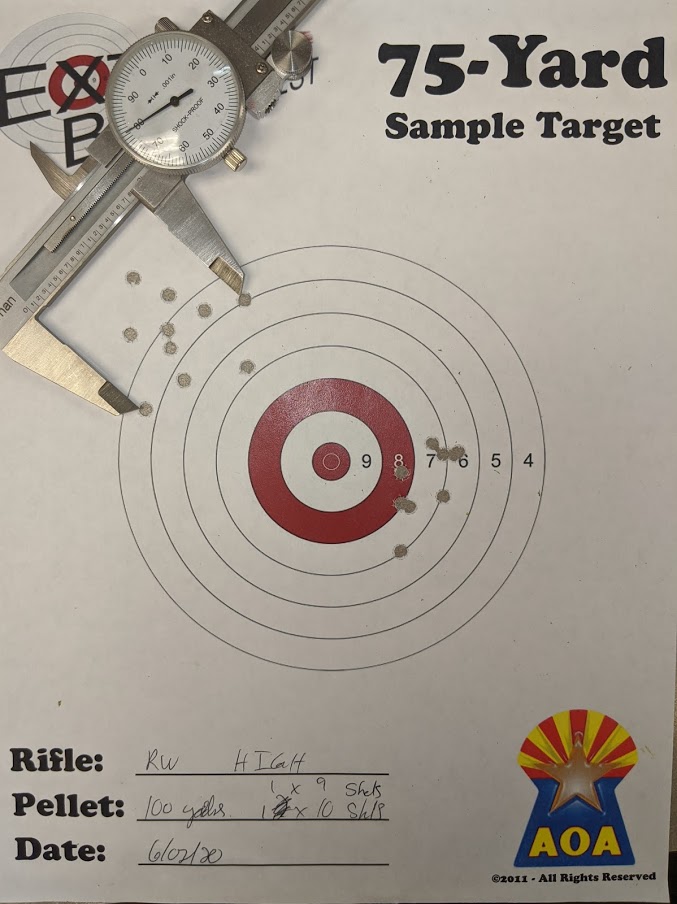

Switching gears a little, the Red Wolf experience has sparked an interest in 100 yard paper shooting that I previously did not have. I'd wanted to do some additional BC gathering with it all along, but after the 2nd shooting session at 100yds (previous post) I was very curious to see what kind of BCs the RW was getting on HIGH and LOW powers.
As a disclaimer, I'm using a less than ideal method. The general approach was 5 shots at the muzzle, and then 5 shots at 53 yards. the average near and average far fps is what went into the BC calculator. I tried to use a similar starting pressure in the tank for the near and far shots taken with each projectile, to minimize any variation from a drastically different tank pressure. Also, the high elevation will make my BCs slightly better up here in the thin air than lots of the literature values found online, either posted by individuals, or in places like the HAM BC database.
A further limitation to my method was that some of the projectiles had a very large fps variation in the 5 shots taken at far distance. And that's where it gets interesting. Those large fps variations weren't seen for the 5 shots with the near fps. Most of the ESs over the 5 near shots were under 12fps, I didn't record it because I shot all the near shots first, and then all of the far shots. A trend appeared when I started collecting the far fps averages, in that the pellets/slugs with the largest 5 shot spreads were also the pellets/slugs with the largest 100 yard groups. Had I not started with the JSB KO's I may not have picked up on this (they had the worst spread). My hypothesis is that something is happening to those pellets somewhere between the muzzle and 53 yards that makes them lose speed much quicker than their tin-mates. Of course, that is going to lead to low impact points, and it's only going to get worse as distance increases. Since these are all non-weighed and non-sorted pellets and slugs, it would be interesting to see if some of that downrange fps variation could be reduced through pellet sorting. So, I don't know the why, but the result is surely evident on paper. Whether it's a defect, or an off-balance projectile, I just dunno. But whatever it is, completely fascinating. And if someone can figure out how to minimize it (assuming it's not caused by something as simple as being unsorted), they're going to be at an advantage in long range paper comps like EBR, RMAC, and PA Cup.
So, here it is:
(I'm fully aware that a lot of the BCs here are quite high. FPS loss is the primary factor taken into account by these BC calculators. If the values are as small as 5 or 10fps off, the calculated BC can be inflated. So, take these with a grain of salt. This is the actual data collected, but keep in mind the limitations listed earlier.)
It seems like common sense, that projectiles with a larger extreme spread will have more pellets moving slowly, and therefore impacting low. But it was much more reinforcing to visually see what it can do to group sizes. For example, the two projectiles with the larges far fps spreads were the JSB KOS, and the CP14.3 boxed from 1999, back when they were good pellets. So, go back in my last post to see what I saw. With the KOs there are four low impacting pellets out of 10 shots. If those had been moving at a consistent fps to the other six, the group would not have been too bad. Similar results with the CP, 3 low impacting pellets out of 10. If those three hadn't hit low, would have a VERY good 100 yard ten shot group.
The opposite trend can be seen too. One of the very best 100 yard, 10 shot groups of the morning was with the JSB 15.89 on low. It had an fps spread of 4 over 5 shots at 53 yards. This was the pellet that made a group with one 1 eight, 4 nines, and 5 tens. And that was with 30 fpe at 100 yards!!!
So, there definitely seems to be something there with the low impacting pellets being caused by variations in fps.
Final thoughts on BC
