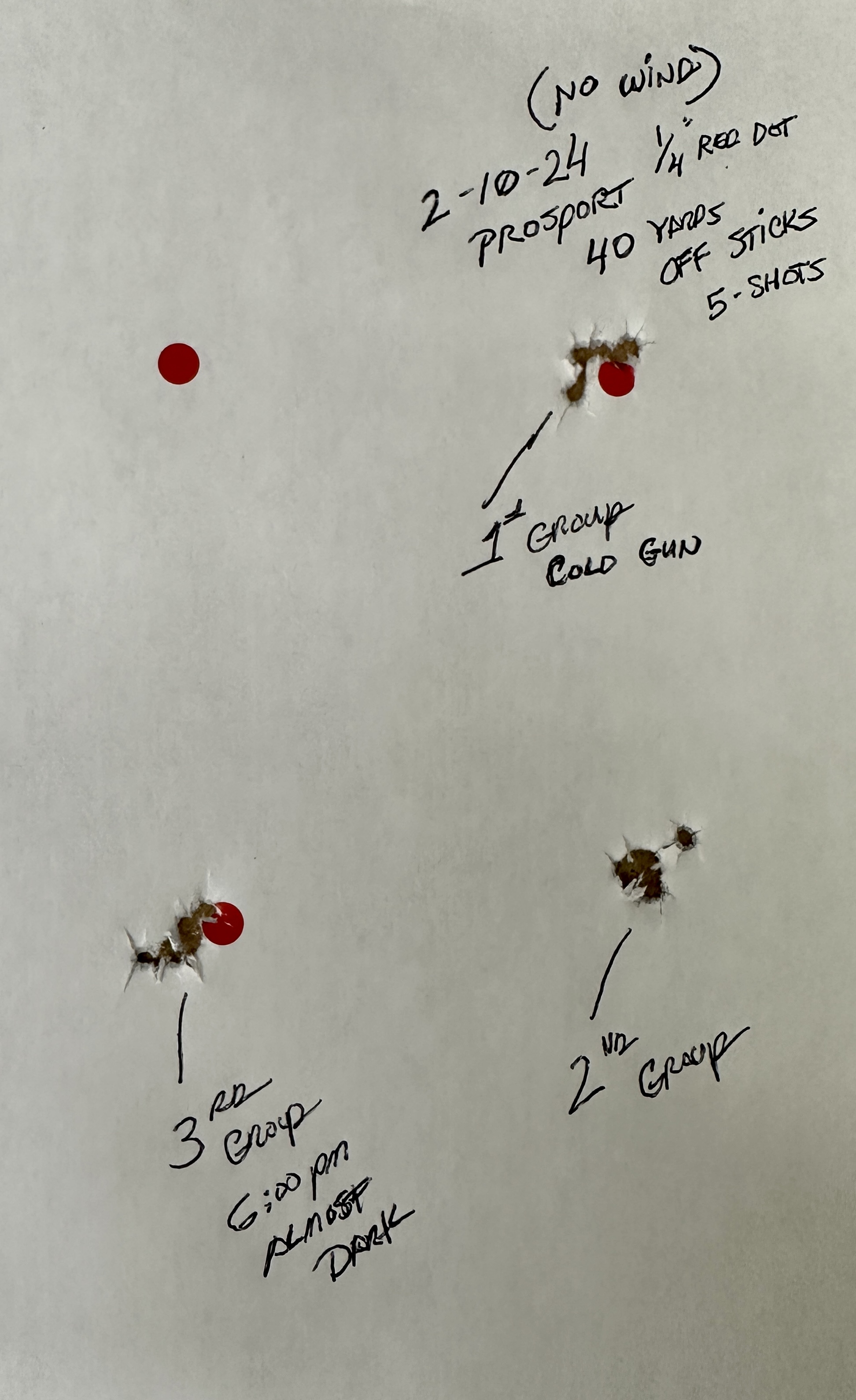

Here's the best I've done with mine at 40 yards shooting off of cross sticks and a little stool. These are only 5-shot groups, but 10 wouldn't have been much bigger, shot with the QYS 8.48 pellet. The red dots are a 1/4" diameter for reference.
1.0" at 50 yards is great accuracy for sure. But still, there might be a better pellet yet? I haven't really tested it off a bench resting on bags yet, just shooting sticks. The prosport and the 97K are my favorite piston guns.
