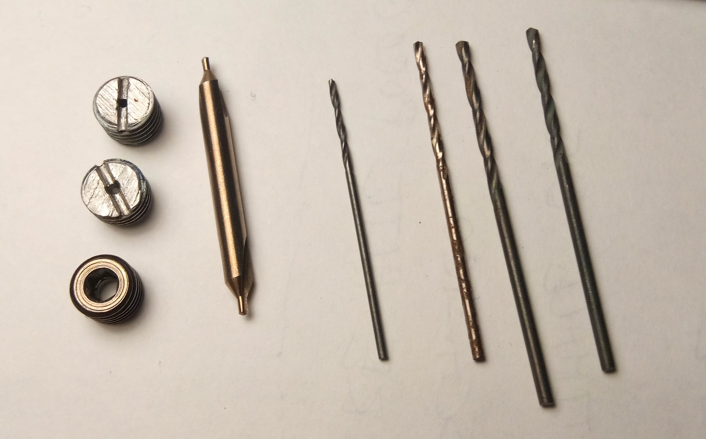

I have a RTI Priest2 4,5/.177 in low power configuration, <5.5ftlbs/7,5Joule, with the original fixed 125bar regulator.
I have a Competition Electronics Procrono DLX and I found the right diameter of the reduction on the transfer port by testing different diameters for the hole(in my case about 1,1mm).
In my case, the Priest2, is difficult to find the proper M7 screw and, before having some from RTI to be drilled, I made some by myself using a more common Vespa M7 bolt.
In the picture there is the RTI 24Joule reduction for 4,5mm and a couple of mine.

The priest is 6mm TP. Easy to find a grub screw.
Prophet is 7mm and P2 and 3 are 8mm .
Reactions: elbeau

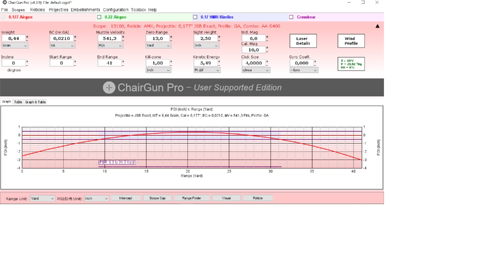

I confirm that on my Priest2 I got new last summer there is a 7mm reduction.
I sent an email to RTI and they sent me back some of those to make more elegant that the ones I made from a 7mm Piaggio Vespa bolt.
I agree that a better way to have a proper reduction is to play with the regulator and hammer and spring, maybe as I'll have to do more deep rebuild or a regulator and bottle upgrade...
I suggest to have a look at Chairgun to see how a low power setup helps to have a better kill zone in short distances as for ratting.
