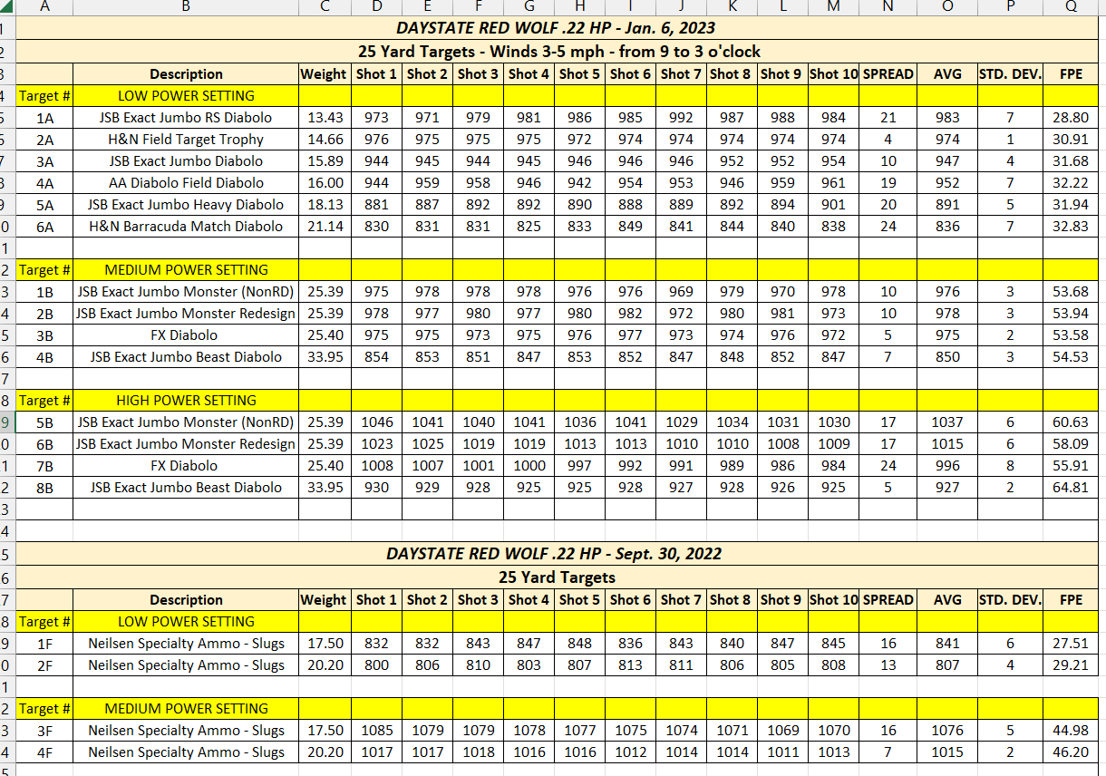

Over the last few months I've been bitten by the bug to see what all the different pellets I have sitting around here at the house will do in the RW so I made up a simple Excel sheet to track 10 shot groups of each of "my" pellets through "my" gun. I didn't create it with the intention of getting it out there in front of everyone, I just wanted some general baseline info of average speed, etc. to see how things worked, patterened, etc. for my own info.
This is my rig:
  • Red Wolf .22 cal HP
  • Purchased new Nov. 2021 from AOA
  • Has had no tuning since I purchased it. As far as I know it's "straight outta' the box".
  • I don't know what version board is in it but it has the 11.1 volt battery if that helps.
  • This is NOT intended to suggest to everyone what YOUR gun will do. It's just what MY gun is doing at the particular date & time.
Here goes:

The 11.1 volt battery was put in the Gen 2's along with hardened hammer. IIRC.
Do you have any accuracy data along with the spread sheet? Did some do really we and the other not so much?

Great info SAZ! Thanks.

This is for my particular gun - GC2 board and as received (used) from AoA:
Red Wolf HP .22 GC2
HIMIDLOW
JSB 25.39 RD1044984890
Shooten' em faster than I normally do, at the 'mid' setting, has worked well for me out to 100 yards, but I haven't taken it any further.

Finally found some time to chrono my RW today. .22 JSB 25.4 redesigns are averaging at 1000 on high, 970 on mid, and 843 on low. I will be heading to the range Friday to see what it can do and try to get it reasonably dialed in for a XFT match on Saturday. I am hoping the mid power shooting the MRDs at 970 turns out to be a good tune for this RW at the 50 to 100 yard distances.
