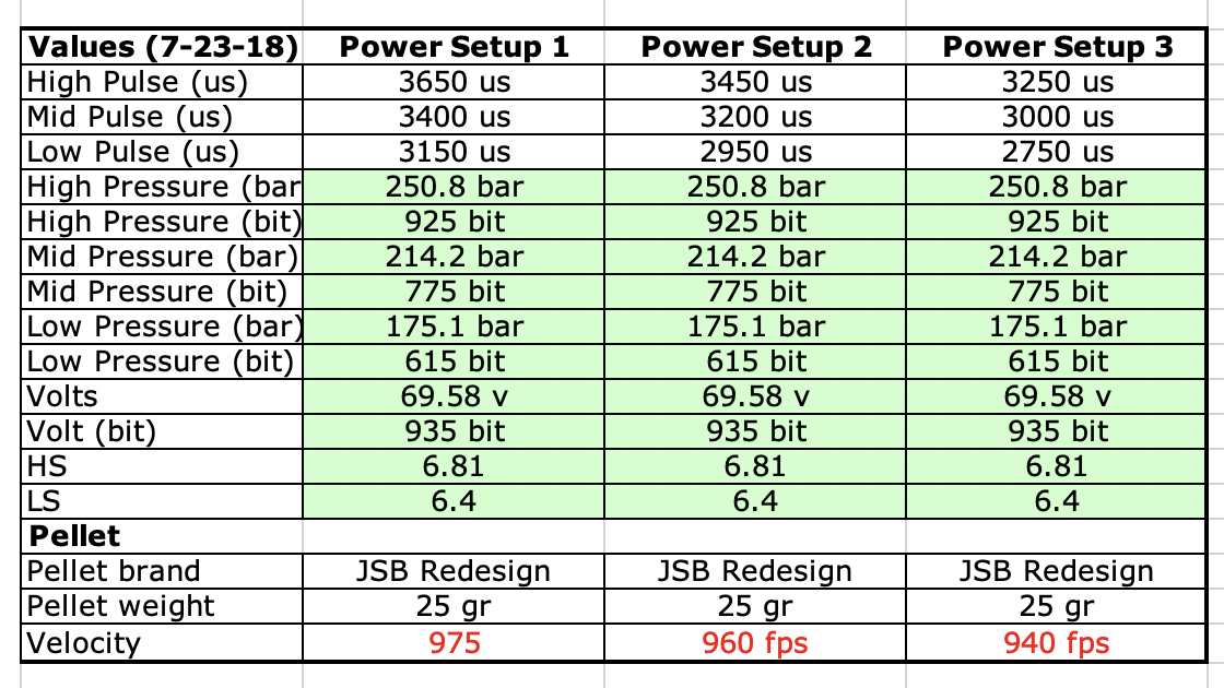

Attached is a spreadsheet to help keep track of your changes
View attachment My Red Wolf.xlsx
