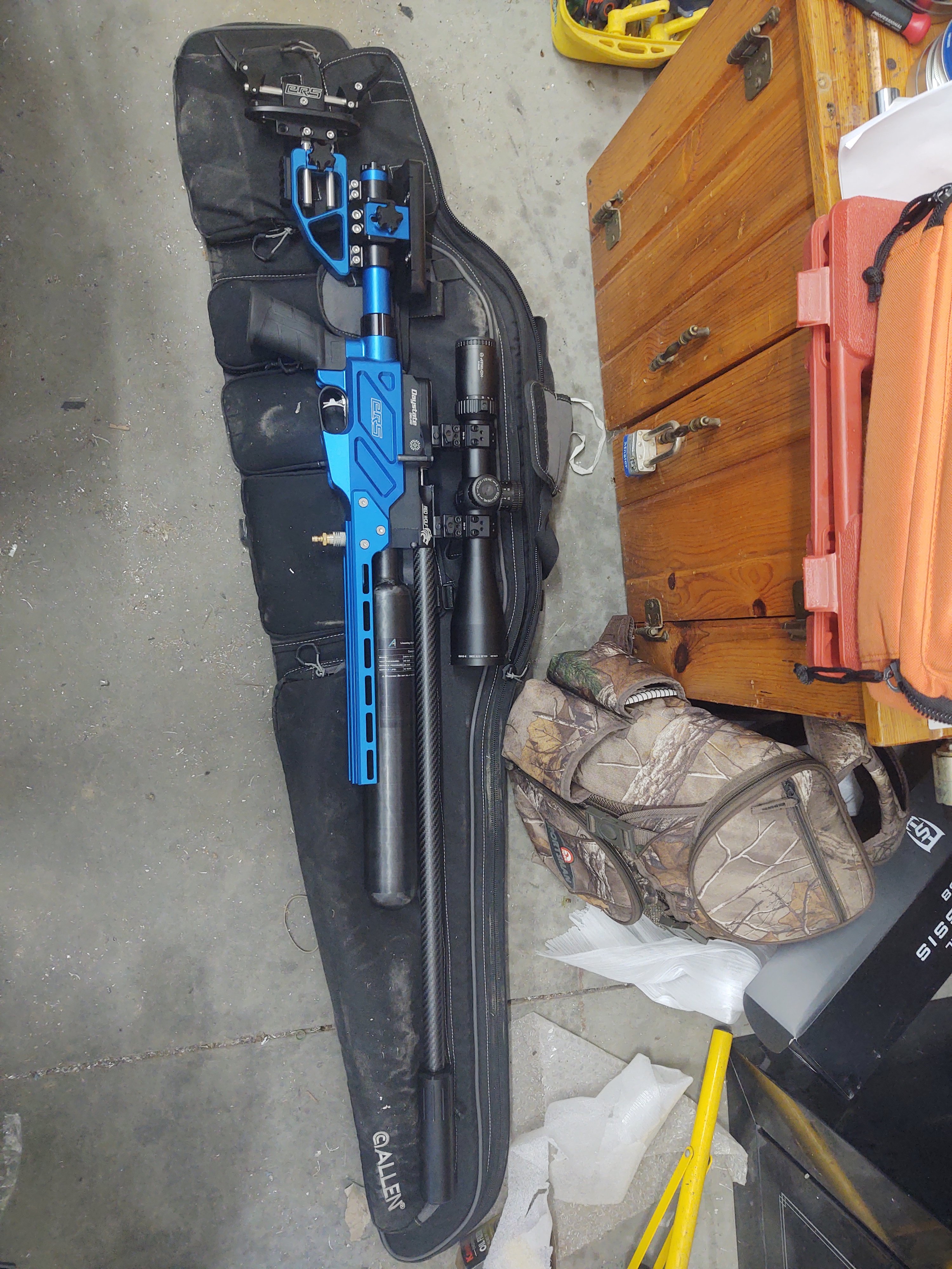

This morning I took the scope off - It was tight. Took the barrel out and removed the shroud, Barrel was tight. Got out the cleaning fluid, some patches and my new Carbon cleaning rod and some patches. Well the new rod wouldn't enter the breech with a patch, grab old brass one and start the process.
OMG - It was disgusting.
I didn't think it was that bad, so about 2 hours later to get clean patches through I was done. Ended up using a brass brush about 1 hour into it to scrub it a little. Finished up with wet patches with cleaning solution and a bunch of dry patches.

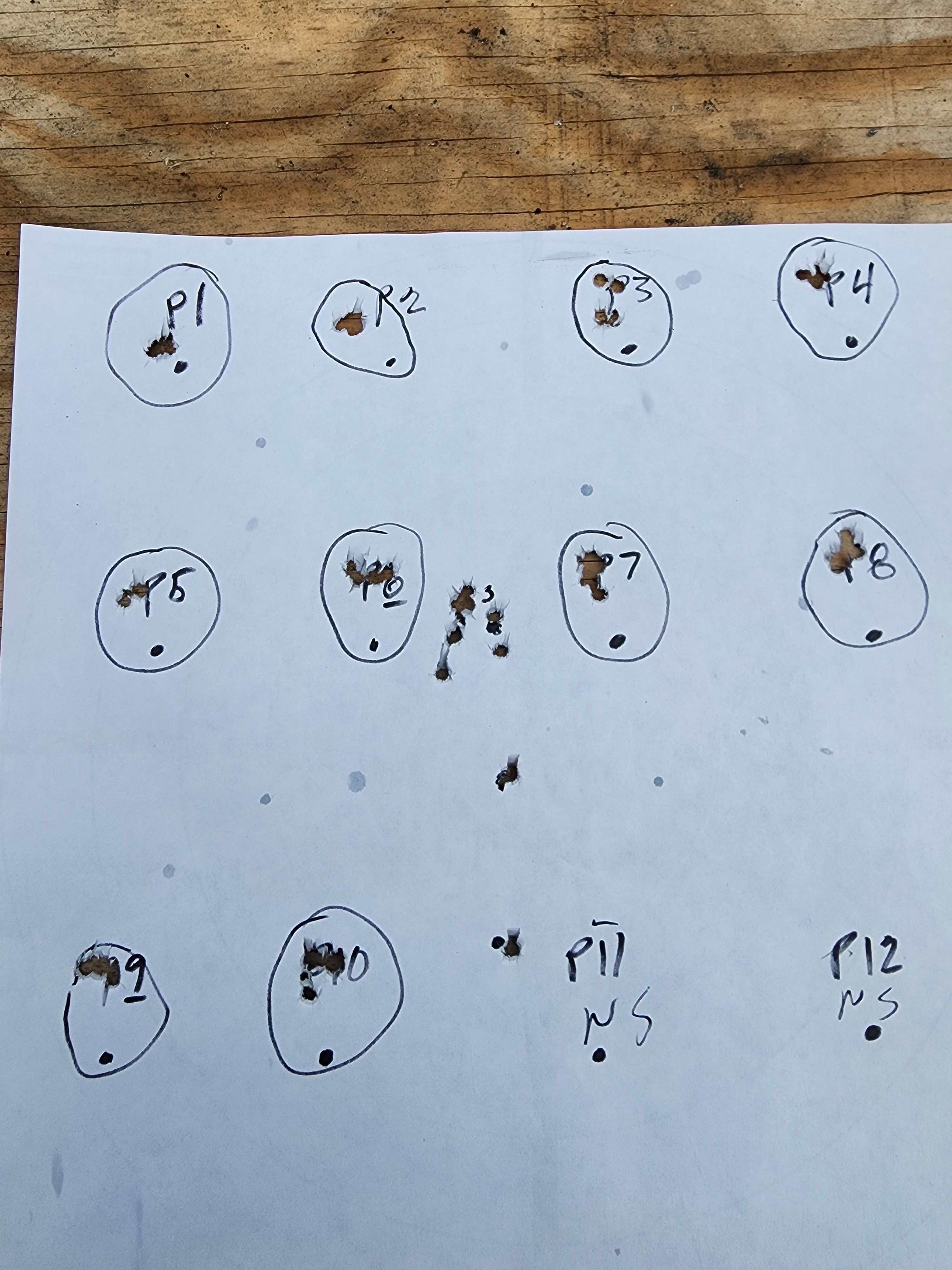

Lubed up all the o-rings for the shroud and barrel and re-installed it. Set the scope back on and moved it about to where it was. Took out the LabRadar, Shooting Table, etc. etc. I set the LabRadar to Low Power instead of Normal, get it aimed as best I could. Instead of starting at Power Level 12, I started at Power Level 1.

Also found the PRS Rail/BiPod mount was loose.
Well that's much better, Power Level 2 was 4 pellets in the hole, the one just outside was me. Power Level 5 was used to set the scope after moving it. The lower power setting on LabRadar captured all the shots. I also used the Single Shot Tray for all of the shots.
Thanks for all the suggestions, looks like a dirty barrel and a loose mount can make you loose it all.
