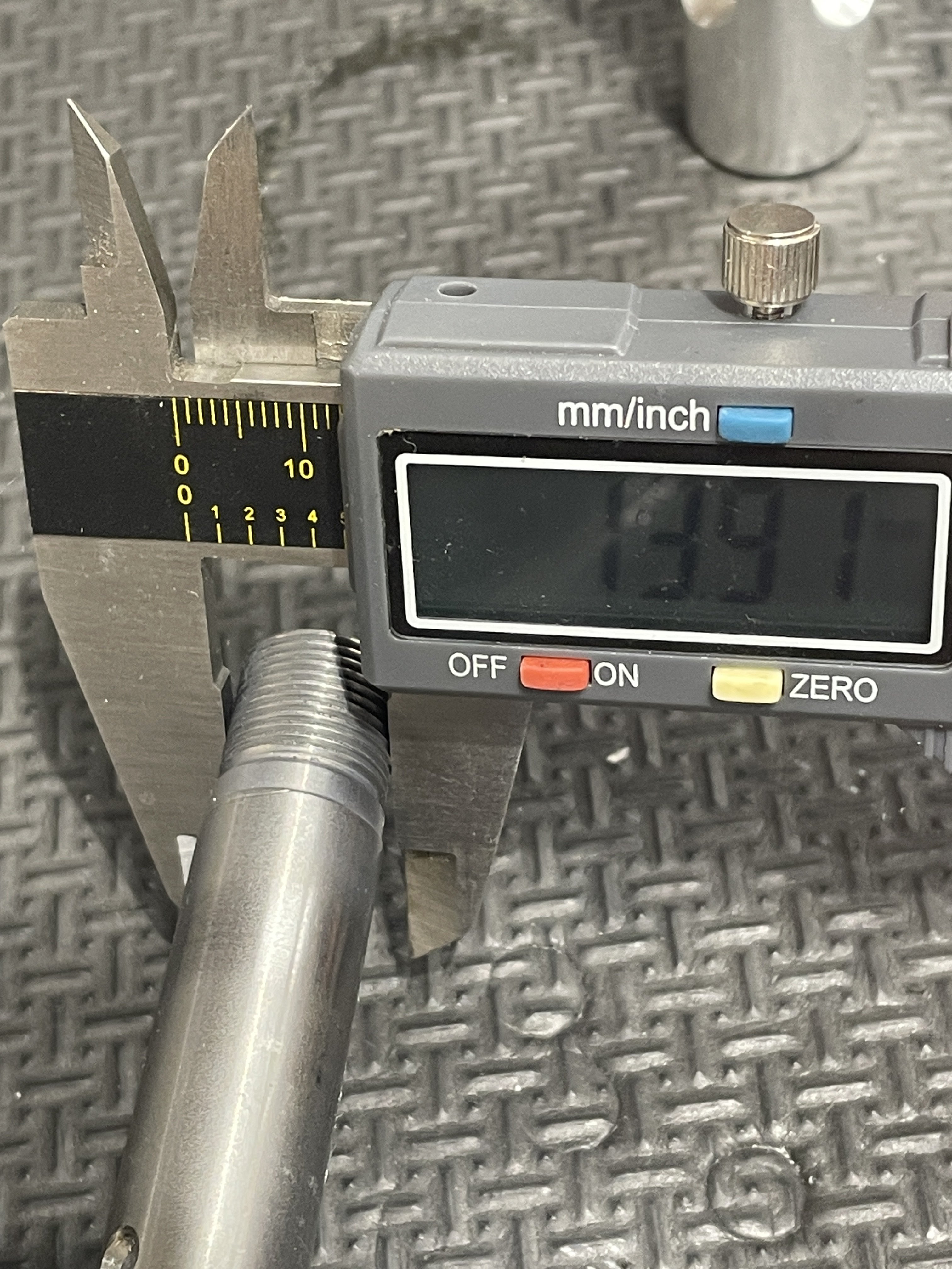

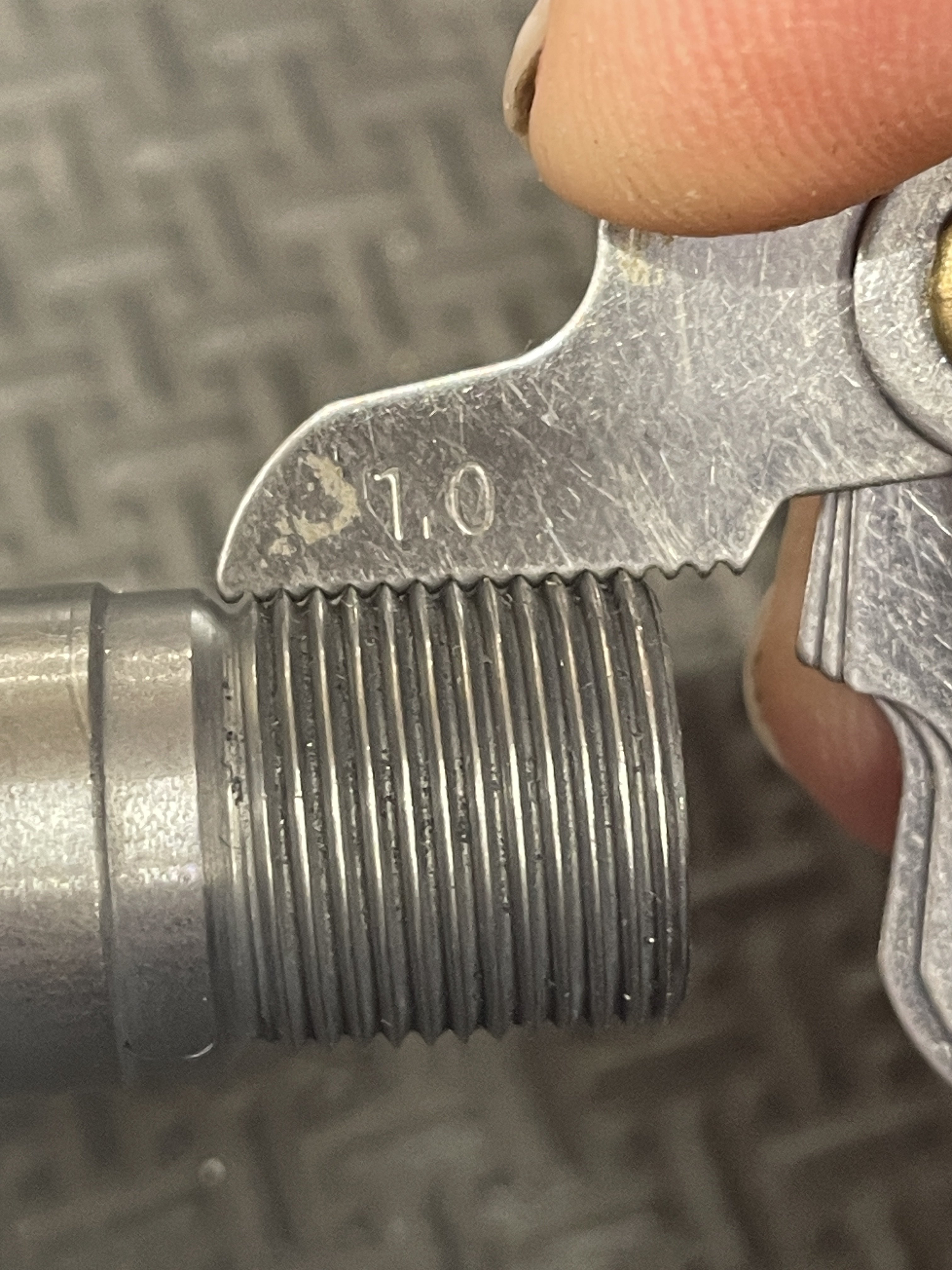

Does anyone know what the threads are on a Redwolf barrel? I am not looking for the 1/2-20 threads on the shroud but the actual barrel itself?
Do you mean barrel twist? There is no other threads on a RW barrel.Does anyone know what the threads are on a Redwolf barrel? I am not looking for the 1/2-20 threads on the shroud but the actual barrel itself?

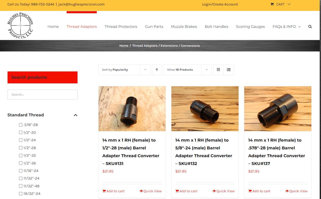

I considered that but it is so accurate currently I wouldn't want to do anything permanent. This is just an experiment. If it works, great if not, no harm no foul, back to the current configuration.You can always have that thread turned down to 1/2 inch unf there is room for it I know its been done.
