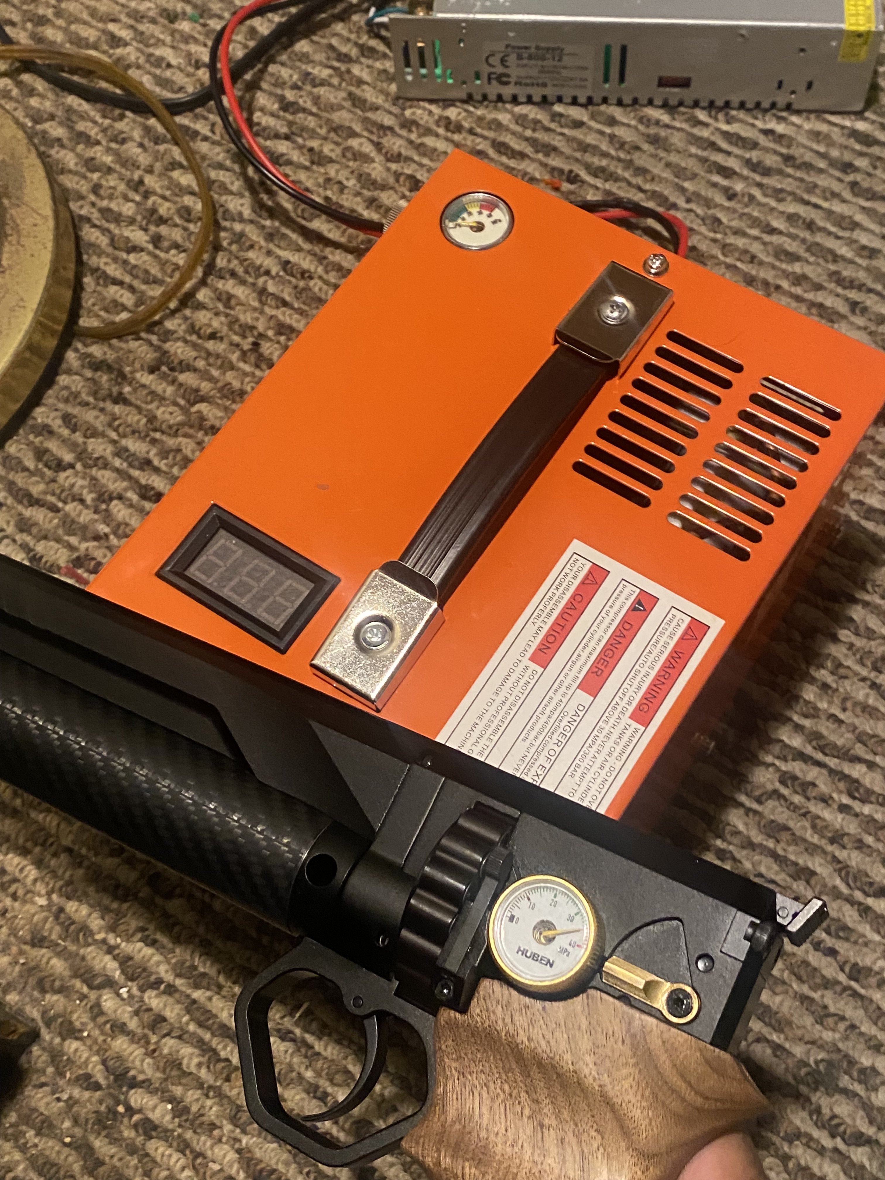

Is rated for 4500 but filling the huben?I know this is an old thread but I am shocked that this little Chinese compressor actually filled my gk1 to 5000psi! View attachment 521832
