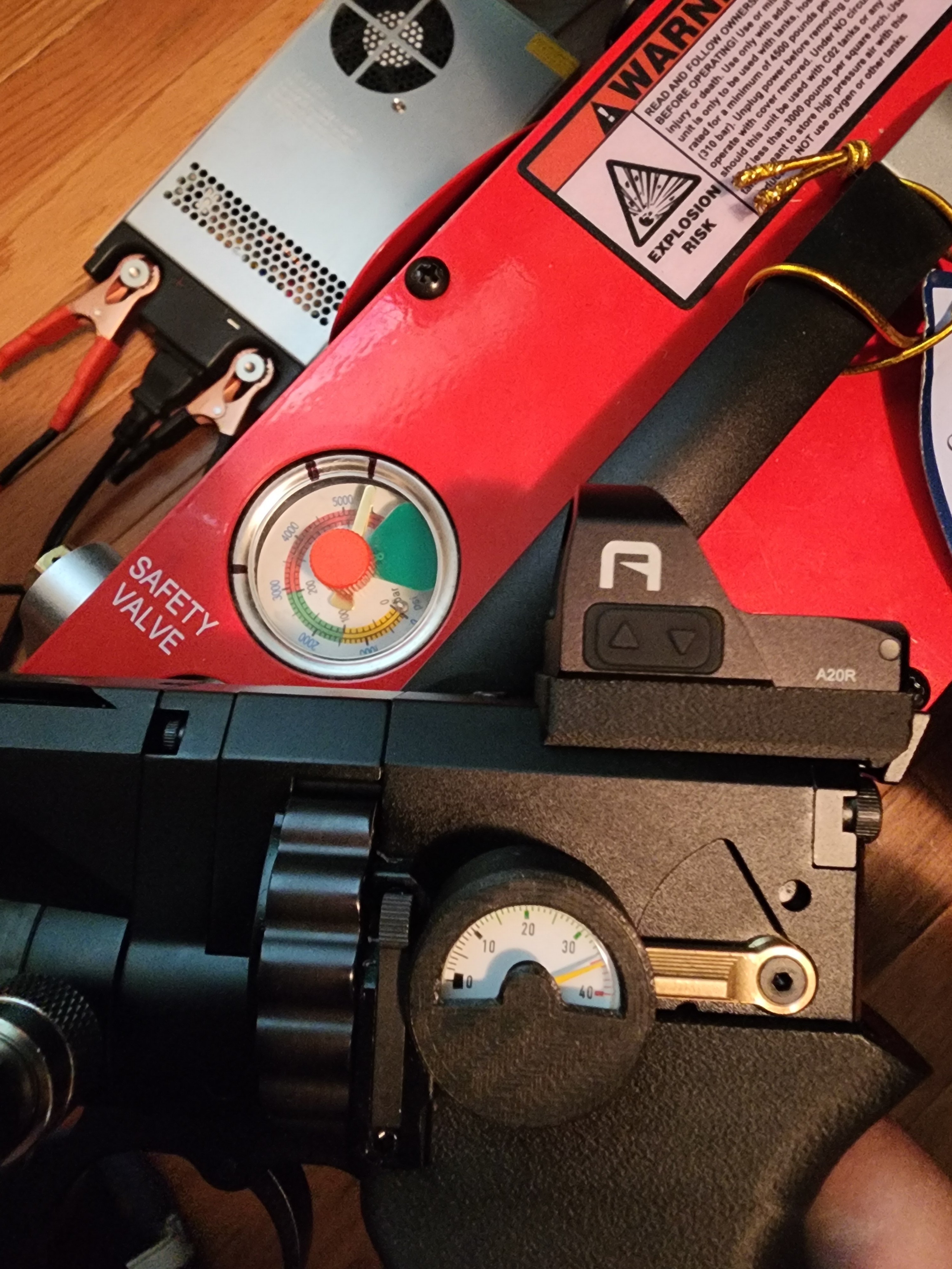

Yeah it’s supposed to be up to 4500psi. But I filled my huben gk1 just fine. The gauge did go into the red for like 1-1.5 mins but it filled it past 35mpa which is a little over 5000 psi. I usually never let my compressor heat past like 42 degrees though. From now on I will probably only fill to 30mpa just to be on the safe side though. But yeah I was surprised!
