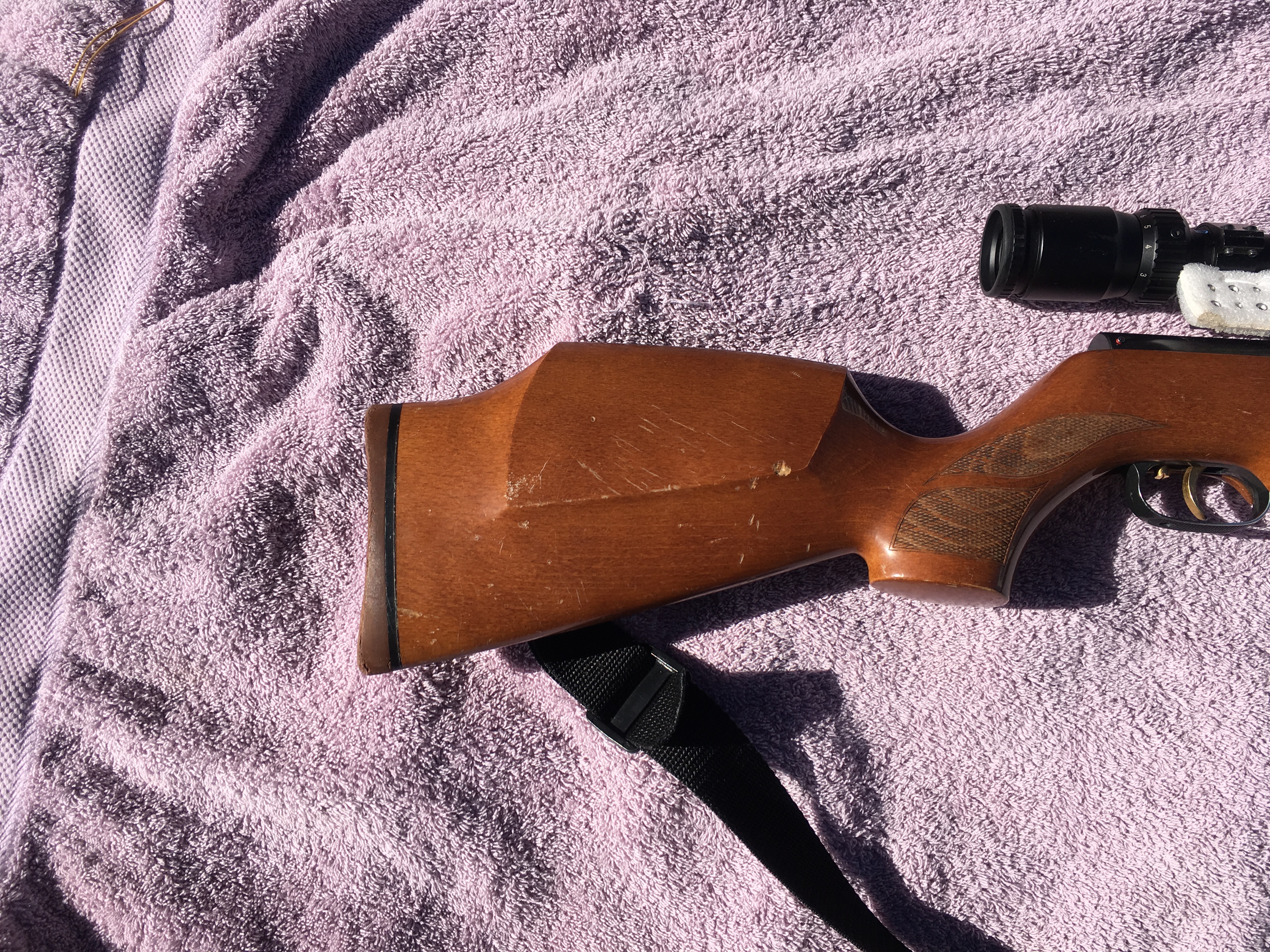

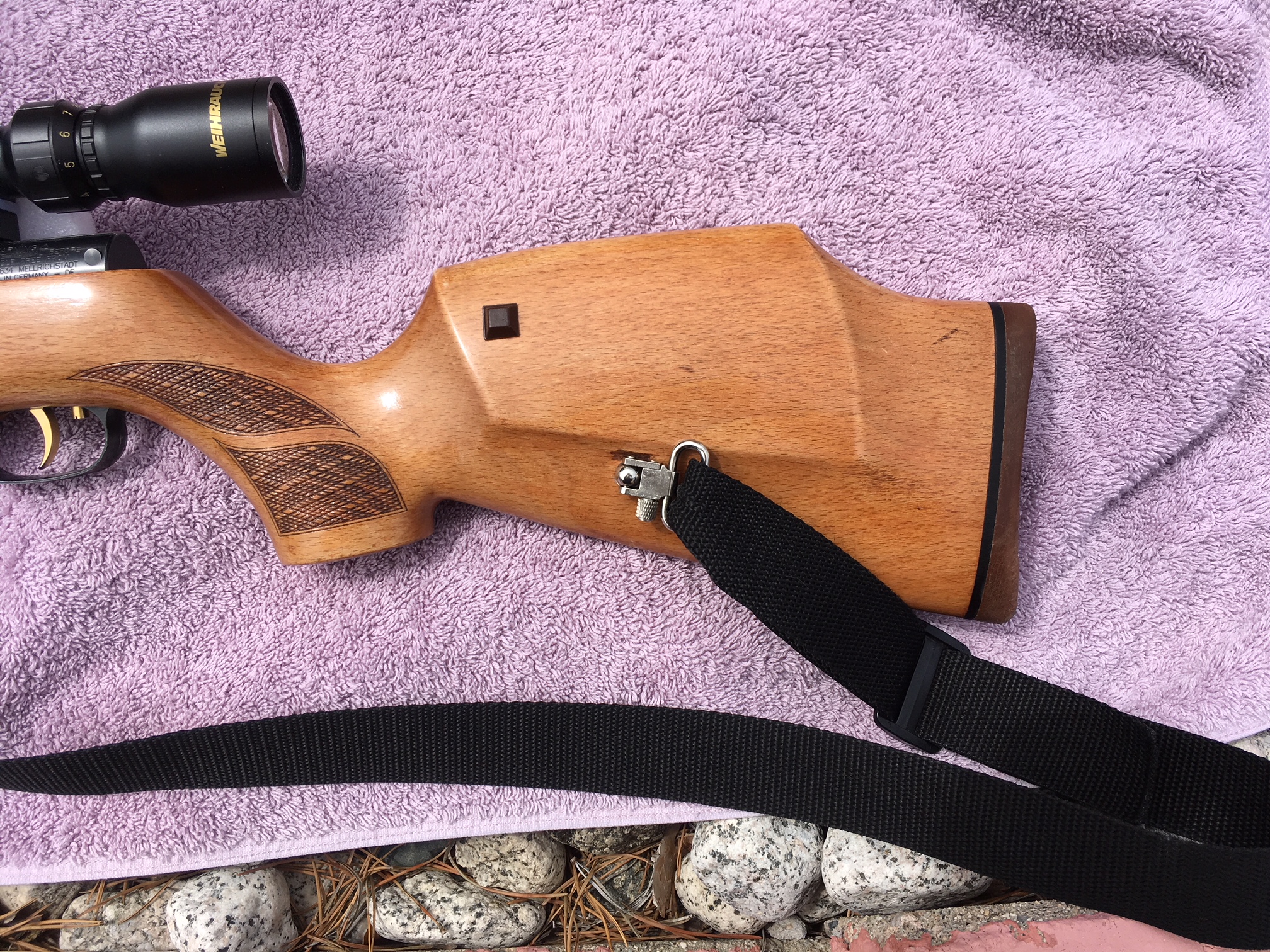

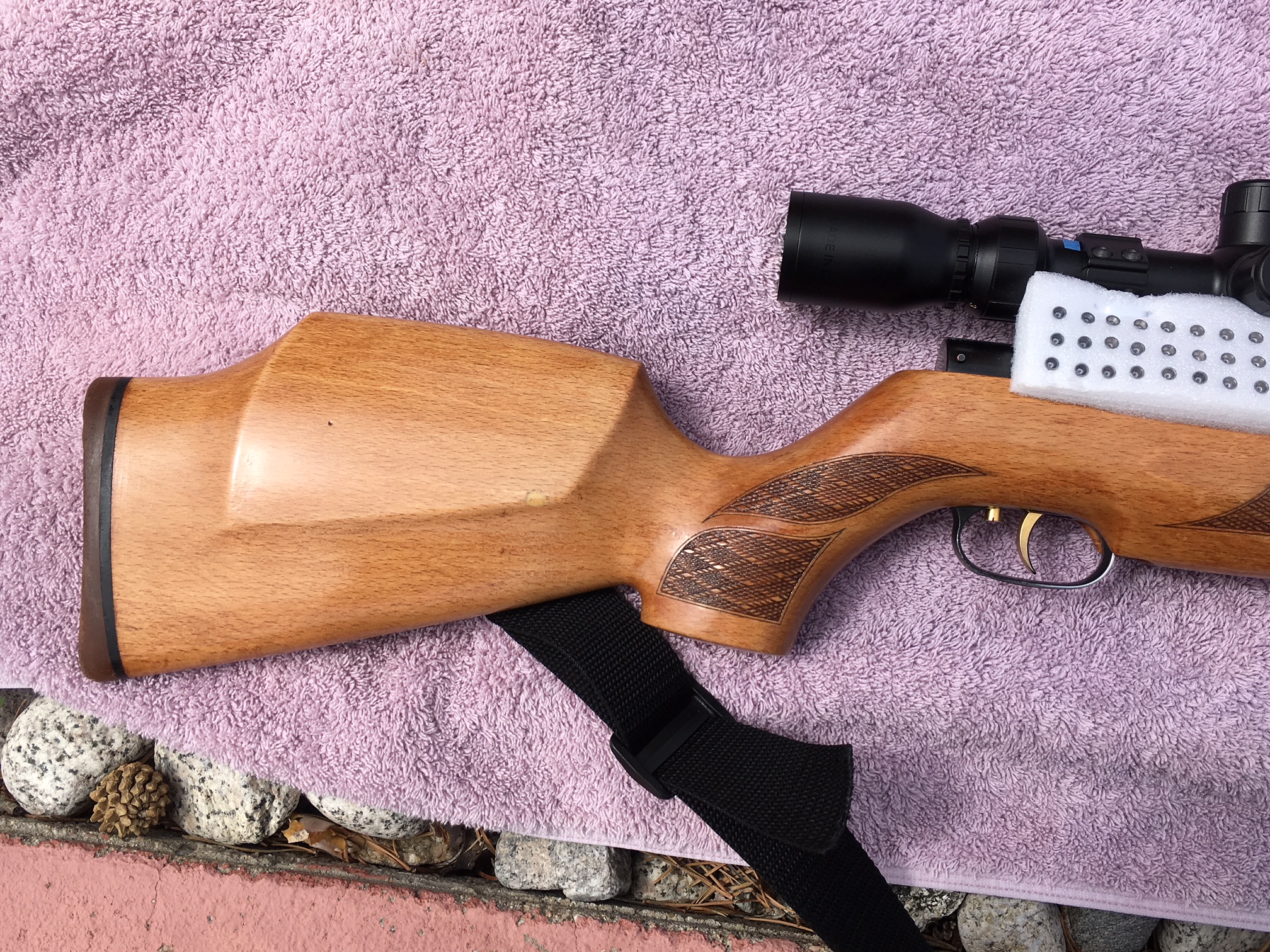

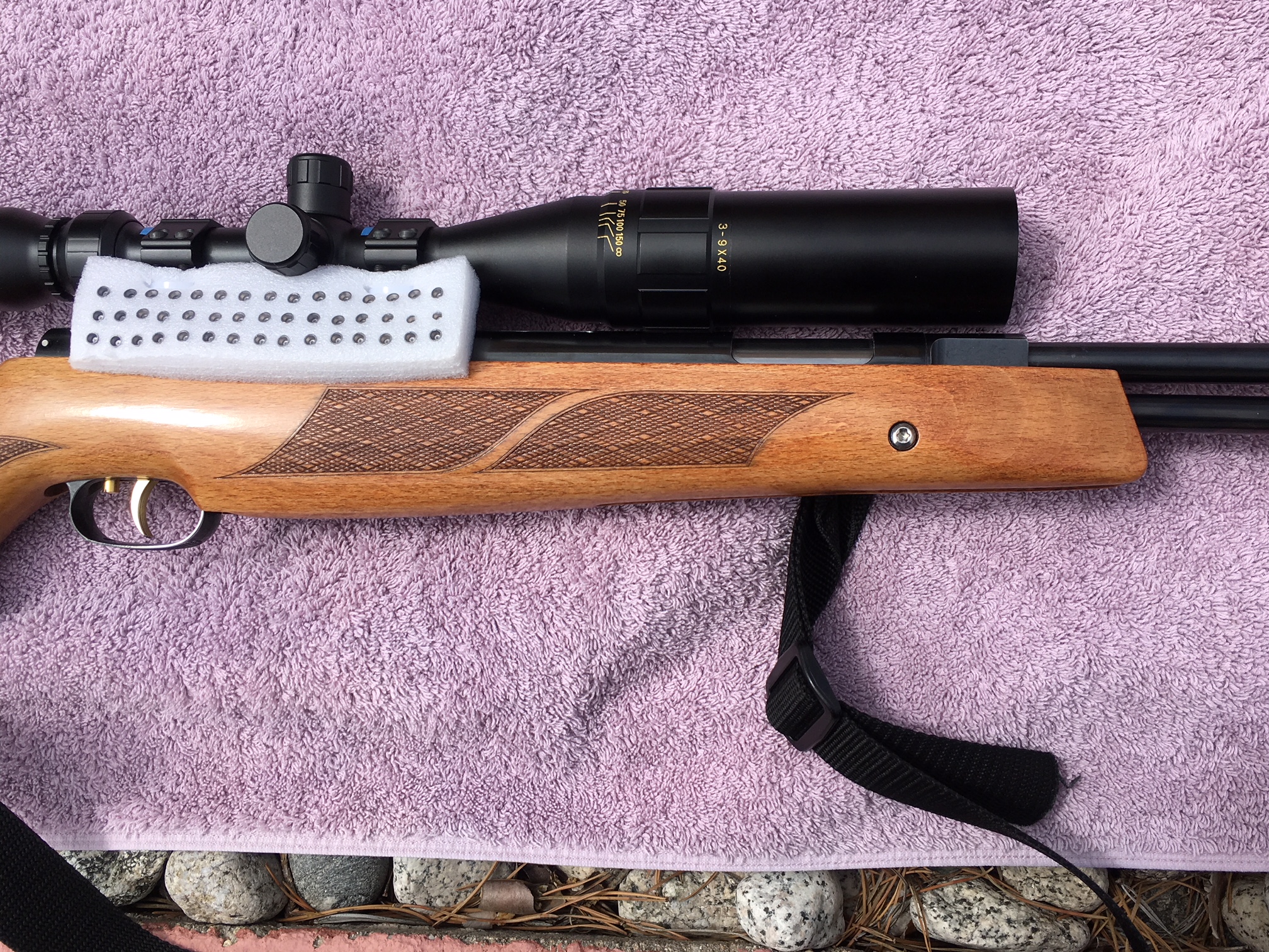

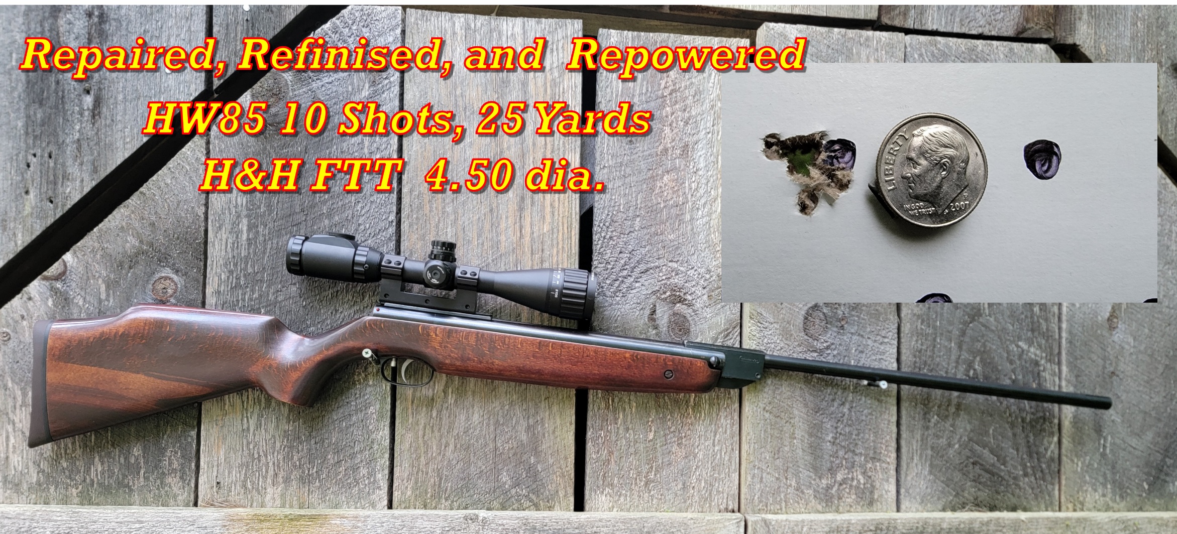

Here's an HW85 that I did recently. I purchased this gun in a lot of two HW85s. This one had a damaged stock and a broken cocking shoe. This in NOT an example of my best work. This was a very rushed, 3 - day job. The stain that I used is a homebrew of various leather dies and pigments. The finish is a half dozen or so hand rubbed coats of Tru OIl ( my finish of choice ). While this is certainly no showpiece, it's considerably better than the way it was when I received it. The stock was dented, scratched and gouged in several places. The cocking shoe had broken and when it did the cocking arm blew right through the bottom of the forend, just behind the cocking slot. Had I spent more time on this job, It would've certainly tuned out better, but I'm quite pleased with it as is. Of interest is the grain pattern on the right side of the butt. It almost looks as though two pieces of wood were joined together in order to make the blank, but this is not the case. It's just the way the grain runs. Strangely however, this was not apparent before stripping the original finish.
Looks good to me, thanks for sharing.

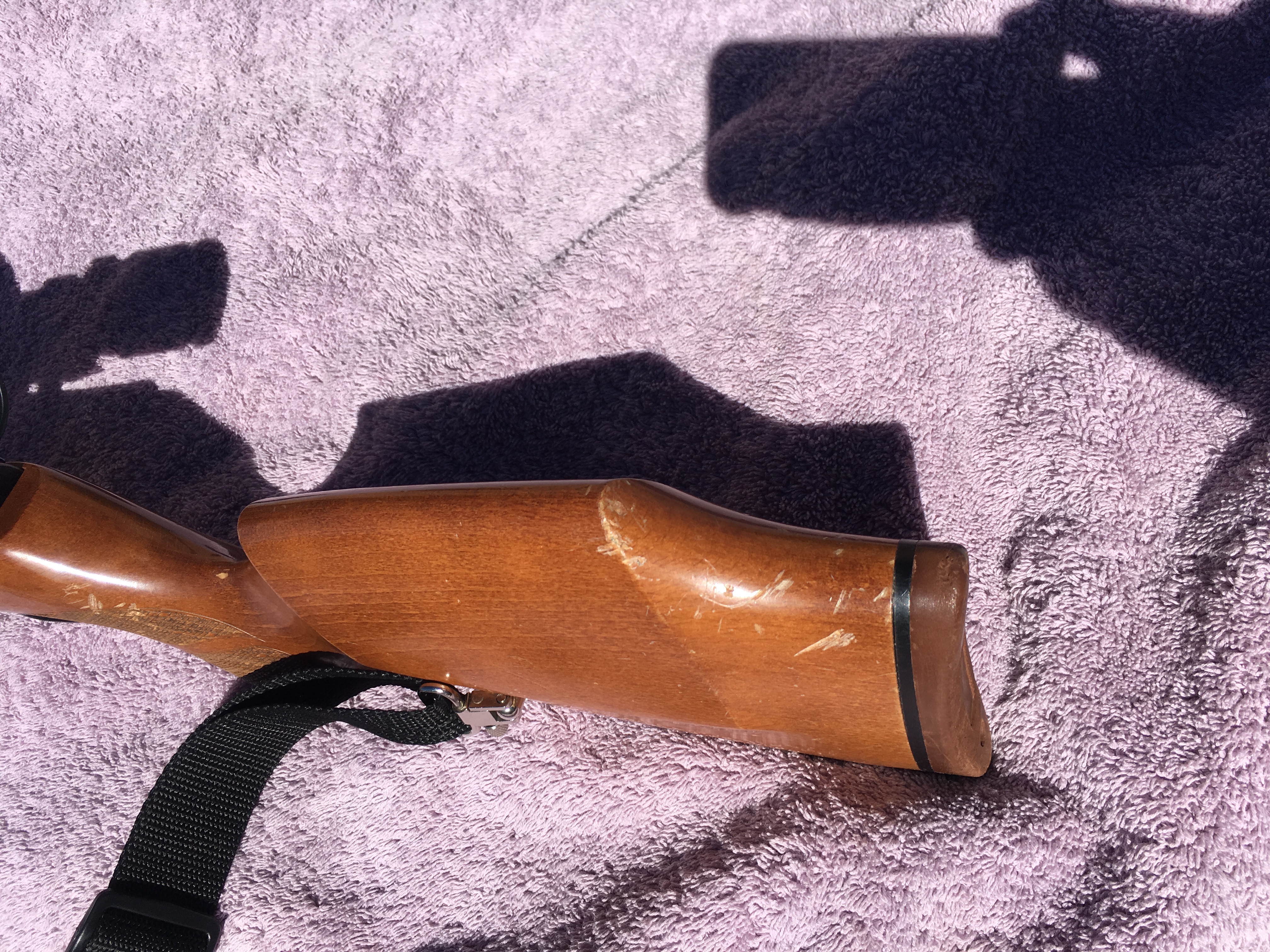

Still haven't decided, but now I have a good idea of what to expect. I like the 97K stock shape and feel, but the finish is lacking..lol. Mine in particular has a think coat of what ever they use,
more so on the fore end than the butt, also fit around the butt pad and the butt sucks.

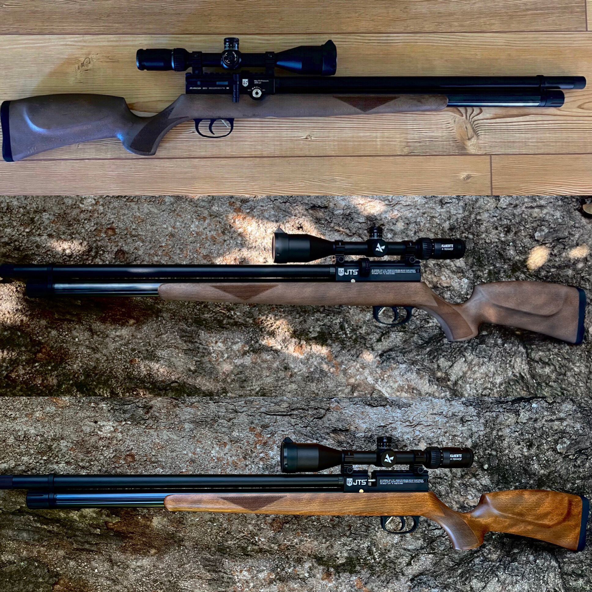

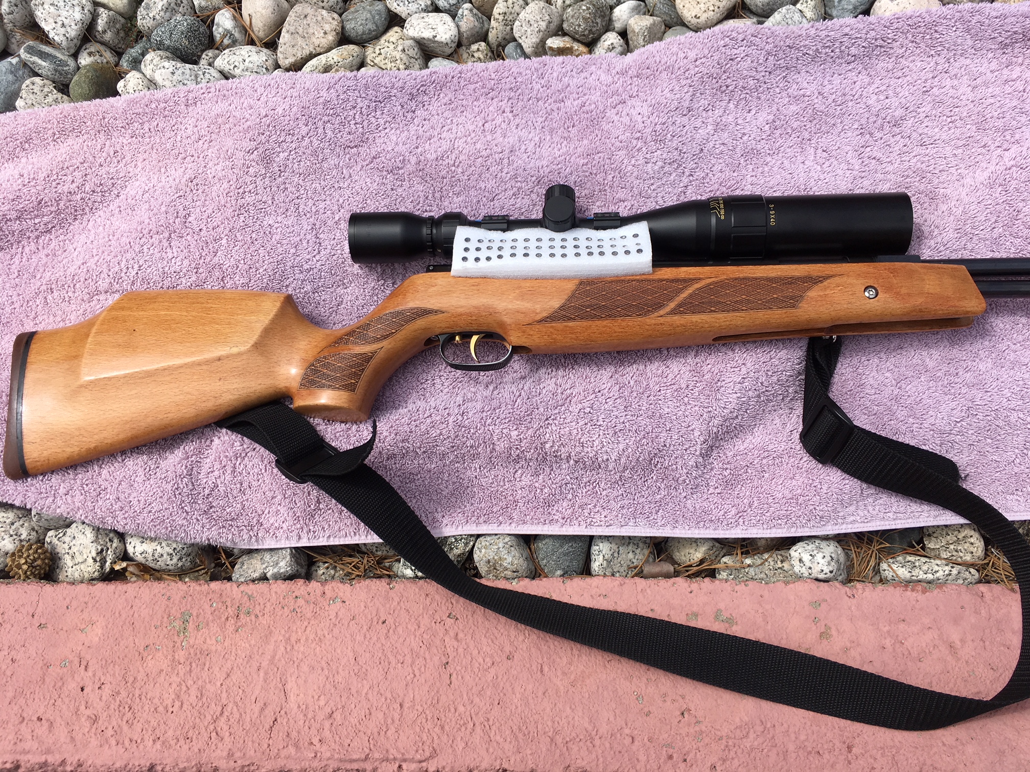

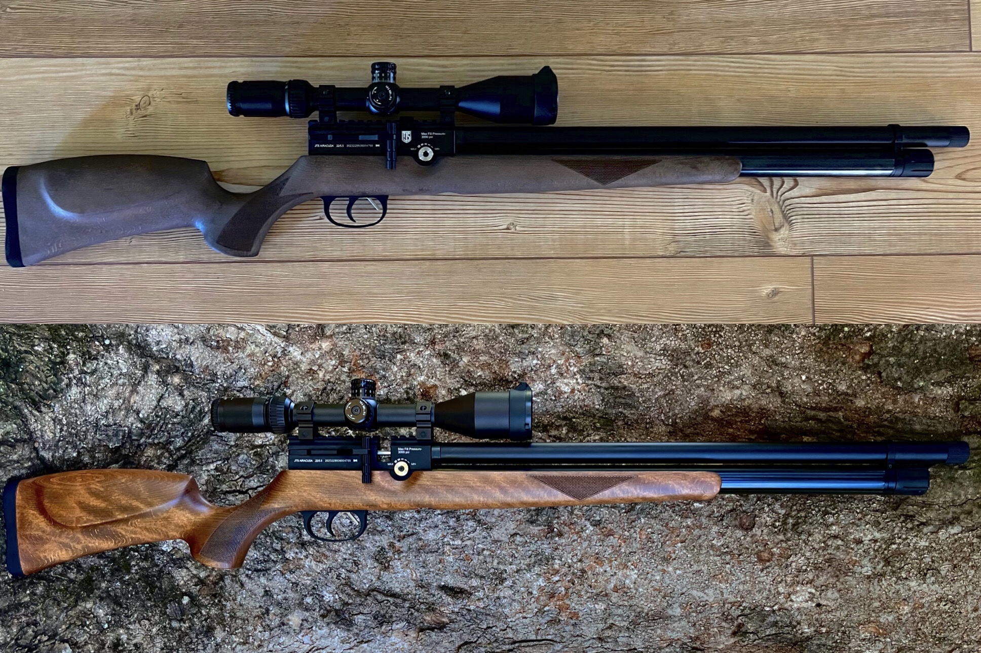

Just purchased a cheap PCP. (Went to the dark side). The ugly Beech stock was as bad as it gets. Cheap dark spray stain. Almost sent it back. But I saw a lot of figure buried under the mud. Started by removing the mud and few hours later.

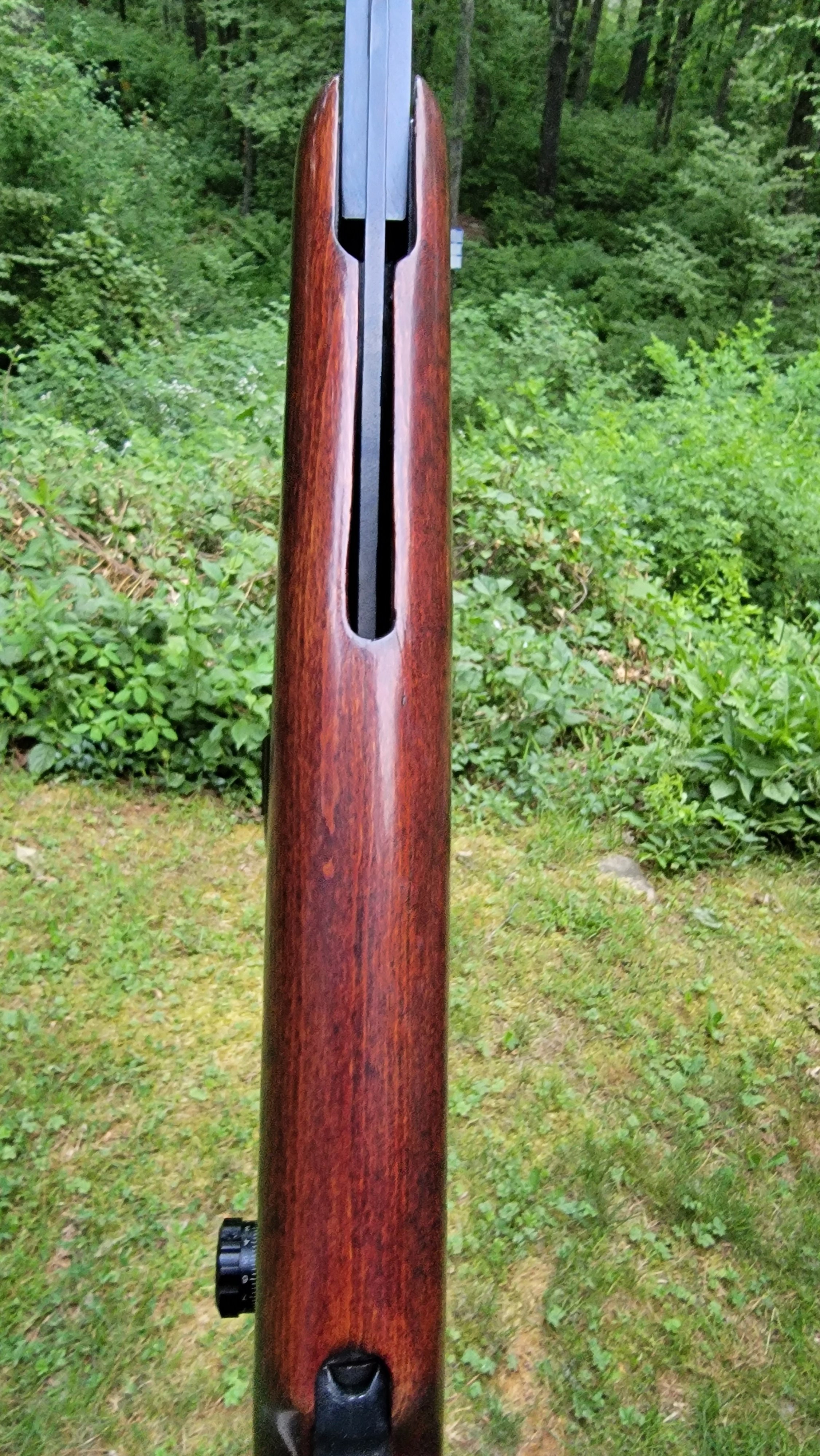

I did one a while ago. Not an easy task. Beech will get very blotchy if you’re not careful. Scroll to the end of this overview to see the process outline.

Just purchased a cheap PCP. (Went to the dark side). The ugly Beech stock was as bad as it gets. Cheap dark spray stain. Almost sent it back. But I saw a lot of figure buried under the mud. Started by removing the mud and few hours later.View attachment 487084
Yeah, that looks way better. Did you stain it or is it a oil? I'll have to overlook the dark side thing..lol.
I did this one as simple as it gets. Striped the dark spray stain. Lacquer thinner to the residue. Rub down the grain lift with synthetic wool. One coat of Minwax “Gun Stock” stain. Two coats of Watco spray lacquer “satin” and the last coat in “matte”. Besides the drying time, about 40 minutes of labor.
Question, if you were to do it again would you add/delete any steps? I'm thinking I may follow your recipe. Did you apply the pre conditioner once on the whole stock or twice?

Just purchased a cheap PCP. (Went to the dark side). The ugly Beech stock was as bad as it gets. Cheap dark spray stain. Almost sent it back. But I saw a lot of figure buried under the mud. Started by removing the mud and few hours later.View attachment 487520
OH WOW! as it happens, I have one just like that mud dweller. Thanks for the instructions! That is remarkable.

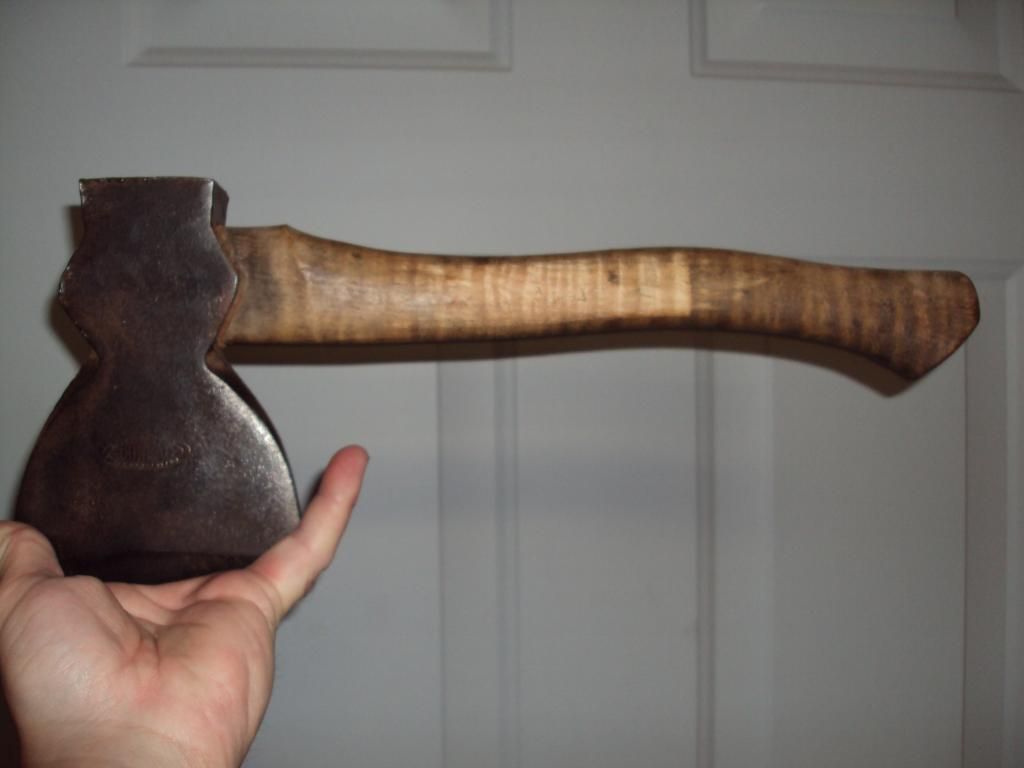

You should have an idea but you never know exactly what your gonna get when you refinish something, @Bear-of-Grayling hit the nail on the head when he said he saw a lot of figure buried. That would be one of the main determining factors for me if I had a rifle in consideration. For my .02 figure is the beauty of the piece.

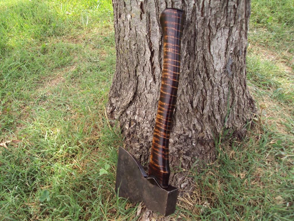

FinishedaxhandleJuly2013012_zpsaa147d83.jpg.cae36c57c1a90bdcb0e8c1741e2ec95e (1).jpg
If you have a stock that has been spray stained, there is a trick to see what is underneath. Take the gun out in natural light but slightly shaded. Like under a tree with the sun coming through. Take pictures with your phone. The camera will pickup the grain under the mud that your eyes can’t see.

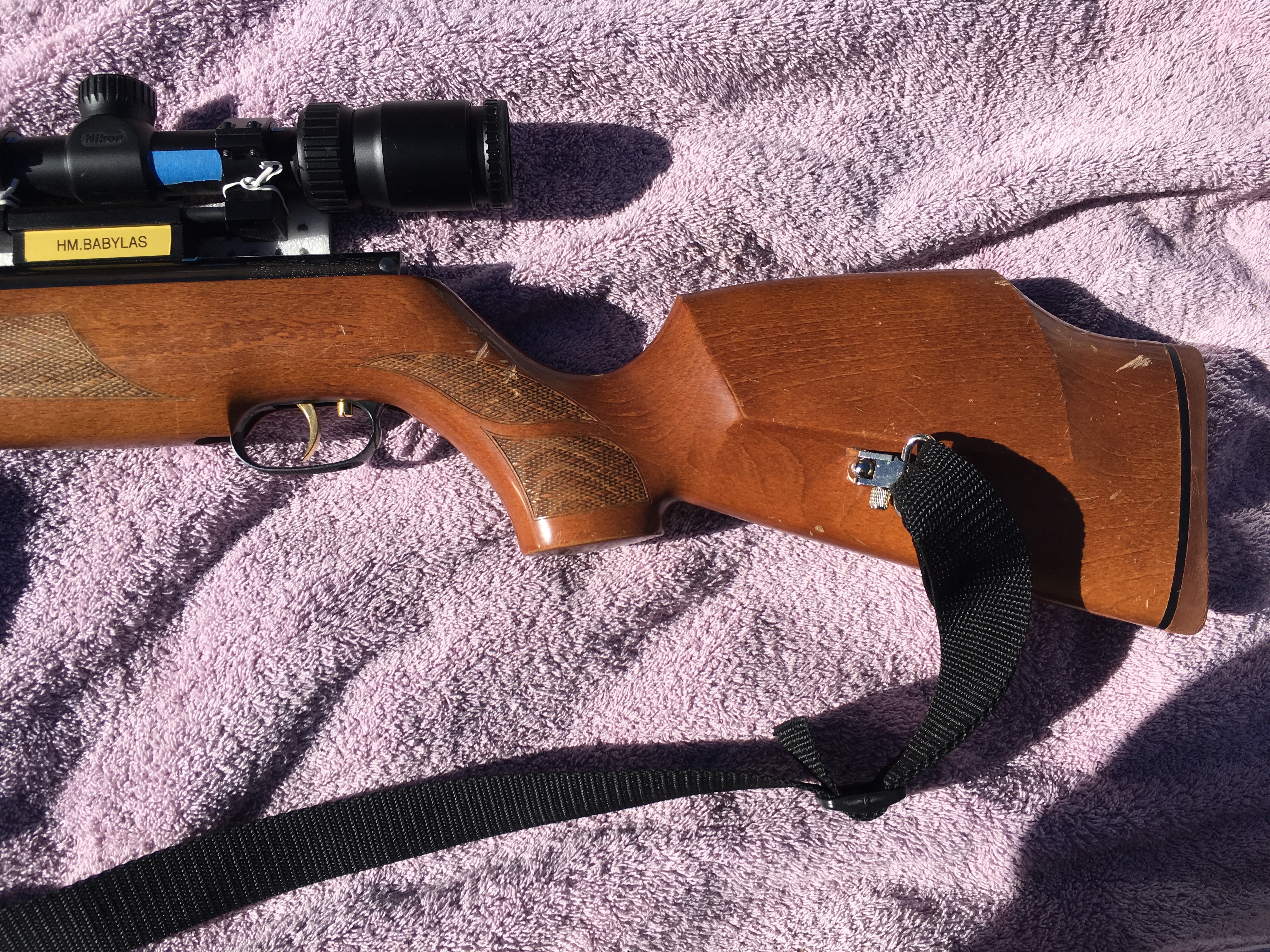

The top picture is taken inside and is what the eye sees. The middle picture (taken immediately after I got it) is taken outside under a tree in bright natural light. The lower one is the finished stock. If you look closely you can see the matching figure in the last two pictures.

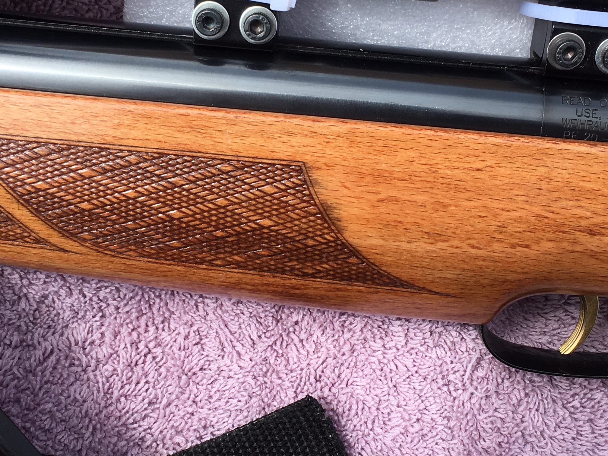

I refinished our HW97K beech stock last winter. It was a bear and a half to strip the finish off of it. It seemed like they sprayed it with a plastic coating. I had to put stripper on it, let it set for a while, and then take a putty knife and literally scrape it off.
After I finished stripping it, I sanded most of the dents out, and filled in the one dent I couldn't sand out. Then I treated the stock with Minwax Wood Hardener, because the beech was just way too soft for my liking.
The directions on the wood hardener said to apply it first, and then any stain or finish I wanted. That may have been a mistake, because it effectively sealed the wood so well the stain I applied simply would not penetrate the wood at all. Most of it came off on its own, so I ended up removing most of it to salvage a bad situation.
Then I put a coat of Birchwood Casey Sealer and Filler on it. Probably not necessary, as it was already well sealed with the wood hardener. Then approximately three coats of Birchwood Casey Tru Oil.
Except for the die Weihrauch put in the checkering to make it stand out more bleeding outside the checkering because of the stripper, and the color being a little off, I think it turned out well enough. It certainly is a great improvement over how it was when I started.
