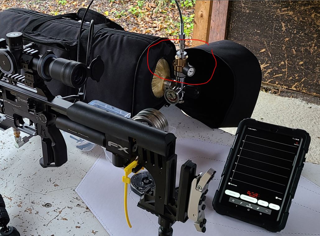

Anyone experience this. Say you set your reg pressure to 140 bar. When the bottle pressure is fill to 250 bar, the reg pressure will be 145 bar. Shoot a couple shot, bottle pressure now at 230-240 bar, reg pressure will be about 143 bar. When bottle pressure gets to 200 bar, reg pressure will be about 140 bar. And keep shooting, bottle pressure now 150 bar, reg pressure will be like 137 bar. I thought the point of the reg is to keep pressure behind the valve to the set pressure until bottle pressure falls below reg pressure. So shouldnt the reg pressure be 140 bar, even when bottle is 250 down to 140 bar?
