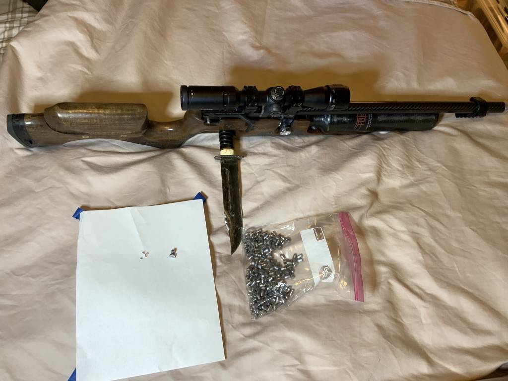

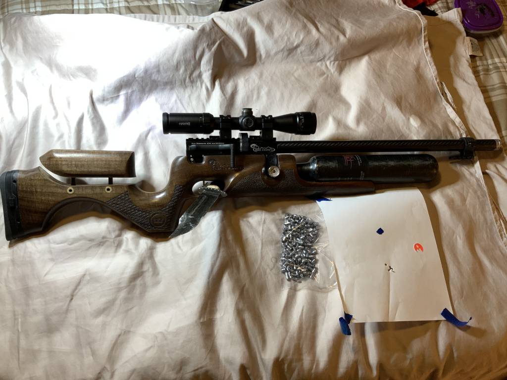

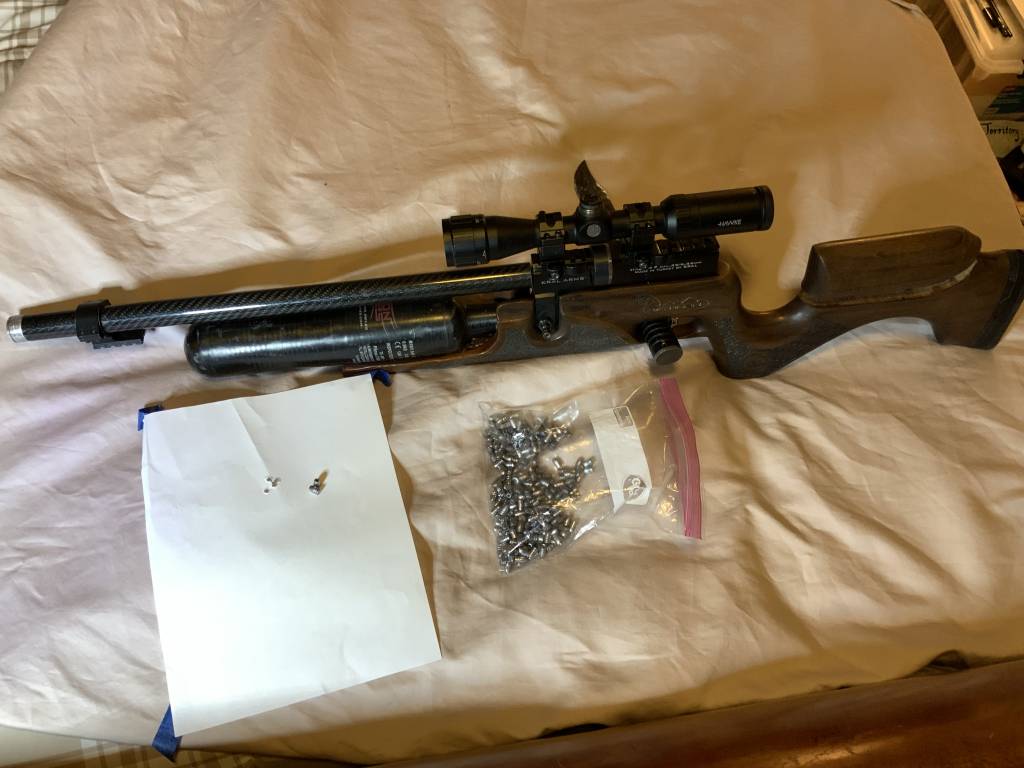

I cut off and replaced that cast bullet mutating choke with a Donny fl threaded 1/2 x20 cap, replaced the metal tensioning tube with carbon fiber, recrowned then polished the barrel interior and crown with #7 polishing compound followed by Flintz until I got tight groups, then reversed the barrel in the vice and hit the first 12 inches with rigorous polish wirh #7 from the lead to mid barrel to obtain a very slight tapered choke with mirror polish. Then I used crayton bulbs to match the driving band on the MPMold and barrels leade. I use sized bullets for gauges, only one use per bullet, until I get bullet lead fit resembling the fit of a cork in a wine bottle.
By now you realize this is not my first cast bullet conversion, I found this choke amputated 21 inch barrel to be the most consistent barrel I have polished, Troy hand picked it for me and used my home cast .252 bullets to test the .251 groove diameter which IS the correct way to set up a cast bullet barrel for a specific bullet. It works far better than guessing, then selling those inaccurate cast bullets that are a one size fits all attempts.
Then I added a Talontunes 3625 psi tank to put the rifle on a diet, glass bedded the tank to the hogged out forend. Then I used alcohol with 000 Steel wool to thin out the stain and reveal the lovely Turkish walnut grain.
I put 5 coats of Trueoil and then hand rubbed #7 and like the metal finished with Flintz.
The result is a lovely satin finished walnut stocked rifle with superb accuracy and handling characteristics.
I also used a 1 inch picanitty scope rail to the cf barrel shroud to give one shot sight ins once a laser is added. The rifle being a light weight weapon wears a unlighted Hawke 2x7 scope in lever rings.

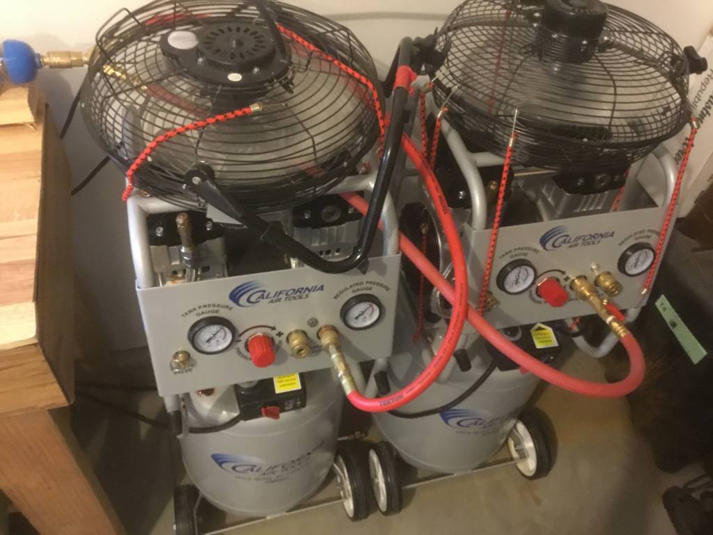

M home designed air compressor system using two CAT Shop compressors, to run a Altaros booster fills my 30 minute tank every week, and has for a year now, so ammo cost are Penni’s as is propellente.
