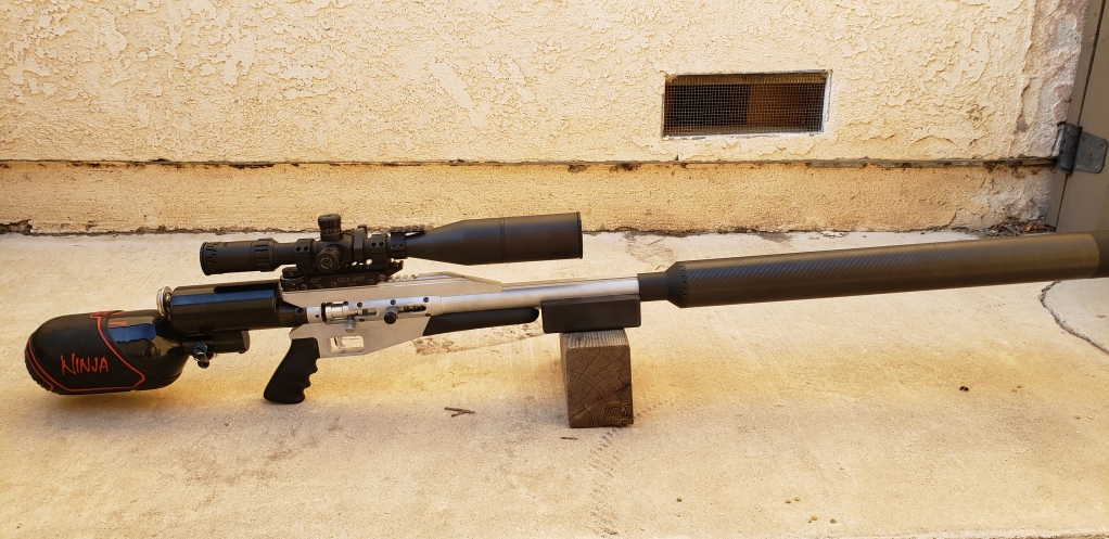

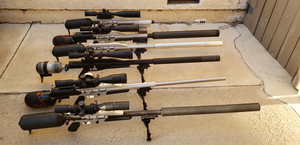

OK, Doug said I could post a pic of some of the regulated rifles he's built.
Note some of these are custom actions, and the calibers range from .257 to .457
this is a .338 in the white below.
These are VERY accurate rifles, like 1/2 MOA average at 400, frequently better.
Doug is a MASTER airsmith and shooter!
Do note that he's not selling these so don't tidal wave him with requests. Maybe someday we'll see something on the market but now he's experimenting and developing.
I hope someday to be able to order a 7mm if he ever goes into production......
I like the 1 liter tank pic, great idea! Not sure why the cocking lever and hammer push back knob, can you explain?
