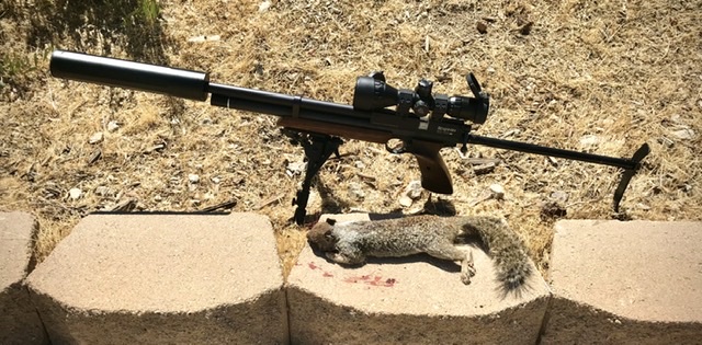

I have a prod and a 1720T both without regs but tuned with the bstay(sp?) method. The 1720 is around 12 ftlb and the prod is about 6 ftlb. Both are consistent and accurate.
The prod is about as quite as you can get a pcp and with in the 50 yards of my backyard is great at pesting. I actually just got a ground squirrel with it yesterday afternoon at 40 yards.

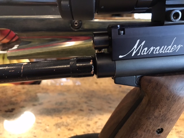

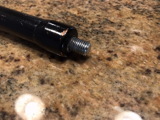

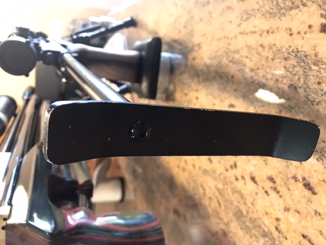

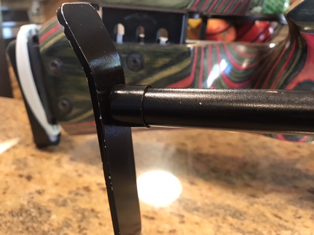

@wildcj5 did you buy or make your but stock? Is it an aluminum tube? I thought about making one out of steel conduit but wonder if I would be wasting time. It may be too heavy.
I am with @raden I would love to have a 1720 multi shot.
I made it. The plate it aluminum, the pipe and end fittings are brass.
The part that threads to the pistol is a brass end cap with a hole in it and a bolt. Put together with jbweld. I forget what length bolt but if it’s too long it will bottom out on the pistol.
The butt end is another cap drilled with a nut held in also with jbweld. The nut is three times the length of a regular nut. Not sure what they are called but they sell them at Lowe’s or hd in the hardware section.
The butt plate is just aluminum attached to the rod with an Allen bolt.
