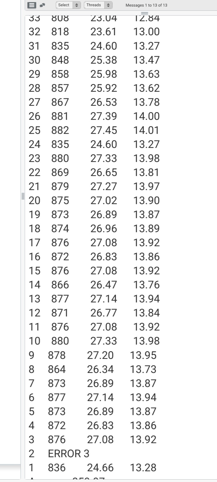

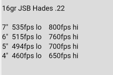

what’s up everyone!
does anyone have a link or information about the maximum fpe attainable with a regulated airgun and an 11.5” barrel sending .22 cal at 14.3-25 grain? this is with all relevant ports expanded for transfer of air. im expecting there’s a plateau for each given pellet before i went searching for it, i was hoping someone here knows or can point me in the right direction.
is all the information i need found in regulator valve dwell time at different pressure set points?
