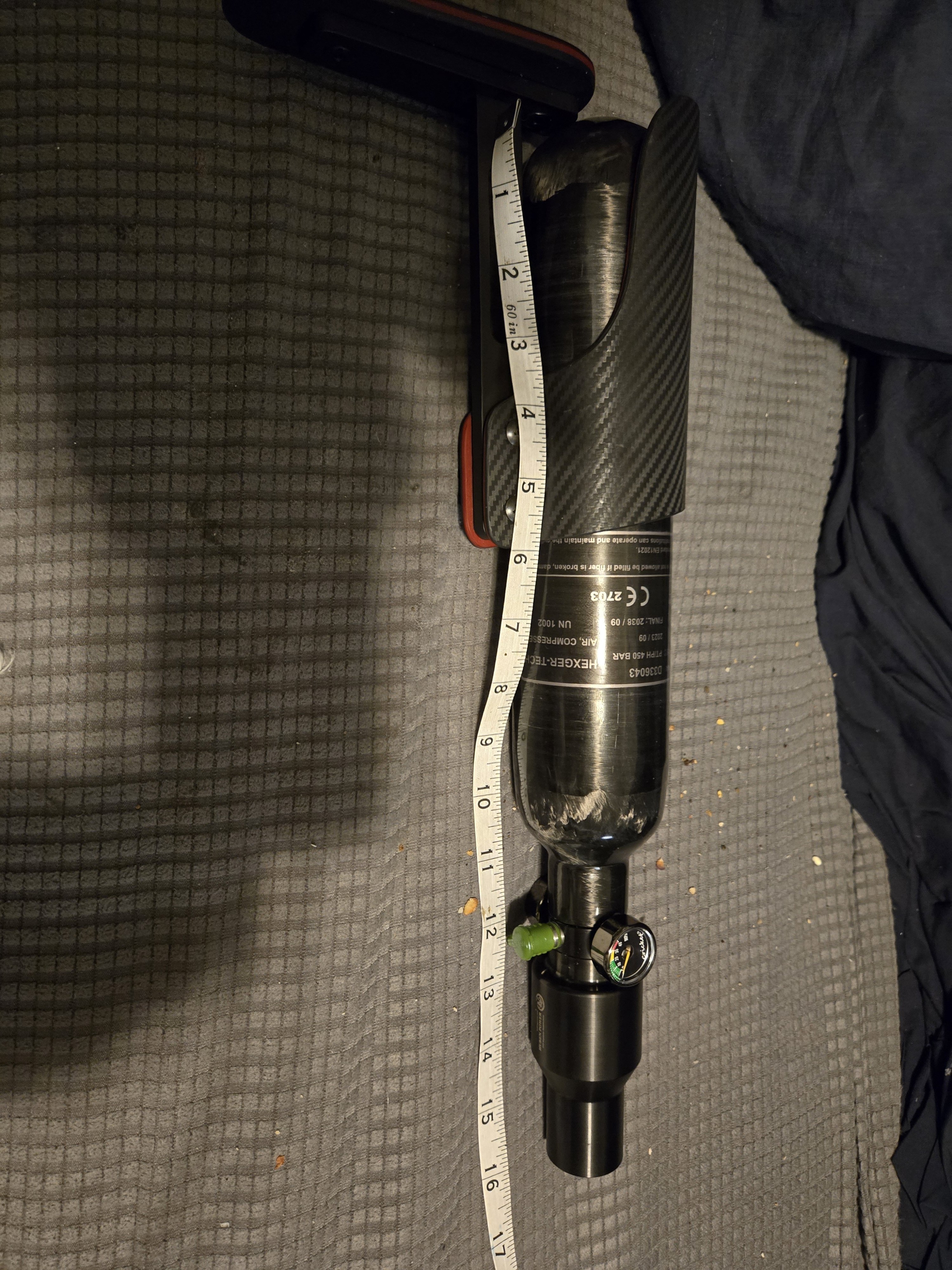

How much does the regulator add to the length of pull? I'm already measuring about 14.5" from the trigger to the bottle's "butt"
Cricket Max-ATH is 5"
With a 500cc bottle it is 16"
