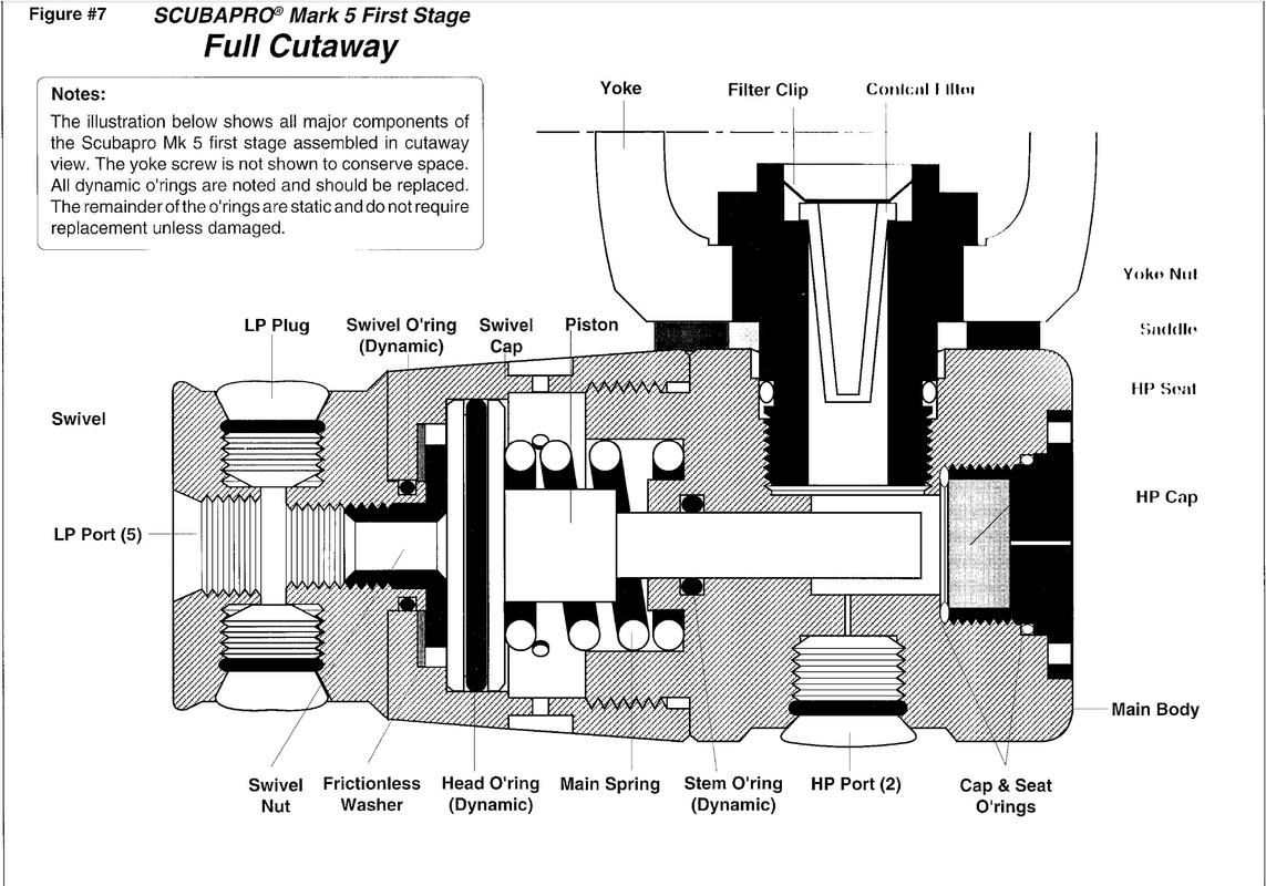

SCUBA regulators in two stages go from 3000 (or more psi) to ambient in two stages and yet last many years and many breaths without creep of intermediate pressure. This old Scubapro first stage has been reducing pressure from tank pressure to an IP of 130+/- for a decade without service over hundreds of dives. I decided to service it for good measure:
A Scubapro Mark 2 unbalanced first stage really has no service interval but that required by lawyers:
Reactions: rcs9250
