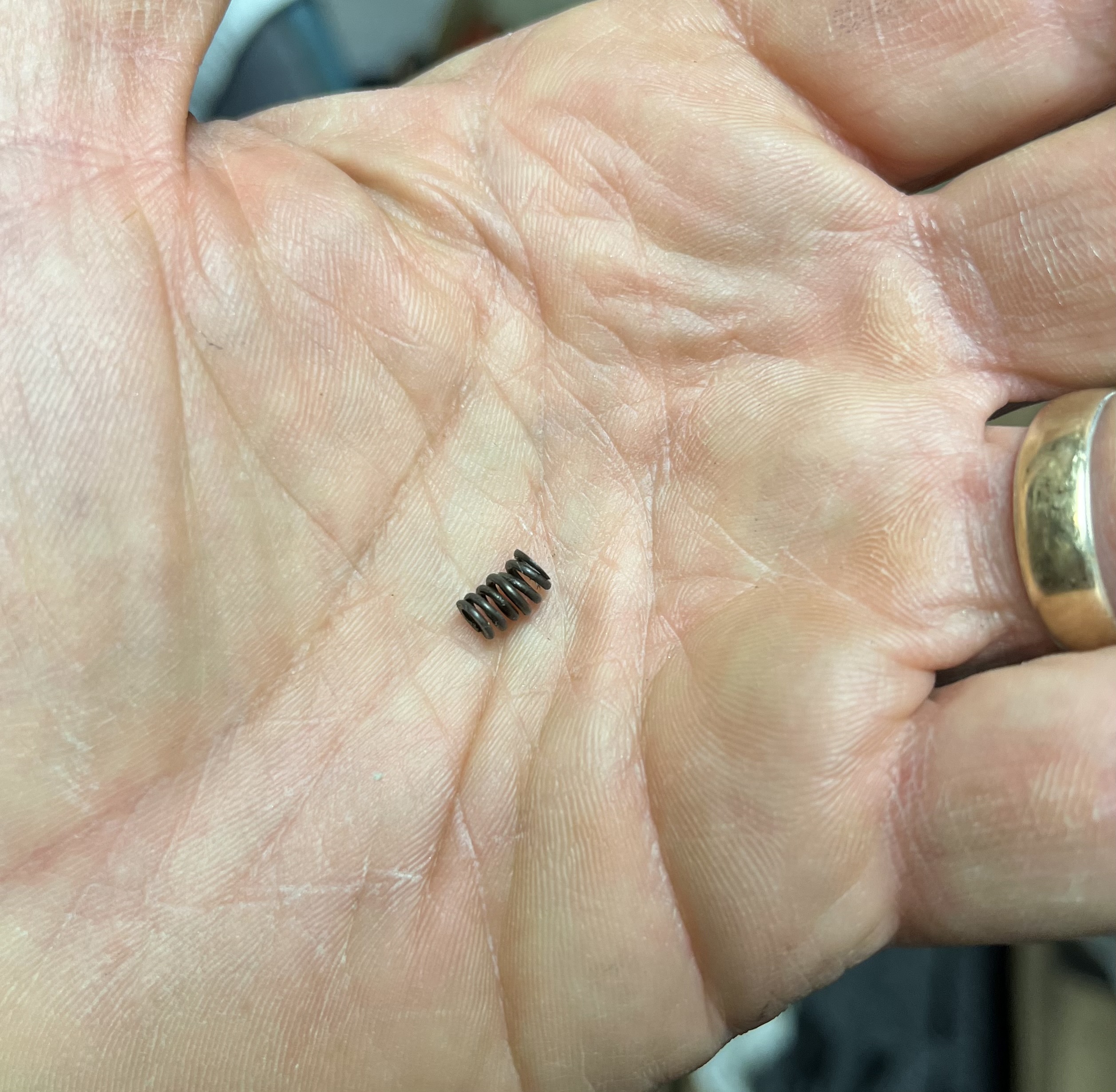

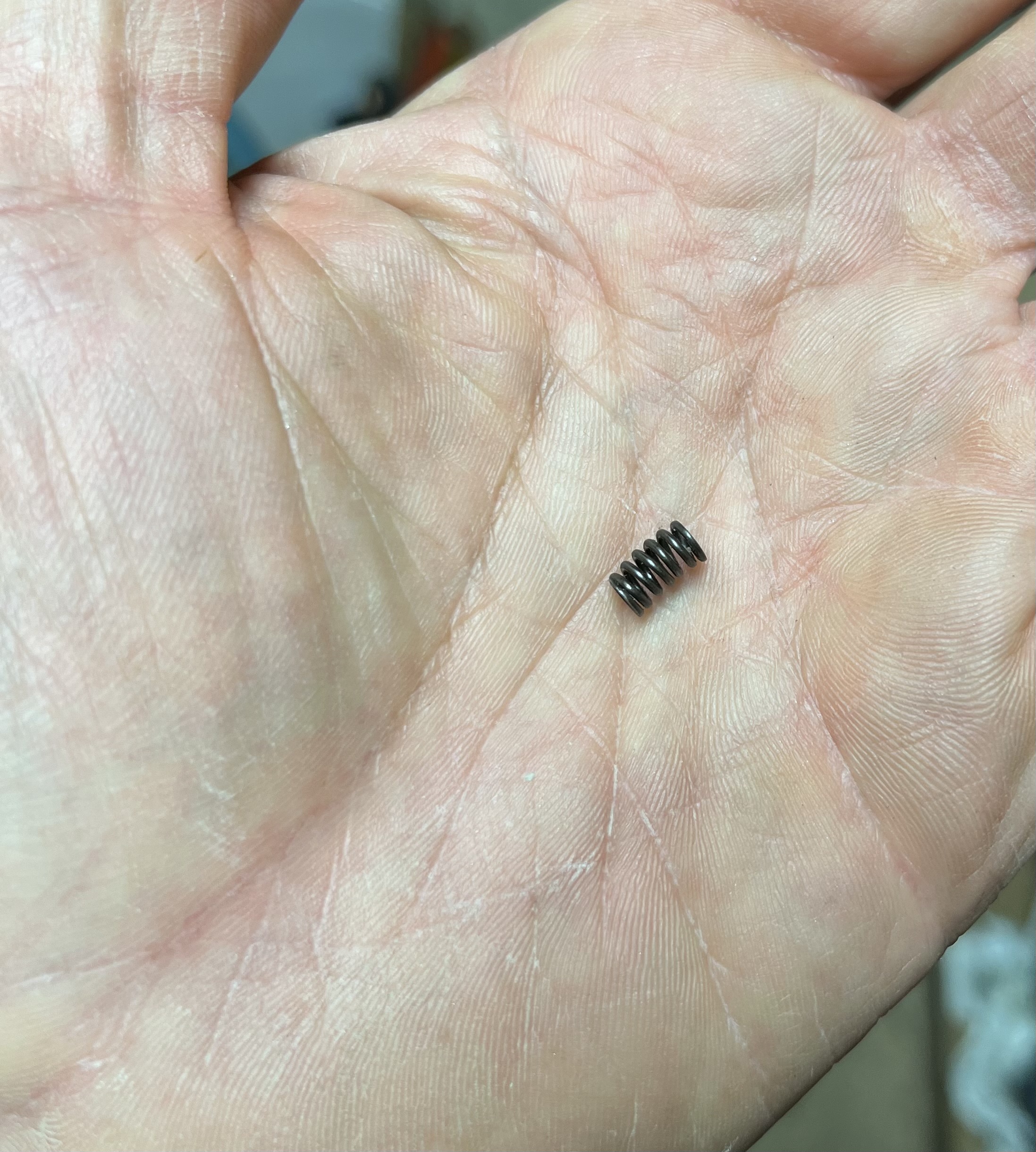

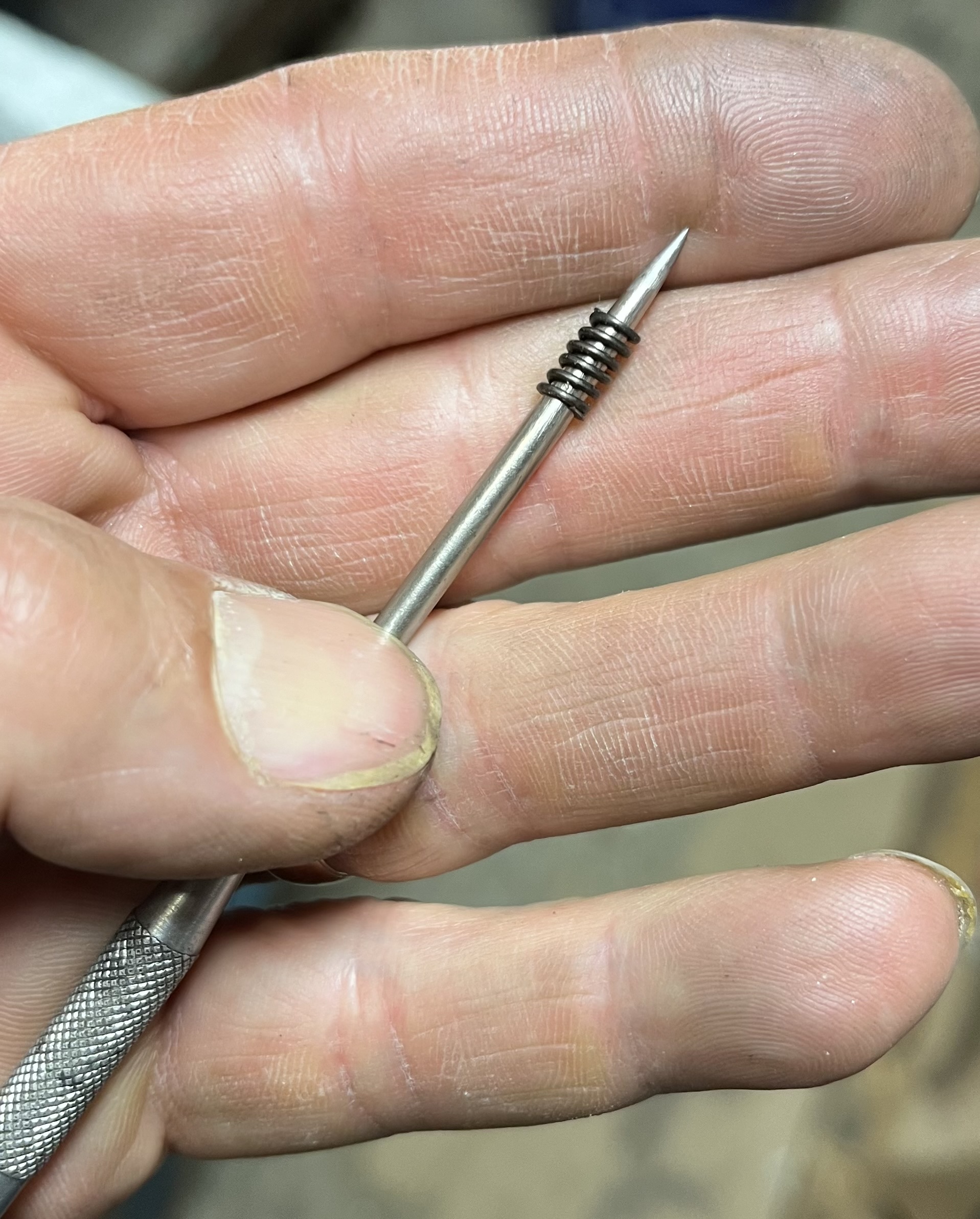

I’ve seen 2 or more trigger tension springs smashed flat. I had to straighten this one until I was able to replace it. Stretched it back out and then slid it over a scribe so I could peen it in shape to be usable temporarily.
Be certain you “Understand what you know” before you monkey with your trigger. 👍

View attachment 531827View attachment 531826View attachment 531825
FYI that's the same exact spring Weihrauch uses to tension the nylon glide on the modern Hw50s (Hw99). I have extras because I remove them from every 50 I tune.
