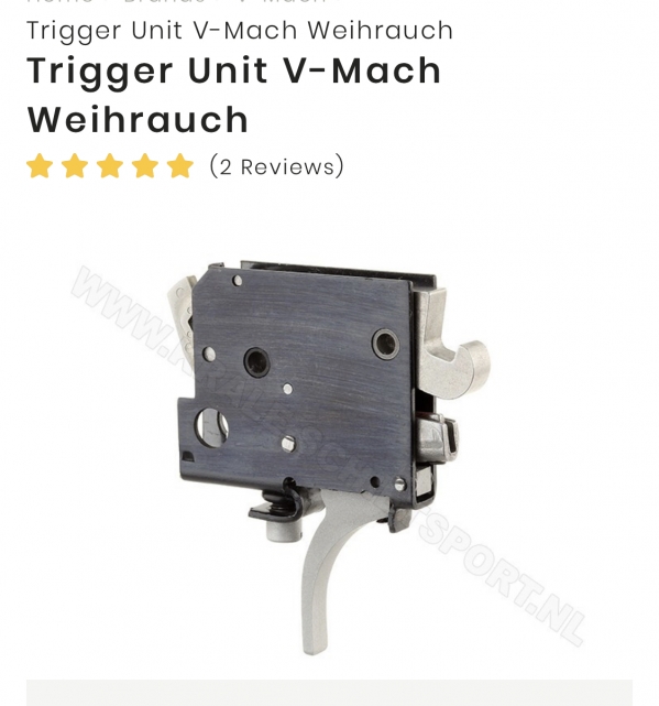

The biggest flaw to the Rekord as far as pull weight goes, is the trigger is positioned too far back in the housing for best leverage against the sear bar that the trigger blade works against. Simply moving the trigger blade forward in the housing makes a HUGE difference. I have one that I modified and made to work like this, but never got around to finishing it well enough to go into a gun.
V-Mach used to offer a modified Rekord for a short time, and to my surprise there's was just the same idea. By the time I saw them they were unavailable. Notice how the trigger has been moved forward, you can still see the original pivot point where the trigger pin was.
