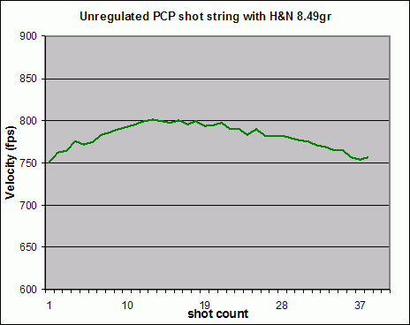

Whereas with an unregulated PCP the pressure is progressively falling with each shot. However much hammer spring tension I have it set to will give me some kind of velocity bell curve. For some number of shots the velocity will be gradually increasing, until eventually it peaks and then begins tapering off. Just an example:
If I increase the hammer spring tension, I make it harder to cock (at least in some measure), but also two things happen together. The center of the bell curve moves up to a higher pressure, and the peak velocity grows higher. Maybe that’s exactly what I wanted and I’m happy with the result. Or maybe it pushed the useful part of the bell curve out beyond the safe fill pressure for the rifle. That’s about the simplest scenario for which one might adjust hammer spring tension, and hammer spring tension alone, on an unregulated PCP. But often times it will be part of a more meticulous set of adjustments that include things like porting, hammer stroke (travel), etc. Just a deeper rabbit hole to go down.
