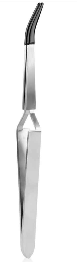

I don’t like the idea of loading underlevers, even when holding the lever tightly. I tried some reverse tweezers to load and it was actually pretty easy. Need to get some with a rubber tip. Will report how it goes.
