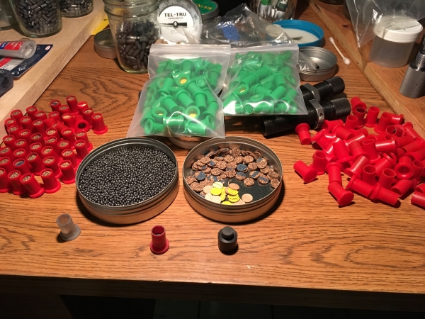

If it's anything like a Trapmaster 1100 CO2 shotgun it is very important to have
the correct clearance at the but end of the shell to make sure you have a good
seal on the shell to the gun see the black piece of derlin that has a top hat look
to it this is used to set the 1/16th thick cork and then I use number 7.5 shot we
have found this gives the best and most even spread . I'm loading these for a friend .
