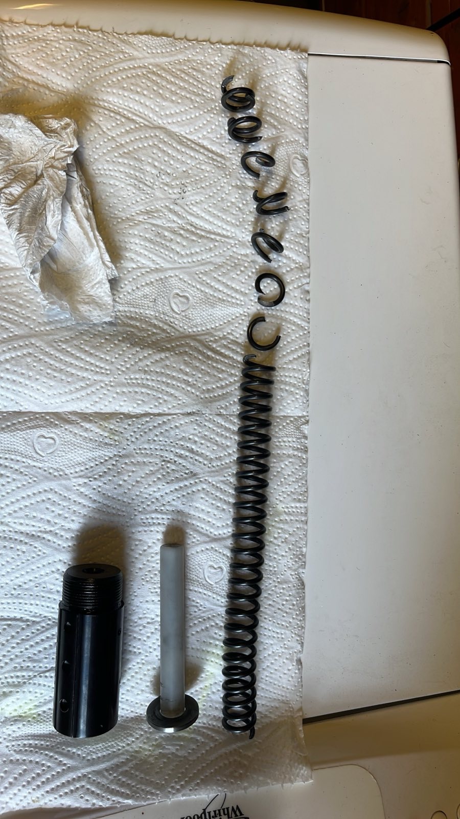

Absolutely shattered after 3k pellets, from my HW77.

The factory springs in both my HW95s broke. One of them broke with less than 3k pellets through the rifle.
Ive heard similar stories from other shooters as well. The factory HW springs don't seem to hold up well. The piston seals are nothing to brag about either. I put ARH springs in both my guns.

My factory 97K spring broke at 2K shots, it still shot ok, but cocking wasn't right. Mine only broke near the end in two pieces. Also broke a Hornet spring on the top hat end, maybe 5K shots I really don't remember. Currently running an old JM QX 4600 with thousands of shots and still going strong. Factory springs are brittle.
What kind of velocity were you actually getting with that bad boi when you finally decided to tear it down to take a look?
Can’t say for sure. I only have 20m range for most shooting and no chronograph.
That said, the ballistics app predicted about 575fps when I ordered the Vortek kit. I suspect more coils broke between then and now.

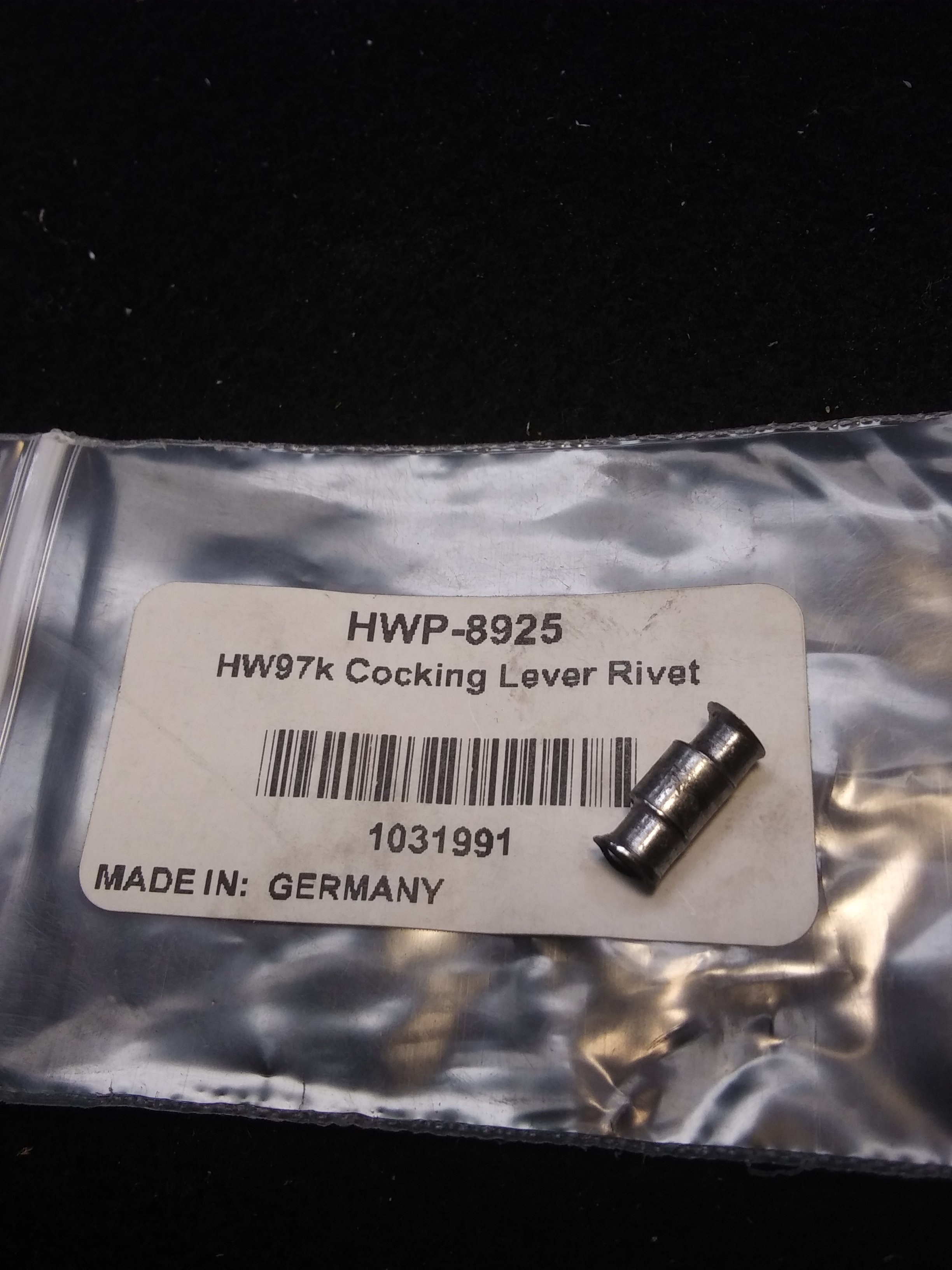

Same for me. The pivot pin linking the cocking handle to the cocking arm was worn. It gave it just enough slack to shorten the cocking stroke. At first the safety would not engage. As it got worse it wouldn't engage the trigger.
There was slack at the other end of the stroke too. When fully closed you could push the compression tube back and forth a little. There was no compression at the breech seal when cocked.
That linkage is important at both ends of the stroke. When things get a little slack all sorts of problems arise. A new $5 pin is all it takes to fix them unless the bore in the cocking lever is swallowed out. Then you are replacing the entire cocking mechanism to get things to sync up properly.
