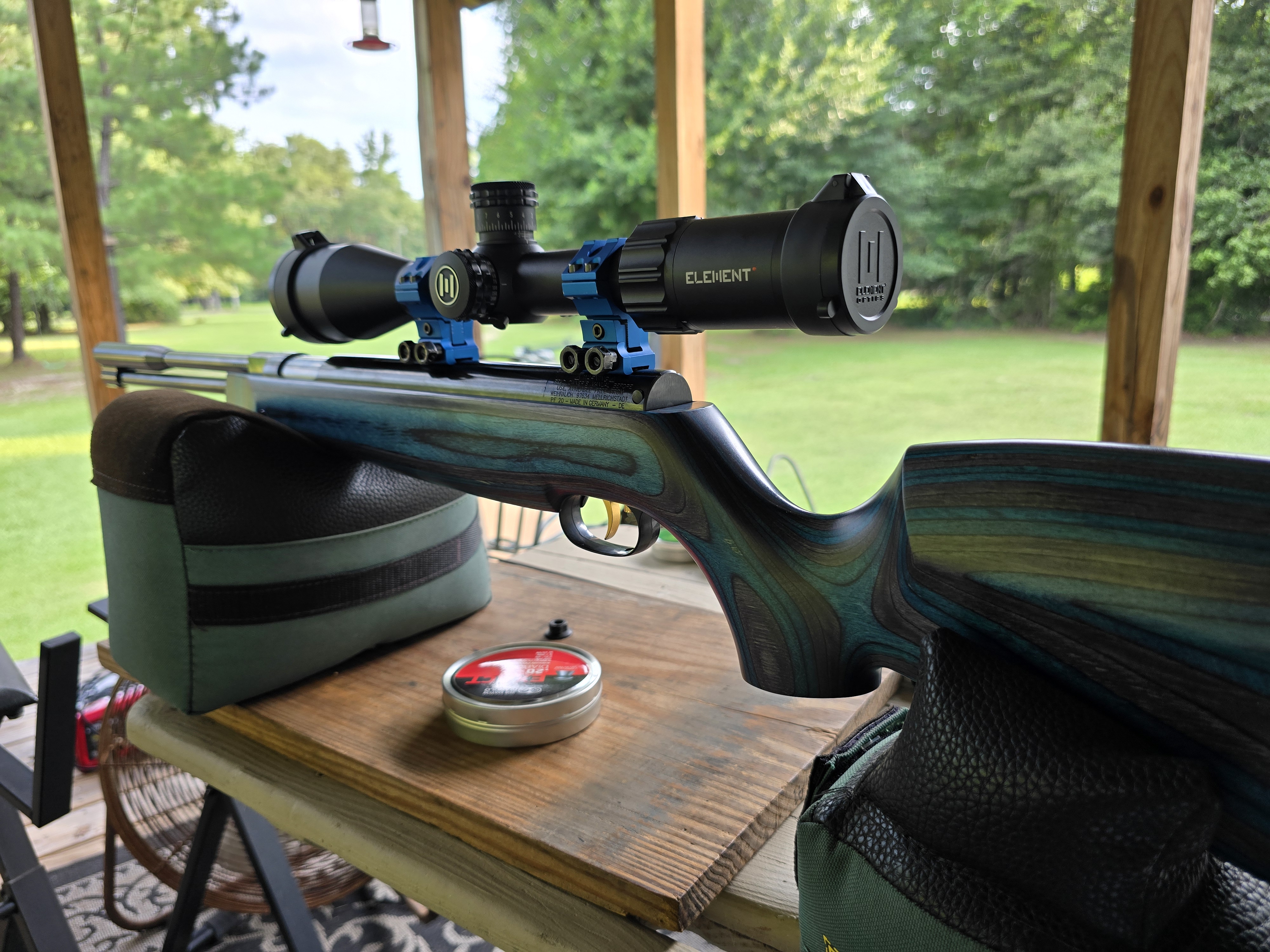

My 97k went back under warranty for not latching, but they never told me what failed. They would only tell me the work they did. I had a Vortek kit installed, and trigger work done. I only paid for the kit, they covered shipping both ways.
At the same time that the 97k was having latching problems it often latched without the safety engaged.
Often times when the safety doesn't latch it's because the cocking wasn't bottomed out when pulling down. You should be able to give a good pull at the bottom and pop out the safety. I've never had a problem with loose pins or wallowed out pin holes, but I guess this could be an issue with the safety as well.

It bothered me that AoA wouldn't say what failed. The gun got harder to latch as I got into my 7th tin, or 3000+ rounds. The last time I shot it I made four unsuccessful latch attempts, and thought, yup that's definitely not right. and shipped it back. I also complained about a creepy second stage on the trigger, and consistant dieseling.
The turnaround was pretty quick. I got a notice of the rifle shipping back but no correspondence. So I called them and they could only tell me that they installed a vortek kit, and cleaned up the trigger.
The rifle is still dieseling so far, but is substantially improved in every area but weight. Lol
AoA is prompt, and does nice work. I would have appreciated better communication, in the end.
I got the notice that my gun was ready from UPS.

My 97 still has the factory spring. It was fitted with a spring guide and top hat by Motorhead when it was new. I had other friends buy 97s at the same time that had broken springs within a couple months. I think a tight spring guide dampens the vibrations and makes the spring last much longer. I was just checking, and It looks like I bought in in the fall of 2016.
